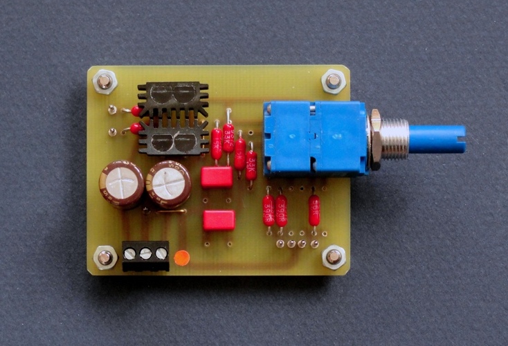

I recently wired up a B1 (point to point, mostly components from the article on passdiy) and put it into my system for a quick test. Sounds great to me! Before I stick it into a case I wanted to run some tests - I have a software signal generator and an old oscilliscope at my disposal.
I am just wondering what to use as the load across the output of the B1 when I test? In the article when talking about roll-off a 10k load and a 47k load is mentioned so I am guessing a 10k resistor across the output would be a reasonable load to compare input and output on the oscilloscope?
Any advice is appreciated.

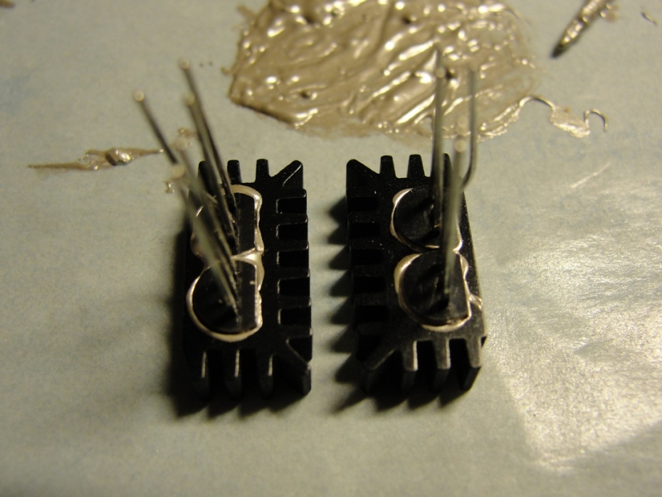

Following our Dual JFET heatsink for diff pair applications :
http://www.diyaudio.com/forums/group-buys/135359-toshiba-dual-jfet-heatsink.html
We made two further variants for our own dual-rail, B1-type buffer for use in a line-level, variable BSC filter. This allows 2x 2SK170 (or any TO92 device like 2SK369, 2SJ74, .....) to be mounted side by side, so that the source of one is next to the drain of the other, as in the schematics. The two versions have the JFETs mirrored relative to the heatsinks, to allow for layout flexibility.
The photo on the right shows the gluing process with Arctic Silver.
Patrick
