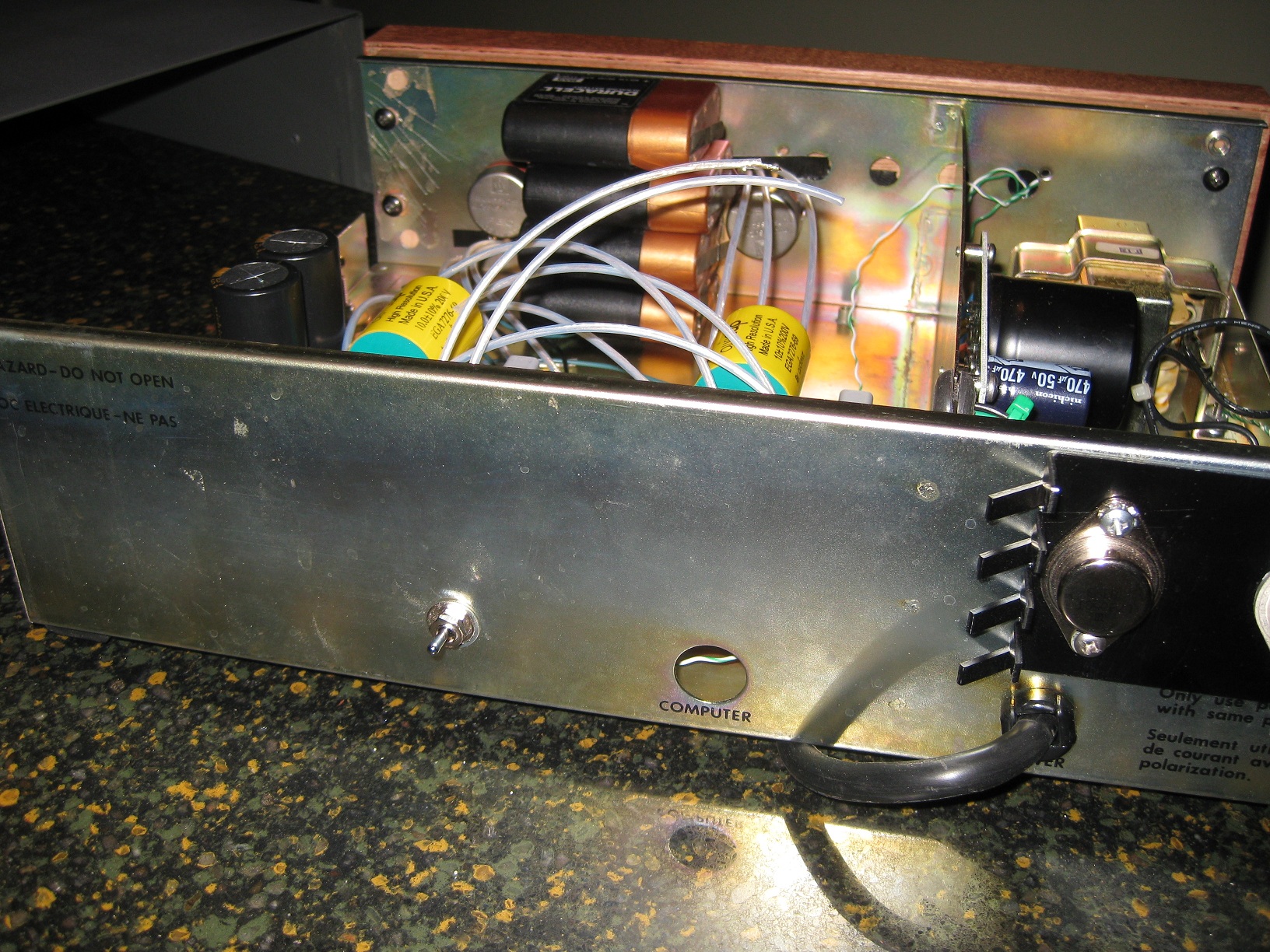

I did it by putting a DTDP switch on the back... one side of the switch has the regular 18 volts and the other side has the battery leads. I also installed a small led that lights when the battery is on; reminds me to turn off the battery. I plan to use 4 x 4.5 volt batts, see picture...

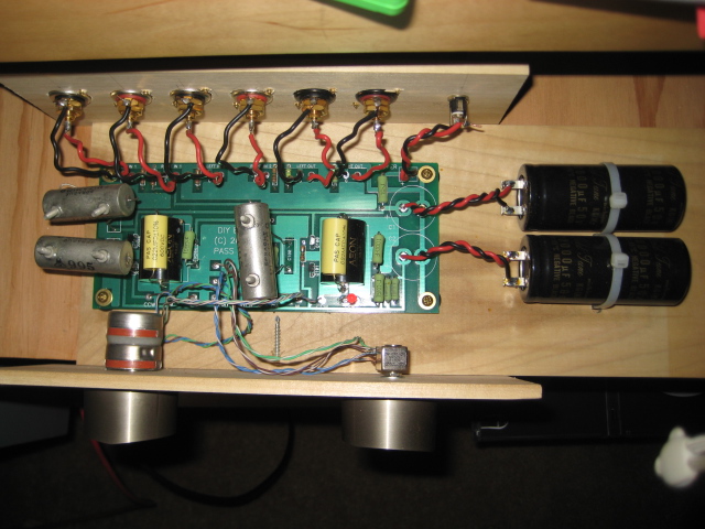

Wood is good! Those are some gnarly looking caps though... kinda your Frankenstein variety. They look like some military experiment gone bad.
Chris...

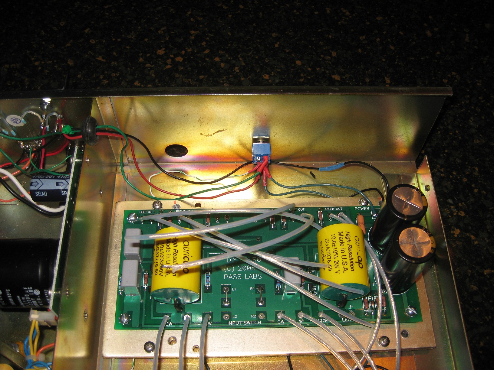

They are vitamin q's and are much better sounding than the stock Vishay's. I think the screws on the top made it so that they were solder-less field replacements.
