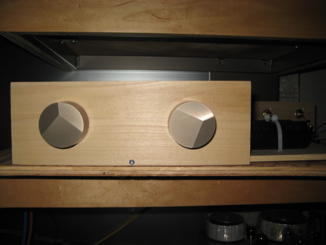

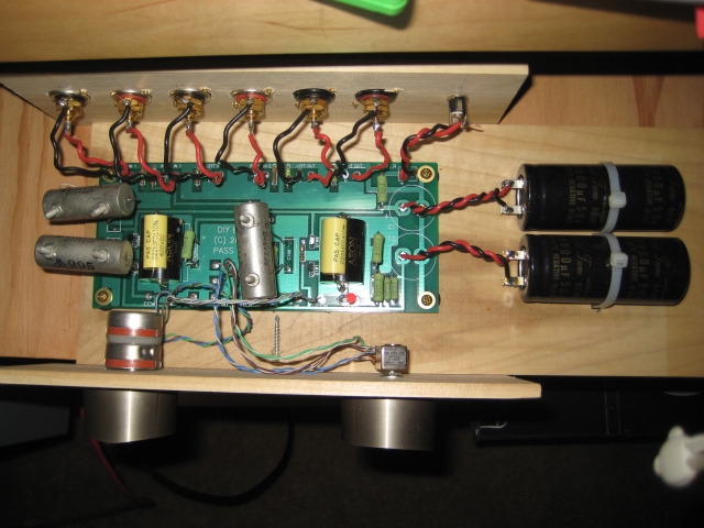

inside and outside...old Threshold pre knobs courtesy of Papa. Volume on the left and a 3 position DPDT switch on the right.
i LOVE thoose knobs ! When i saw that knobs i felt like a little child. It just ascaped my imagination.
Joined 2002
Very nice, what are you using for a power source ?
wall wart or batteries. batteries are better.
thanks Joaquim. Maybe you, Mr. Perkins, and myself can work out a trade............kidding of course.
