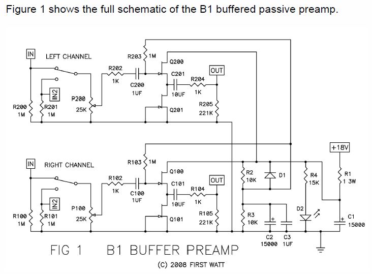

I have a B1 buffer with 200ohm output resistors. Would this be happy driving and amp with 2Kohm input impedance?

It is possible. But, I would expect degradation. I would be concerned with the output cap. I don't have a schemo handy but I would expect you might need to raise the output cap value to maintain your lower frequency cut-off, low enough. Also, the 200 ohm output resistor could likely go down to 25-50 ohms if your not driving long or crapy cables. 😀
The B1 (and DCB1) are limited in output current to just less than the Idss of the selected jFETs.
They are not suitable for line level (1Vac to 3Vac) into low impedances (600ohm), nor into very long cables terminated with medium impedances (1k to 3k).
2k is just possible provided the cables are of reasonable domestic length and provided the Bass response is adjusted to suit.
