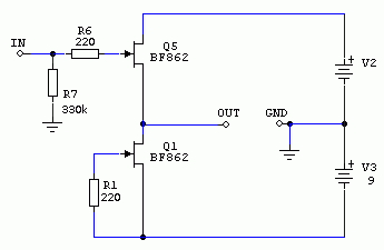

I now have a working BF862 preamp, with four output buffers as shown in post #82 here. (At least, two are working - the others probably have something trivial wrong... There are details and photos at http://www.diyaudio.com/forums/pass-labs/146310-bf862-preamp.html if you'd like to hear more.) Time has come to plan practical details about the filter section. Following the experience with plugin boards on these buffers, the evident shortage of space, and juma's comments on the other thread about the size of the boards, I am thinking of making the buffers as small boards to plug into DIP-8 sockets. This isn't a new idea, of course, there's a fascinating thread at http://www.diyaudio.com/forums/pass-labs/120445-pass-discrete-opamp-dip-8-package.html which describes something physically similar, although electrically different. The same idea could be applied to the LP section, using DIP-16 sockets to allow building the buffers as pairs, which is pretty natural given the schematic. My concern is heat; juma will doubtless say I am worried about nothing (again), but there really isn't much space on the top of a DIP-8, and I'm not sure if I fancy the idea of fixing a heatsink on top like EUVL did for his opamp. (I feel it shouldn't be necessary in this case, anyhow...)
If this idea works it might be helpful to cviller with the PCB idea... Use DIP-8 sockets and either plug in a small SMD board, or plug in the 2SK170s directly...
I think I might do a test run with a pair of buffers and wire up a passive buffer with some sort of symmetrical PSU and see how it works, before doing 14 of them...
Anyone have thoughts on this?

Well, this thread is about using the B1 as unity gain buffer instead of a complete opamp, but you are right that is also a viable path...
dviswa, the reason I haven't been saying anything is because I'm thinking about the number of active stages we need for the low pass. It would be really great if we didn't have to have twice as many buffers, but I can see that the filter is messed up when it is loaded...
I can't really figure out how it was done in the XVR1 (I don't have the schematics, only some high res pictures), it looks like there the signal travels single ended through the filters and there is a buffer for each 2 poles. But there is no double up on the low pass compared to the high pass (at least as far as I can see).

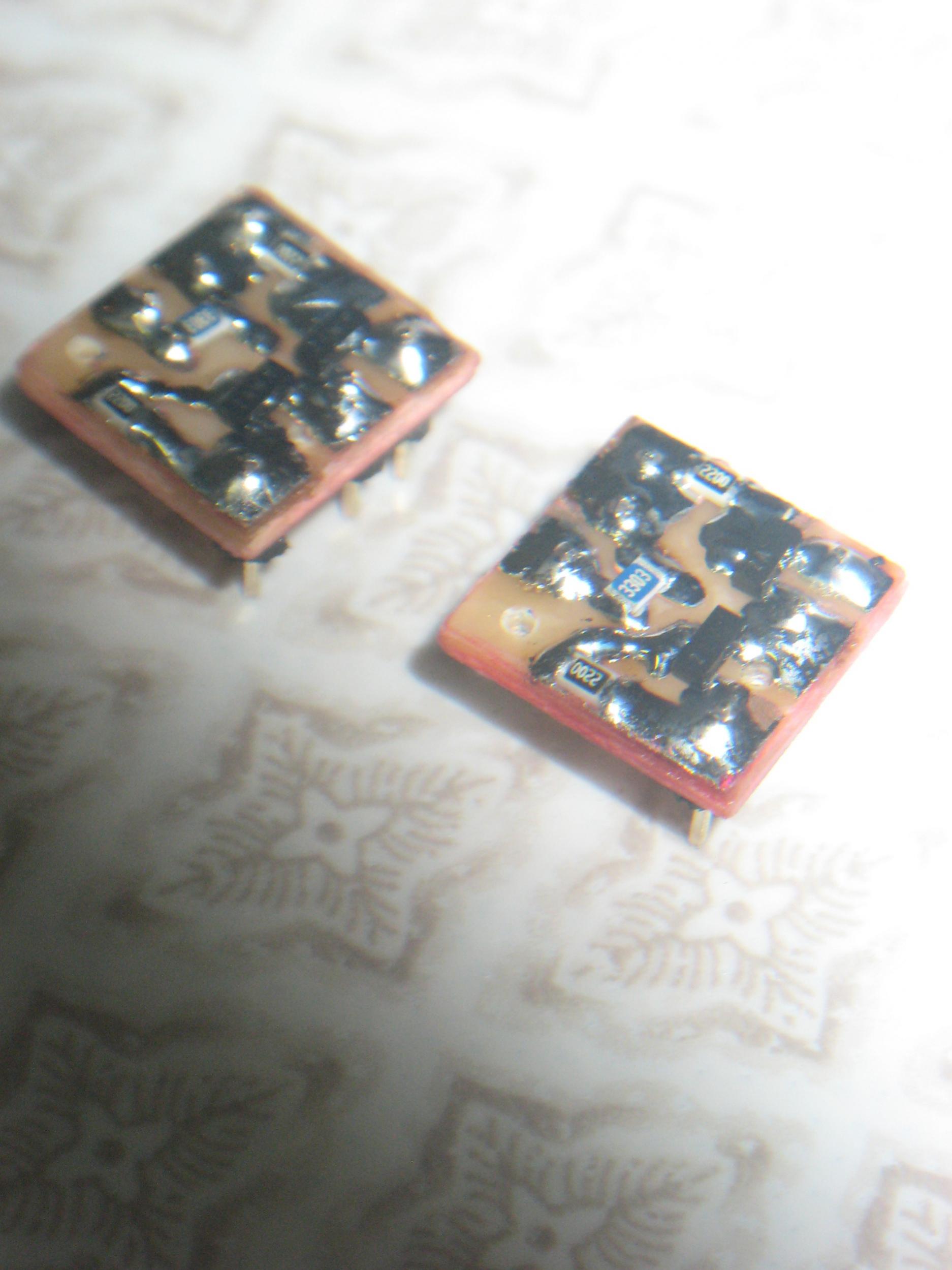

I've spent a very fun afternoon and evening burning PCBs and soldering up a couple of buffers to slot in a DIP-8 socket, and making a test board to see how they perform. (I mentioned above I was thinking of doing this.) If all goes well then I plan on t\doing all the buffers in the filtere this way. (DIP-8 for HP, DIP-16 for LP). I failed to get a good photo of the little boards themselves; the first photo posted is the best that I could manage with a digital camera and a maginfiying glass... The second shows a mostly complete preamp board I put together to test the SMD thingies. I ran out of time and energy before finishing, but hopefully tomorrow I'll be able to tell you all how it sounds.
The little DIP-8 boards are each one buffer as in the high-pass part of the circuit posted above in post #82, except that the resistor to ground on the input is 330k instead of 20.4; there is no filtering necessary in this test case. (I would have used the 1M that juma uses in his circuit, except I don't have any). If this idea is to be used in the crossover then this resistor won't be on the board anyway; it'll be with the capacitors in the switchable DIP-** that AndrewT proposed. I found it all less technically difficult than I expected - the boards were just drawn by hand, and there is plenty of space for two jfets and three resistors.
The preamp board is really intended as a test device, not a version to be used long-term. I deliberately omitted any trimpot to control DC offset, since if these are to be used in the crossover there won't be any trimpot except at the end. Hence the caps on the output; I reckon these should be sufficient to listen to the thing for long enough to check things out.
I am really hoping to find out two things. The first is how much heat is generated, and whether any heatsinking is necessary. (juma was certainly right that my output buffers are on boards uncessarily big). The second is to experiment with power supply variations; as I mentioned above I am uncertain how to deal with the current draw that 14 of these buffers will need, if I use (some version of) Salas' regulator. So I'll try first just with 7809/7909 and decoupling right next to the SMD "IC", and try more complicated solutions after.
I don't have any sophisticated equipment to measure things, but I'd be grateful for any suggestions for things that could be added to the experiment.

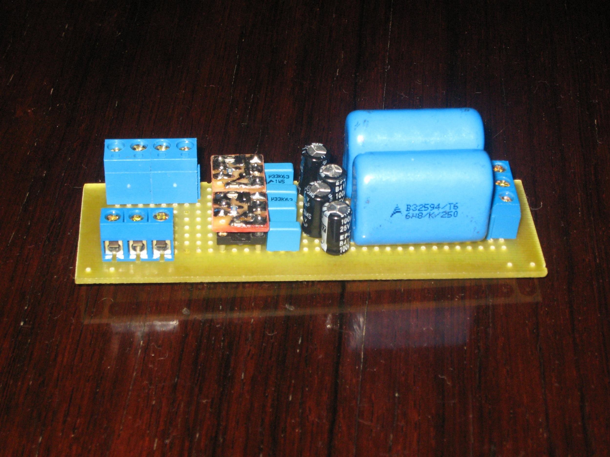

Hi Guys,
I have the test watchamacallit up and running; as described above, powered by a regulated +/-15V power supply that I had lying around feeding a 7809/7909 pair. For the record, the circuit of the buffer-IC being tested is posted below - I've spared you the caps on the output and so forth since these aren't really relevant. (Observant readers will note that it's really juma's circuit attachment from above, altered in gimp...)
One of the questions I wanted answered already is. I'm listening to music through the buffer now, and it doesn't get hot enough to worry about; I can hold my finger gently on the IC for well over 10 secs - generally I take it off because of crackling in the speakers, not because it's hurting too much. The little PCB is too small for me to try and measure temperature more accurately with a probe (or at least, with the probe I have....) so that will have to do. Once in a closed box the temp may be a little higher, but overall I think it's OK.
Next up is a list of experiments with regulator options...
Dinesh: the doubling up of buffers in the LP was discussed above; if you take a look at the schematic in post #82, which is what I'm planning to build, you can see the buffer count in the LP is higher. Explanations of why this is necessary have been posted before #82 by people who understand all this much better than I do.
On a related note, I'm still trying to absorb jameshillj's comments above. For my own needs I'm not concerned about the final PCB design, since I almost certainly won't be buying or using one. However the issues raised (longer signal paths and so forth) will definitely affect my p2p version. I'm hoping that these DIP-8 (and DIP-16) ICs will help in this regard, but I'd be most interested to hear more details about "signal compression and "stuff" ".
Meanwhile, the test buffer sounds surprisingly good - I expected the 7809/7909 to give a sub-par performance but ths sound is still pretty good. Here's hoping a discrete reg gives better!
