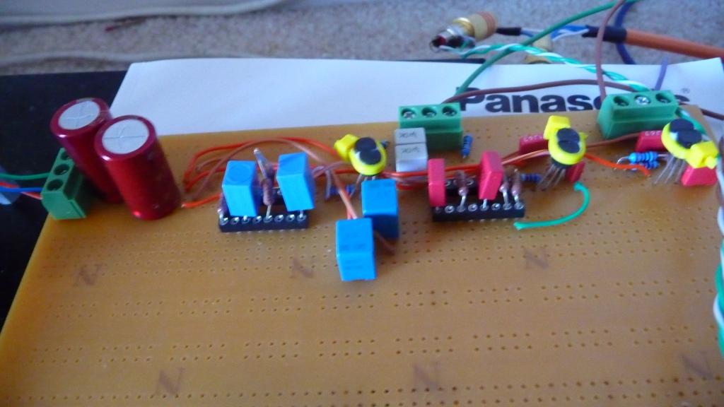

Here goes. I have 4 stages of "B1" configured as Buffer->Stepped Attenuator->Buffer->LP & HP Filters
PSU is nothing special, just vanilla LM317/337 regulators supplying +/- 9V.
As far as impressions are concerned, give me a few days and my second amp will probably be done, then I can run one speaker active and another passive. As already mentioned, this is definitely the way to go, compared to passive crossovers. The sound is much more fuller, and clean, not to mention much more dynamic and punchy.

In the photo I can see three jfets pairs on the board; are these the parts after the attenuator? I guess you have the earlier Buffer in your list as
part of some different board. (Maybe in a preamp?) In any event, you are doing the 12db/octave original version, right?
I'll be very interested to hear how it sounds. How are you planning to fit this into your system? I'm being nosy - what crossover point, amps, speakers et cetera.... 🙂 Do you plan on doing a more sophisticated PSU later?

Its been too busy with my day job lately.Hi Dinesh,
The picture shows only a part of the board. I started building the second channel, when the first buffer stage was finishedm out of curiosity I thought how would it sound if I bufferred the output from my Twisted Pear Sabre DAC before hitting the 10K stepped attenuator. The improvement was so much, I decided to leave it there, so I will add back another B1 stage into the channel shown.
The speakers are Eminence Alpha 15 and a Fostex FF85KeN in OB. The crossover point is not a Linkwitz-Riley, but actually spread apart a little bit. I am still playing with the components. It is very difficult to decide, because different crossover points bring out different characteristics. I am glad I put in that 16 pin DIP socket. Right now the tweeters are cutting in at 480Hz while the woofer is cutting out at 200Hz. Yes it is simple 12 db/octave filters. These are driving a Pavek Dudel's PA-03 amp based on LM4780, it was a GB right here at DIYA.I'll be very interested to hear how it sounds. How are you planning to fit this into your system? I'm being nosy - what crossover point, amps, speakers et cetera.... 🙂 Do you plan on doing a more sophisticated PSU later?

I plan to build a shunt regulator later on, probably rebuild the whole thing on PCB. I will be housing it in an old cabinet, I have lying around from another project from a couple of years back.
Sound wise, the first thing the strikes you is that the sound stage moved forward, like going from 15th row to something closer to the performance. Given that I do not yet have the second channel built, I cannot be too sure of this. The articulation improved a lot and so now I can play it at lower levels than I used to. Of course, last few days nothing is playing, because the power amp is getting a make over. I am adding a second board to the power amp so that I can drive 4 drivers independantly. Once the second PA-03 board is complete, I will get back to building the rest of the cross-over.
I am convinced that this is a very worthy project despite the effort it takes to build it P-P.
