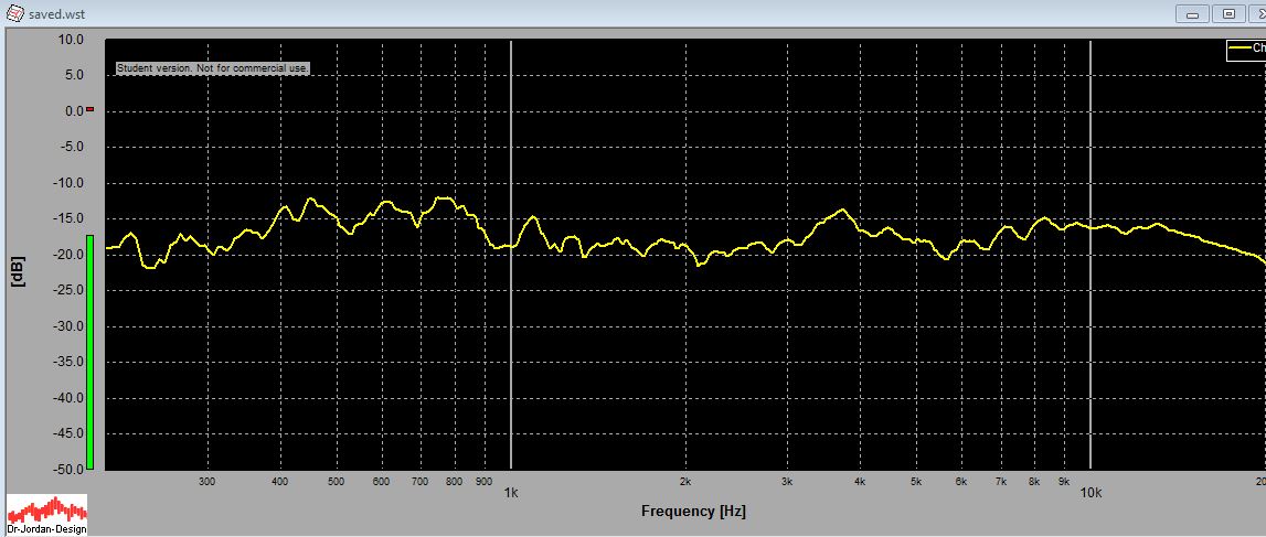

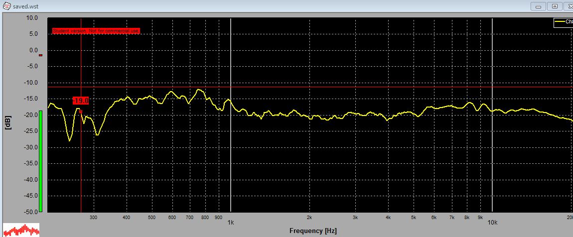

The 800 diamonds crossover is a joke. Horrible on and off axis responses. 6.5" used up way too high, too shallow slopes and with unnotched resonances from the FST. A nice 4th order LW at 2kHz, time aligned via the tweeter pod distance would sound far better and be far more accurate.
From memory the 800 sig has a much better xover.
Edit - I spoke too soon. The 800 sig isn't that great either, the 3.5kHz resonance of the FST is let run free, it's the original 801 that has the more complex xover.
I've owned the old 801 too, fwiw, and imho the new 800 diamond is a much better speaker overall. The FST resonance is controlled enough not to intrude so it's not the main problem. IMHO the new xo is slightly flawed because the tweeter has been moved forward by a half wavelength, rather than connected in anti phase. This means that it's only phase inverted at exactly the crossover frequency, resulting in a slightly jagged response.
To be fair though the response isn't too bad at 15 degrees off axis and minus 5 degrees, but the speaker is still lacking the overall smoothness of previous models.

You can download the schematics from here: B&W Group North America Service & Support - Service Manuals
I've already run some simulations.
Not sure if their free availability is by design or accident, so I've downloaded them while I can.

Thanks sharing measurement they beatifull, great gear you have including microphone.
