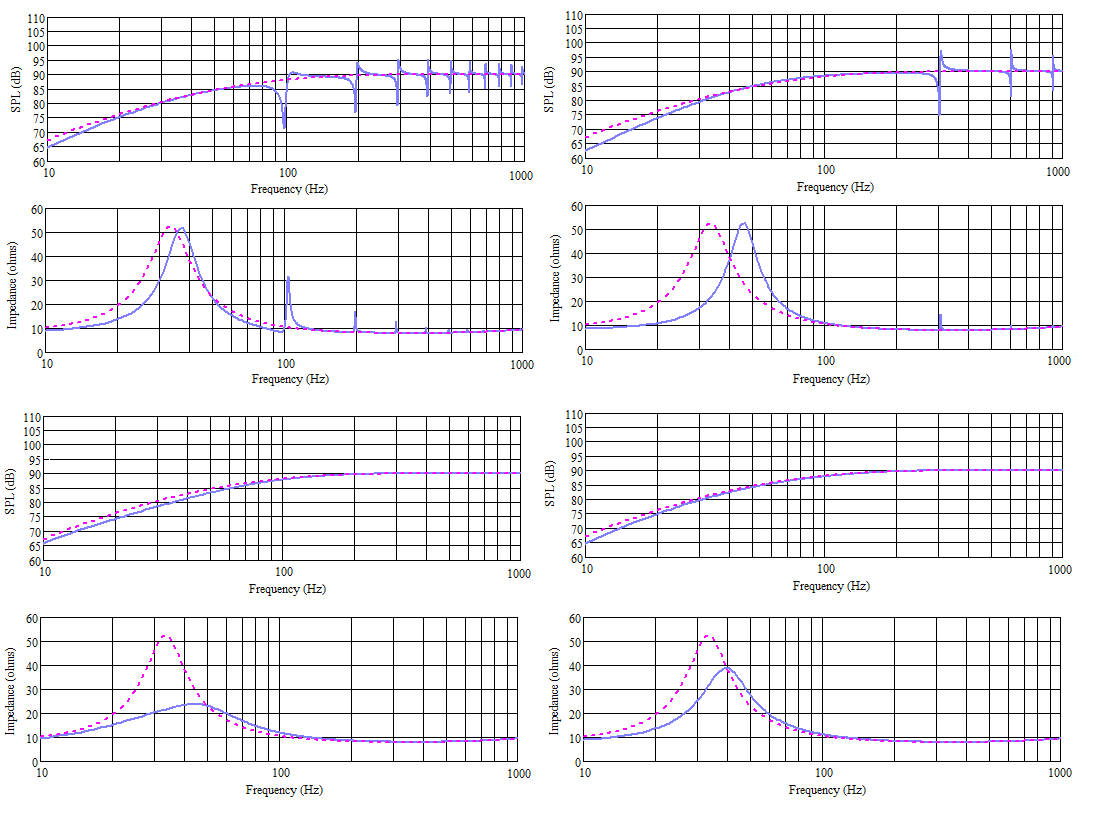

The simple reason for a using a damped 1/2 wave (sealed) TL rather than, say, a sealed box of the same volume is that it offers greater flexibility for the designer, and if your objective happens to be a well-damped impedance or FR characteristic, they can actually be more effective, providing you can accommodate any relevant extra complexity etc. For example, see the attached. Working from top to bottom, the left column shows a 1/2 wave (sealed) transmission line. Top graph shows the IB and actual system curve with the pipe undamped, the graph immediately below the IB and system impedance. The 3rd & 4th graphs then show the same pipe, damped to a modest level. The right hand column shows a sealed box of identical volume, leakage losses, damping type and quantity, top two graphs undamped, lower two damped to the same quantity as the TL.
What do we see? In the undamped enclosures, the resonant chain from the sealed 1/2 wave pipe is obvious, although the harmonics are low-level & easily damped with a minimal amount of material. The TL is actually tuned lower because I selected a max-flat impedance (aka 'flattest practical') tuning frequency (length) for it. The sealed box of identical Vb is tuned about 8Hz higher, & less in the way of a resonant chain since no dimension is stretched significantly relative to the others for eigenmodes to affect behaviour / tuning in any significant way. Beyond the difference in nominal tunings though, the impedance of the damped enclosures is where we see some further interesting differences, with the TL being a significantly flatter load, despite the identical Vb, damping quantity & type, leakage etc. This is why they can be useful: we have several extra dimensions of tuning & load characteristics that can be exploited. Midrange lines are an obvious example of where they can be useful & are quite commonly used, since the potentially flatter load can be valuable in passive filter design. Beyond that, the potentially more effective suppression of enclosure modes may (may) make for a cleaner response with less in the way of colouration from the enclosure. Whether that is audible, or more than marketing depends on the design. I'm no particular fan of the Nautilus as is, but it's grounded in solid enough physics as far as its design objectives & operation goes.
