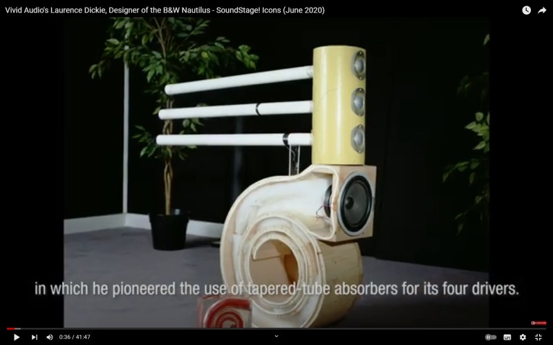

I mean, how does the wavelength matter if the goal is to absorb it anyway? To create a resonance.... to absorb it anyway? Its purpose is to not resonate in any way.

The interesting thing is that with any ordinary box, our goal is usually to absorb everything except the bass resonance. It usually isn't necessary or desirable to absorb the fundamental resonance in a closed box or a transmission line.how does the wavelength matter if the goal is to absorb it anyway?
You are perfectly right, that's not the principle of a closed box nor the one of a transmission line! And that's exactly the point, since the Nautilus is neither, the principle is absorption. Thank you for supporting that very point!
I'll support it if it's true but I don't know that the goal was to remove the fundamental bass resonance. If it were the goal, I'd probably go on to ask why it was done.
The design goal was already posted before and that's what the whole stick of the Nautilus was about. Actually, that was the main sale argument about it, the lack of any resonances. I am not claiming it's the best way to design speakers but that's what they were they put the emphasis on. And countless magazines praised them on that aspect. I don't build my speakers on that principle since there are much more important aspects but that doesn't change the way they built that speaker. And no, it wasn't a TML in their design principle.
They can't have meant eliminating the bass resonance. Even if you absorbed the entire backwave, the woofer still has a resonance. That's just the reality of a limited bandwidth system.
I agree on that too. But that's not what their sales pitch was based on. And none of the measurements , either their own nor the countless magazines ones support the theory of a TML. A lot of folks supported the addition of subwoofer though since the low end performance wasn't really convincing. That was actually the point why/when they introduced a subwoofer to their program.

I don't want to start a war on this but oh boy are there tons to shoot at. This is by no means a TML, it's a completely different enclosure principle, absorption and not resonance. Can we agree on that?

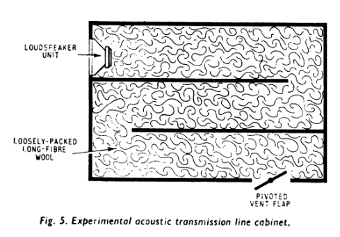

No, and you're repeating yourself again, stating your opinion as though it were fact. I'm still waiting for you to provide your universally accepted, documentary evidence, with the physics and engineering, that the single and sole definition of a transmission line is a resonant quarter-wave pipe. At a rough count, I've asked four times now, and each time, you've avoided doing so. So it's time for you to step up to the mark: if you have that data, please provide it. You are the one making very specific claims: the onus is upon you to support them. Here's one quote that may make it a little tricky for you though, since it's from the original article by the man who is widely considered responsible for the type:I don't want to start a war on this but oh boy are there tons to shoot at. This is by no means a TML, it's a completely different enclosure principle, absorption and not resonance. Can we agree on that?
Bailey, A. 'A Non-Resonant Loudspeaker Enclosure Design: using acoustic transmission line with low-pass filter characteristics' (Wireless World, October 1965) pp.484-485...This was built as shown in Fig. 5, the far end of the pipe having a pivoted flap so that characteristics could be taken with both open and short-circuit terminations.'
Since even the [nominal] inventor wasn't so proscriptive in how he defined it or what he experimented on, claiming otherwise has some issues.

Scott, I've already said the principle is absorption. What 'evidence' do you need on that to understand? Absorption, as in 'nothing comming back'. . I can't phrase it any more descriptive. It's exactly the opposite of a transmissionline which, no matter where you look at an explaination of it, bases of resonance. The whole speaker is constructed to avoid any resonance. Why do you want me to explain what a TML is if it very obviously isn't the principle of this speaker? (Aside from your preemptive announcement you'd not accepting such an explaination anyway). If you can't understand the absorption concept, I can't help you. On the other side, why would such a principle need a transmission line? Or, like you and Dave are claiming it and never giving an argument for that either. Will you believe it if Laurence Dickie himself tells how it works? Would that help you to understand?
0:36 into this video, the quintessence of the speaker.
Or take the Wiki page about B&W as explaination. And no, I didn't edit that page.
@eriksquires: I don't like the Nautilus either. Maybe it helps to not see it as a loudspeaker but as a sculpture which can reproduce sound.
