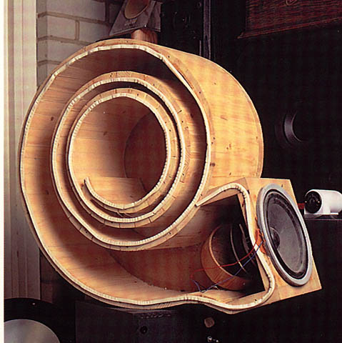

What is the math(s) used to design the waveguides behind the Nautilus loudspeaker. Is it a 1/4 wave design that tapers to a point? Does volume not matter? Is it a sealed or t-line enclosure? “Experiments showed that tapering the horn shape and then curling it up would perform just as well but would occupy a much smaller volume than a straightforward, constant cross-section pipe. ”

The bottom one has a half-wave sealed TL.
A TL is a resonator. The Nautilus is the exact opposite, it is designed to absorb the back emitted sound.
I think it’s a highly damped sealed enclosure of odd dimensions. Especially when you consider the Nautilus uses lots of eq in the bass. But, I could be wrong.
To be fair B&W call it a transmission line. The tubes for the high frequency units are reverse horns. Maybe it’s all marketing like @Arez says.
Some TLs are, some aren’t. If it is damped aperiodic, which the Nautilus is, the are (close to) not resonance.
Theback wave passes thru a half-wavelength of damping as it goes down the line, then another half wavelength on the way back — by the time it gets back to the driver it has been (larely) damped out/killed.

Only if it's designed to be. Many are used for that purpose -nobody ever said that is some form of obligation. You might recall the title of Arthur Bailey's Wireless World article (the one many tout as the first and annouce as the only arbiter of what a TL is): 'A Non-Resonant Loudspeaker Enclosure Design'. 😉A TL is a resonator.
Aperiodic TLs are designed with the sole object of providing a response similar to a sealed box, potentially with a little more extension (e.g. Augspurger's alignments) and / or simply the flattest possible impedance curve; sealed TLs typically follow that or (related) a heavily / progressively damped line to kill the back-wave. This is neither news or unusual: 1/2 wave pipes go back to the 1930s.
1/2 wave line; per the above it's not designed for output, just as an alternative to a [in this case] critically damped sealed box with a more effective, if rather bulky way of damping out the back-wave & potentially providing a flat[ter] impedance.I think it’s a highly damped sealed enclosure of odd dimensions. Especially when you consider the Nautilus uses lots of eq in the bass. But, I could be wrong.
Also TLs of a different kind, in their case 1/4 wave as IIRC they're open tapered pipes, but of highly restricted dimensions, again because the object is damping rather than output. The implementation has a heavy dose of marketing (they're a commercial company, not a charity) but the actual operating physics are perfectly functional. Whether it's necessary is another matter. But you can say that in some way about about many commercial products or DIY productions.To be fair B&W call it a transmission line. The tubes for the high frequency units are reverse horns. Maybe it’s all marketing like @Arez says.
So the progressively stuffed reverse closed horn is a 1/2 wavelength aperiodic transmission line. I’m guessing the drawback is less lower bass.

What's the point of ½ or 1/4 wave here? Each driver has quite wide passband...
Open back of TL are designed to work as bass reflex at certain tuning F, but closed... I think aperiodic is better description here. I amnot sur about mid's tubes, do they havea small hole at the end of the horn?
Its 1/2 wavelenght resonator. At resonant frequency air inside behaves both as mass and as spring.
Assuming its resonant frequency is equal to Fs, in effect you have additional mass and stifness added to the cone assembly.
Compared to the closed box, only Q of the system will go up, but not the system resonant frequency. Also, beacuse of dual behaviour of air at resonance, stuffing the line gives more efective acoustical damping of the whole system.
So, with proper design, you can get lower Fs and better damping compared to closed box, and with smaller volume.
