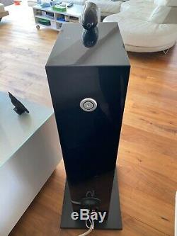

Galu, when you say slacken the rod, do you mean from the back of the speaker?
I am not sure how to even view the holding rod.
The rod adjustment point is clearly visible on the rear of the speaker. When shipped, this has a transit lock over it which should have been removed when the speaker was set up.
Try unscrewing the rod from the rear a bit at a time, simply to see if the mid starts to come loose from the baffle.
As I say, I have no direct experience, but caution you against muckin' about at the front of the driver.
See attachment.
