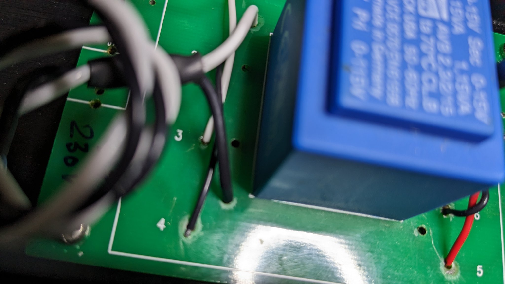

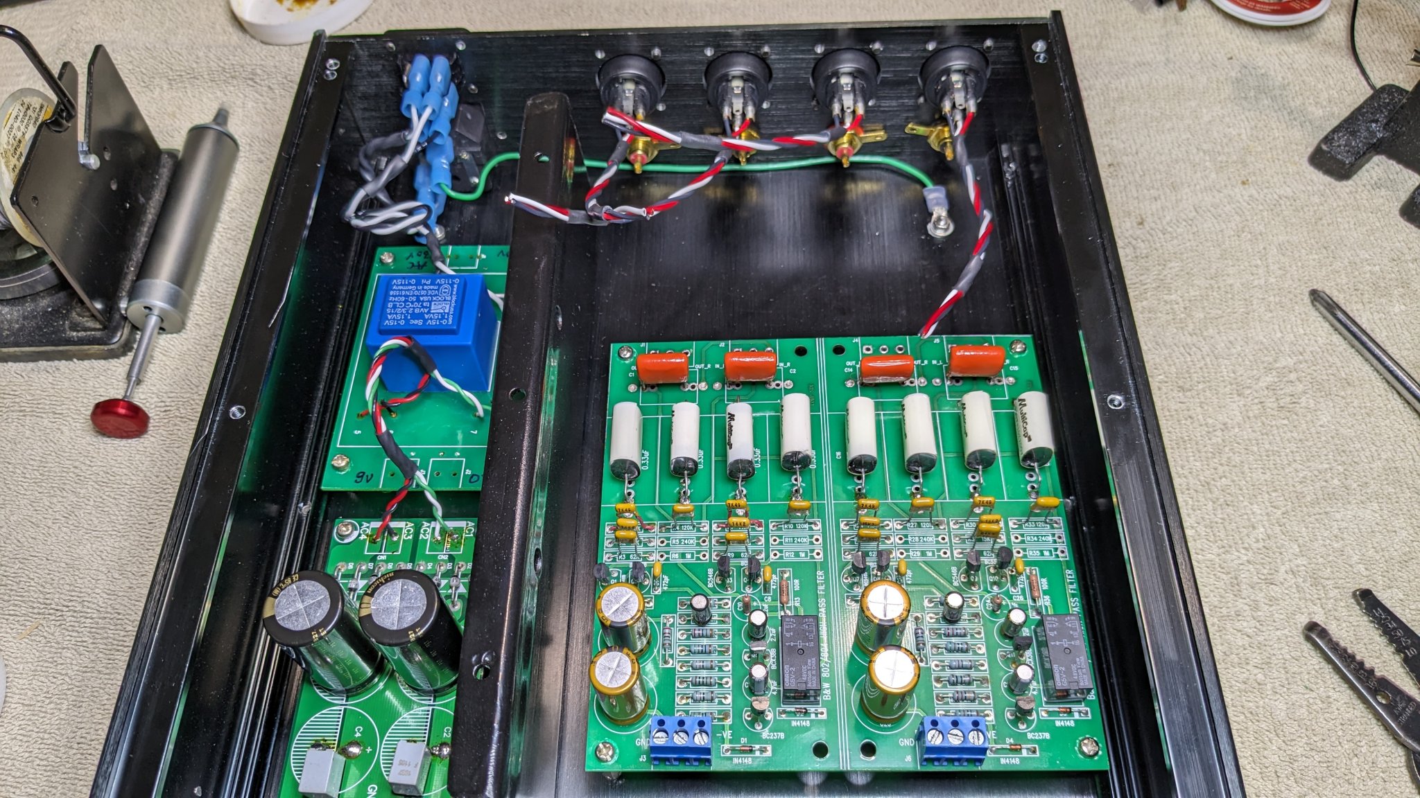

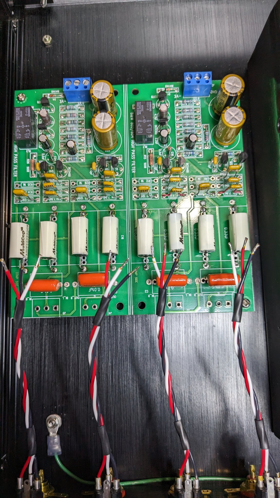

1. Anyone recognize this PCB and have a link to ANY documentation?
2. The signal lead pads (in and out) on the PCB are not marked for positive or negative. Ground is center. The outside pads are one circular and one square. Any guesses as to which is positive?

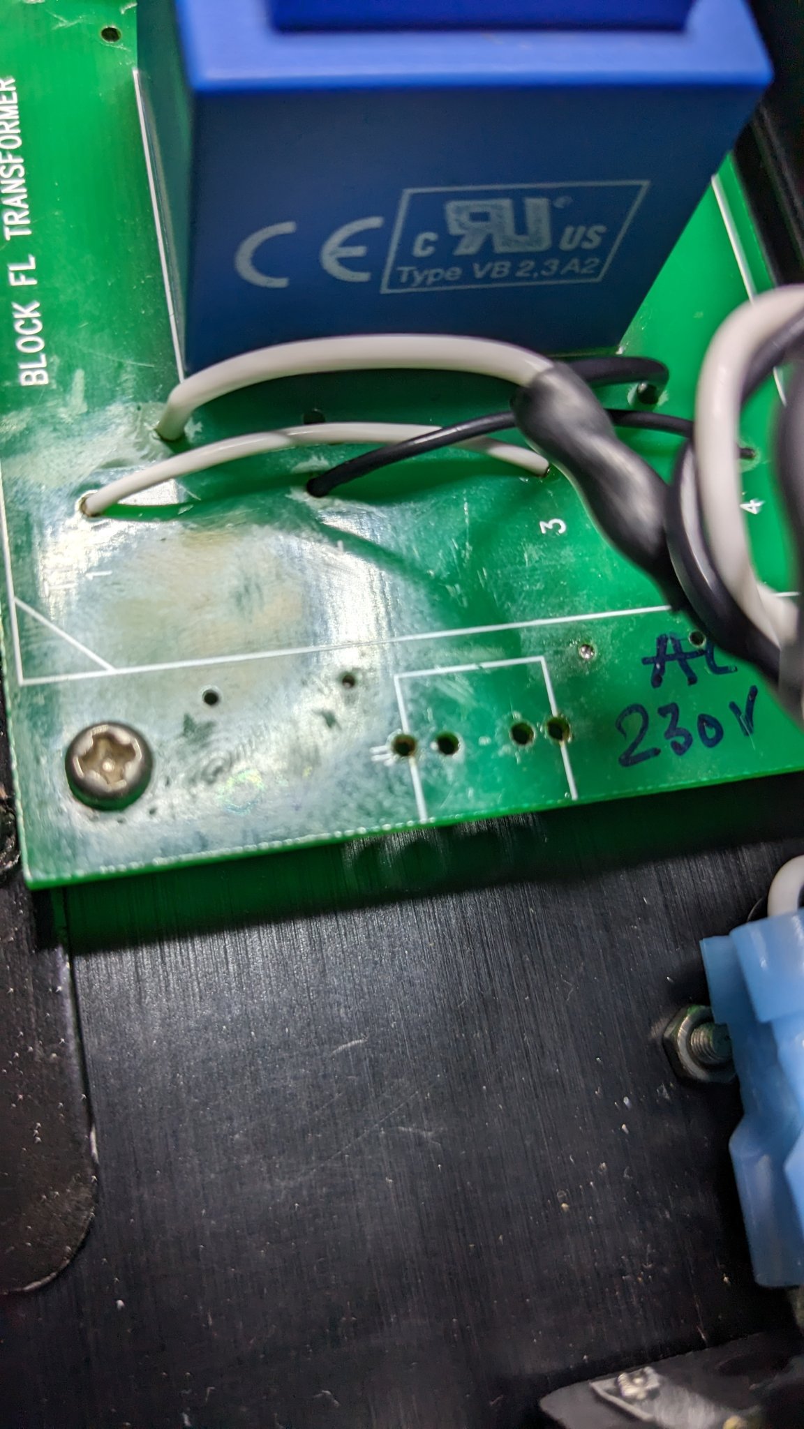

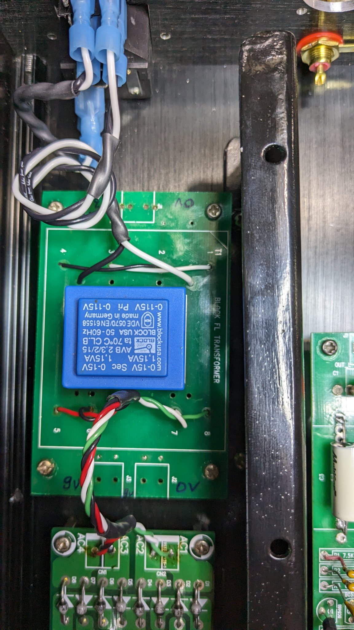

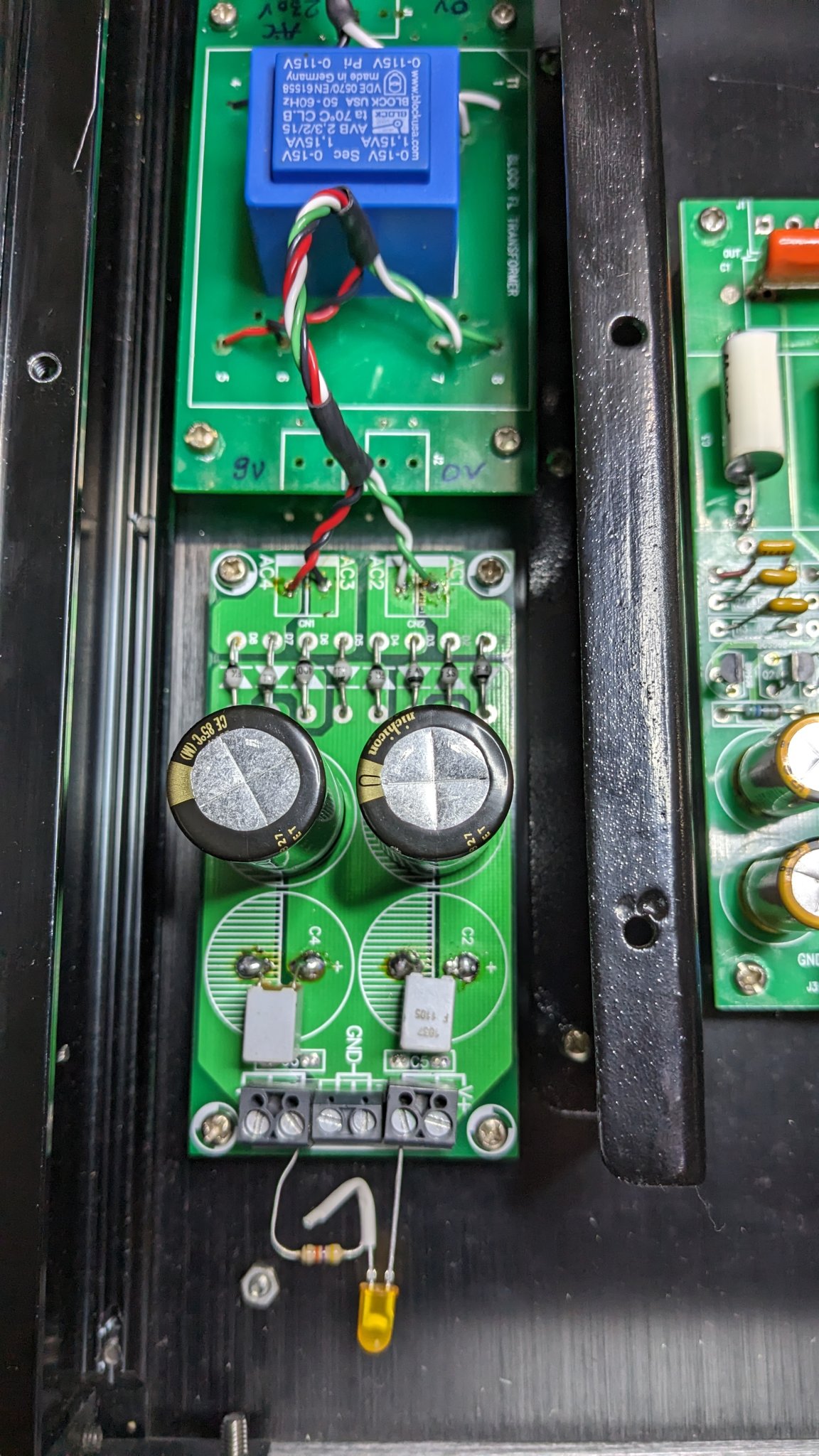

3. The transformer is labeled as dual primary and dual secondary. With secondary as 0-15vac / 0-15vac. However I am getting 22.5vac off both secondaries. Rechecked the jumpers on the primaries to make sure I didn't series the primaries but it doesn't appear so. The rectified DC side is 29.5vdc. Added an LED for some type of load on the DC side but the output of the secondaries didn't change. Kit type PCB's, anything else I can check?

The PCB's came pre-assembled. Several solder pads were filled and I didn't have the confidence in really heating the pads to use a solder sucker or wick to clean them up. So I have what I have...

So do we know what this is.. is it a second order high pass filter, line level, balanced in/out?
If it is balanced, then how important is the polarity to you provided L/R are the same? Have you traced the circuit or tried scoping it?
