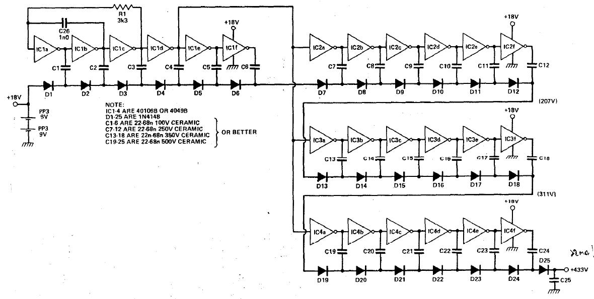

2N4856 looks good and it's not even unobtainium. You would want to check the noise. Here's a cute HV supply that costs almost nothing, You could probably get 200V at the end with only one 9V battery.

Hi Scott,
I thought the max supply was on the order of +16 VDC for one. Maybe some could be pushed to +18 volts abs max, but I wouldn't want to depend on that.
Please help a tech's crashed mind as he attempts to digest this idea. Had anyone else posted it, I'd likely be telling them it is extreme and wanton cruelty to a poor defenceless CMOS chip. The thing that I can see happening is the charge through the cap is all the chip experiences, but I'm worried about what is going on with the initial peak current, energy increasing as the square as the voltage goes up and all. Peak currents might be the undoing of this cool circuit.
Otherwise, really cool circuit. Thank you for posting it.
-Chris
-Chris

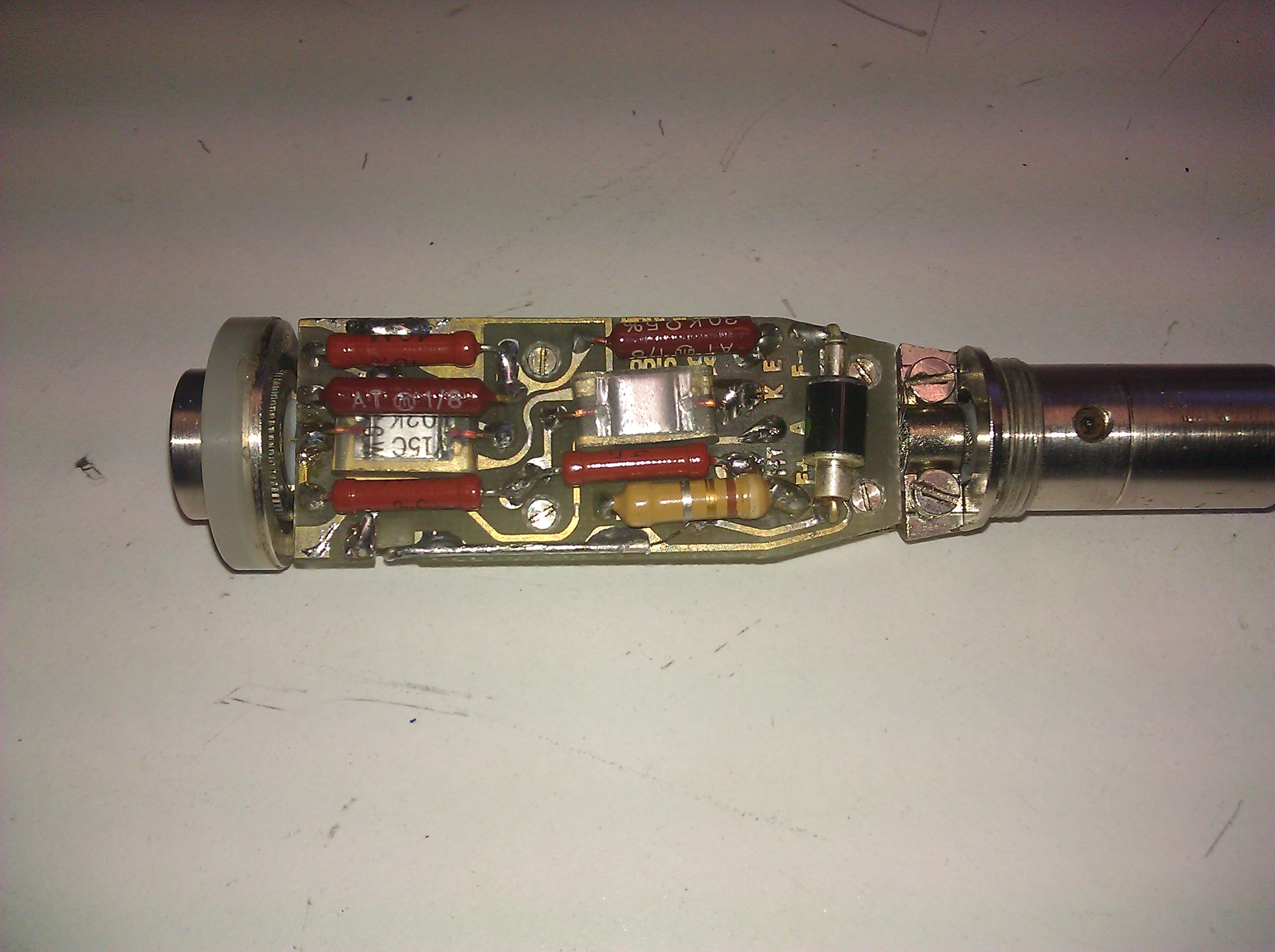

Photos of mike preamps
Here are pictures of the inside construction of the HP 1/2" mike and a B&K 1" tube mike. I could not figure out how to open the B&K preamps I have and the open ones I have are not here. The B&K has the ntube under the PCB. You can almost see it in the side view. Enjoy.
