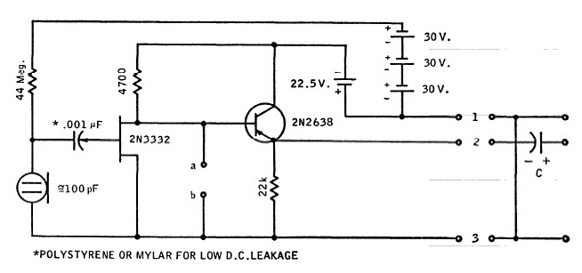

Hello
It would need a fet input buffer or an fet input opamp buffer.
I've found this circuit on the web, just need to change voltages, what do you think of it, does it need any improvements ?

I'm not sure it will work for the B&K mikes. The cap leakage needs to be really low. You need a biasing method for the transistor or it will probably shut itself off. The real ones use things like teflon standoffs for the critical connections and the input cap is much smaller.
If you are interested I'll scan the HP circuit and post it. Its the simplest and one of the best I have tried. You will need some 1G resistors or similar.

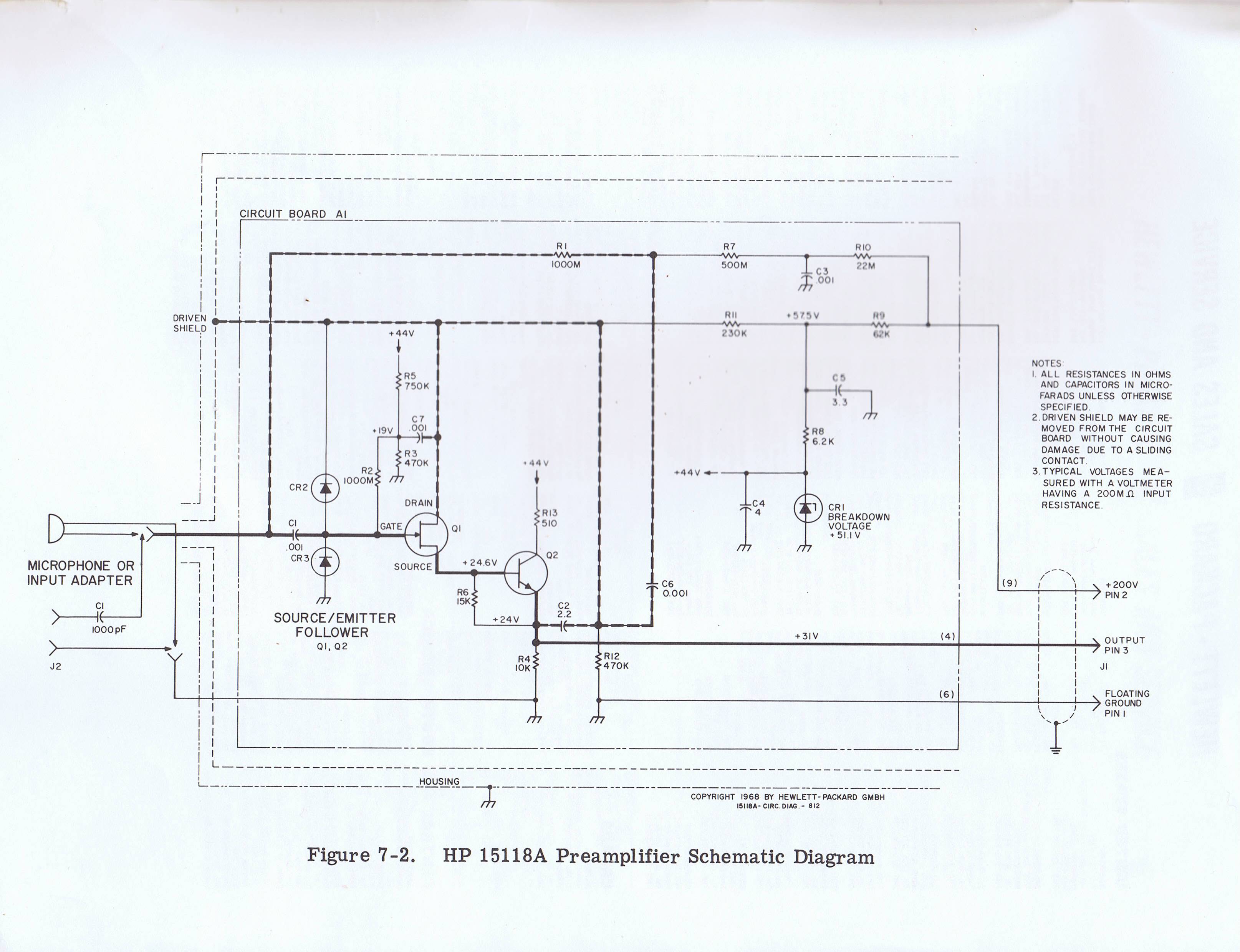

HP Part numbers:
Q1 1855-0020
Q2 1854-0307
CR1 51.1V 5% Zener
CR2 1901-0376 35V working 2 pF at 0V low leakage. (Not a fast switching device, its for protection of the transistors.)
1GOhm resistors are intrinsically special.
The caps are ceramic for low leakage.
The mechanicals are more challenging than the electronics.
There are HP cross references on the web somewhere for the transistors.
Hi Demian,
Thank you for that diagram.
Absolutely! The mechanical stuff is what determines how well it works. Using Teflon standoffs is very common in instrumentation. Blocking any air currents is another thing to watch for. So many issues to think about.
Hi Scott,
I have read that a signal J-Fet also makes a good low leakage diode. I can't place where I read that at the moment. Also, glass diodes need to be shielded from all light. The BAV191 is surface mount, isn't it? (= light not an issue).

Good work on the cross references. Perhaps you can find datasheets on those parts?
The teflon standoffs are to reduce stay leakage that a PCB may have. The critical connections are the ones at the far ends of the 1 GOhm resistors. The impedances are very high.
If I get a chance I'll take a picture of the insides of a preamp to show the construction.

Yes cut the drain off of a 2N4418 and use the gate to source, typically 20fA leakage. BTW part 2 of my Linear Audio article will cover a lot of similar stuff. Including eliminating the G Ohm resistors in some circuits and using just these diodes, as well as an interesting way to generate the bias without an oscillator or any switching at all.
You can stuff a tiny piece of #24 teflon wire wrap wire into a slightly undersized hole and it makes a good stand-in for the stand-off.
