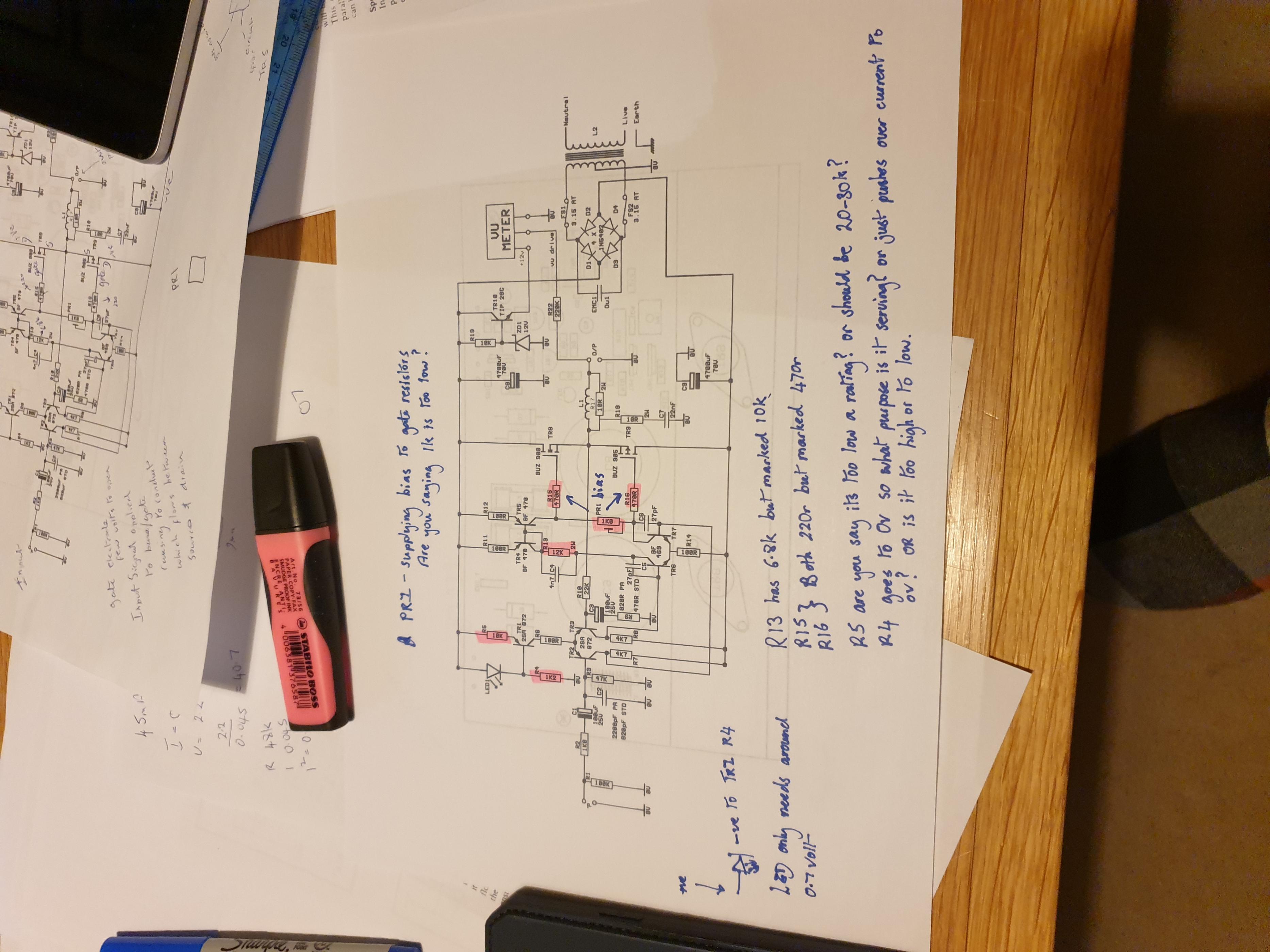

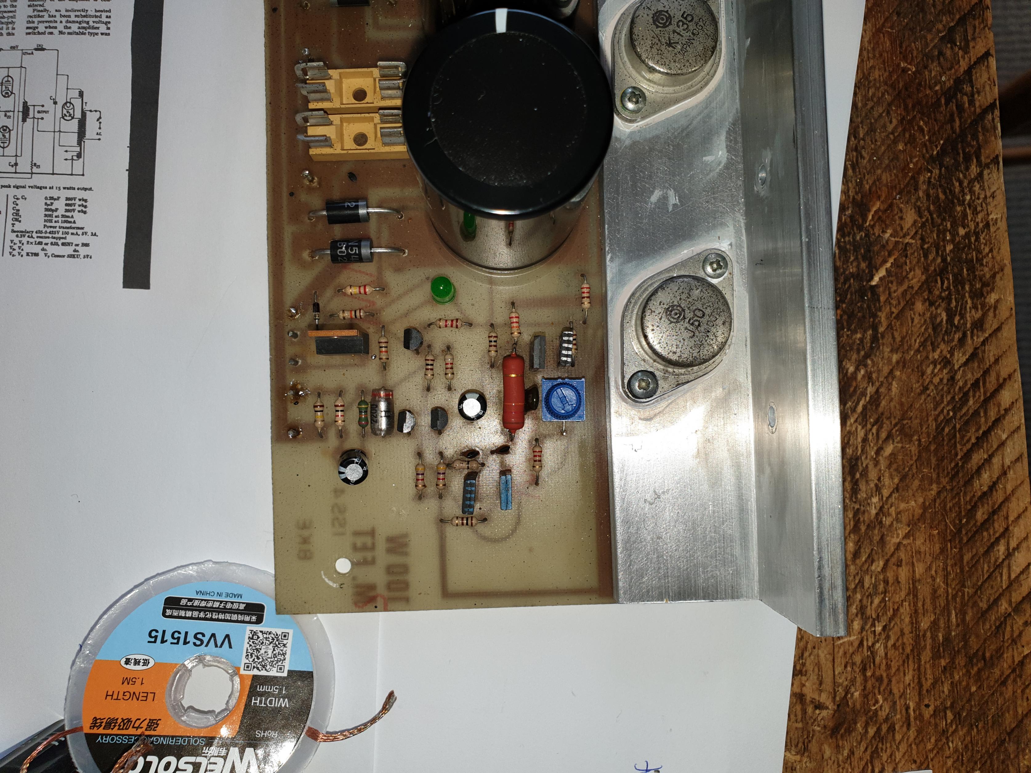

Hello Chris
BUZ900 = K135
BUZ905 = J51
R13 is 6K8
R15 and R16 are gate resistors and were raised to 470R for the BUZ900 and 905 for the K135 and J51 then the gate resistor are ok at 270R
Main rails are 58 - 0 58 DC
PR1 is the setup for quiescent current and this will be quite low 10 to 100 ohms

edit: One thing I can mention: +/-58V rails puts the current through that poor, overworked green LED, at 46½mA -- way too high. That's guaranteed to damage a 1980's LED.

Don't know which plural '10ks' you're talking about, but the bigger problem is the R4 value. A few hundred uA would be plenty for the CCS to function; go ahead and make it a couple/few milliamps just so the LED lights, and you're on the crisp part of the knee.

Leaving one end of PR1 floating is asking for trouble -- likely well into the future, but nonetheless serious trouble.
I would connect the floating end to the wiper. That way an intermittence (bound to happen sooner or later) won't cause momentary saturation conduction by the outputs.
Even better would be add a fixed resistor in parallel. This is to reduce the adjustment range to maybe 15 or 20% higher than the desired value, once you've found what that is. Likely values might be 1k2, 1k5, or 1k8.

Cheers Rick a lot to take in there yes the 50 odd volts I thought was rather high for 100 watt module. From what I’ve read it’s around 35. I switched that resistor to a 10k as per schematic as it has a 6.8k there which as said had burnt the board so getting way too hot.
So you’ve lost me on R4 and R5 sure you said R5 need reducing the 10k one. But saying R4?
Yes looking at trimmer has thrown me a bit as looking at other schematics it’s slightly different setup. Anyhow I’ll plod at it and digest all that info.

R4 provides all the current for the LED and TR1's Base. The latter only eats a few dozen micro-amps, and the LED only needs a few mA, to get on the 'crisp' point of its V-A curve.
Any green LED, forward biased from a 58V rail by a 1200 ohm resistor, will see a current of 46½ mA -- at least initially.
Swapping it and R5 would set the LED current at 5,6 mA -- much more reasonable and plenty to hold TR1's Base at 2,2V. Even 22k, 27k (2,1mA LED current), or 33k (1,7mA) would be plenty and just fine.
Fitting the 1k2 (the original R4) between TR1's Emitter and the '+' rail, puts ~1,6V across it providing a 1,3mA current for the input differential pair -- much healthier.

Working from the last two blue, hand-written notes from the post 73 pic, my explanations on R5 and R4 aren't good enough!
First, confirm that the LED has ~2,2V across it. (*) You can leave R5 out of the circuit and power it up. That will leave everything up to the outputs off, so no harm will come. Just don't measure the output offset -- it won't mean a thing because it will only be leakage currents.
If R4 is still 1k2, take it out. Replace it with a 15k, 22k, 27k, or 33k. That may seem drastic, but so is powering a 1980's LED with 46 milliamps!
Once the voltage at TR1-Base is confirmed to be ~2,2V below the '+' rail, you can entertain values for R5. There are different theories on how much current to run your input pair (Tr2, TR3) on, but most fall in the 0,6 to 2mA range. The Emitter of TR1 will be held firmly at ~1,6V (if the LED is behaving/not damaged), so the resistor that used to be R4 - the 1k2 - will actually be a pretty nice 1,3mA -- a good starting point.
Then we'll be ready to address the issues in the next stage.
Regards
*) I'm betting that it has been 'stretched' by the overcurrent, and its 'knee' is now too soft.

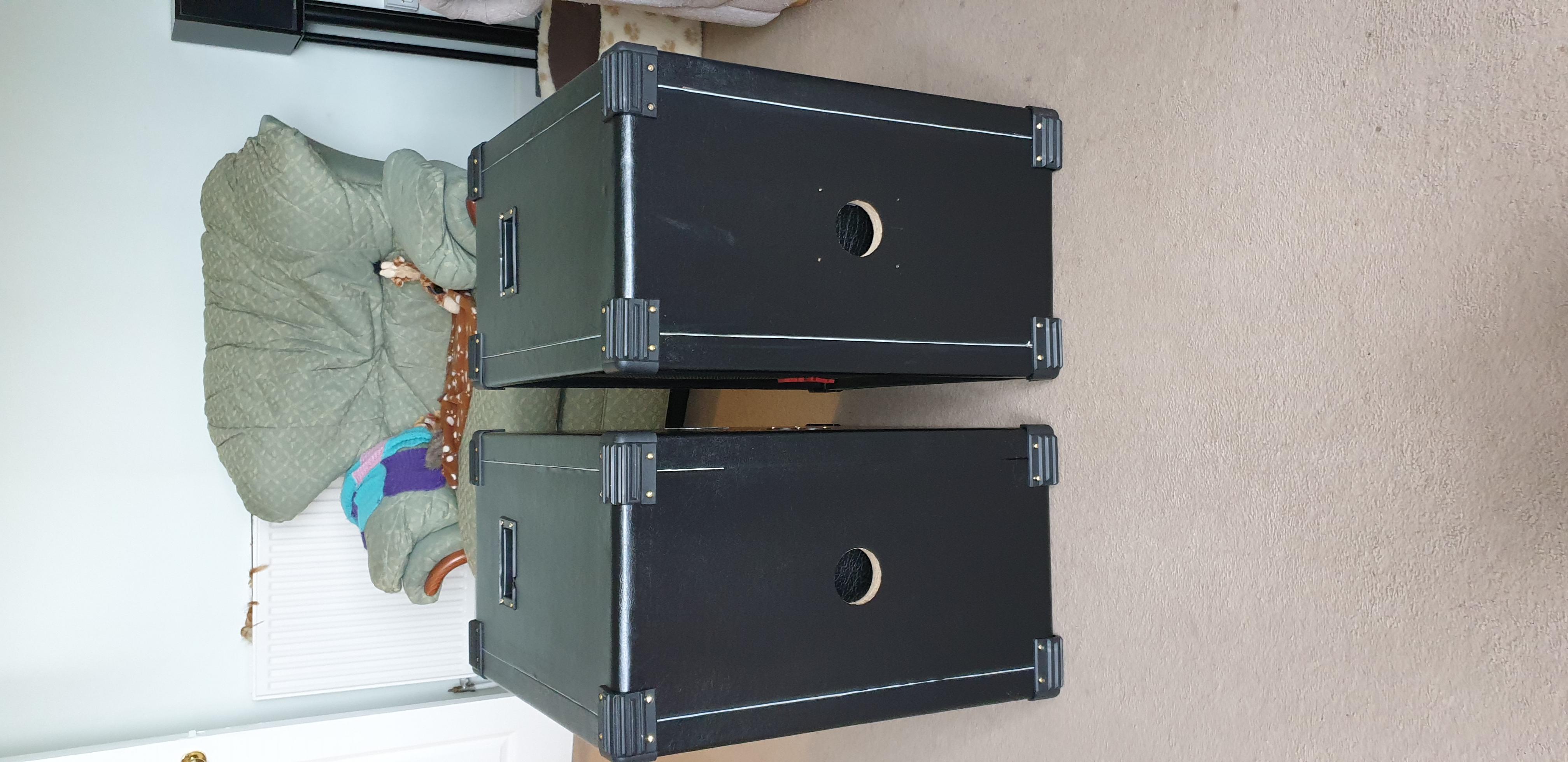

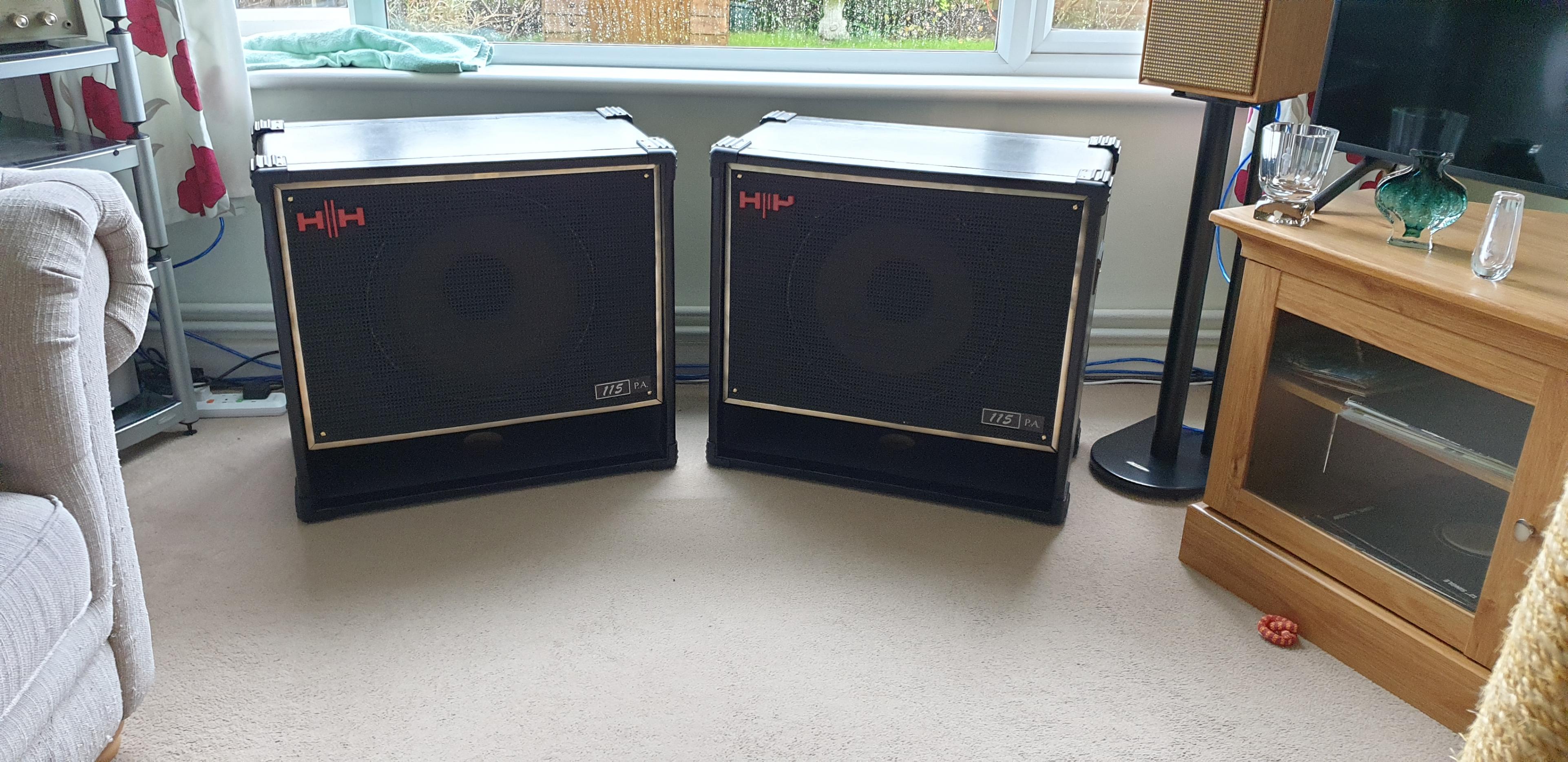

Here's speakers ill run it through complete refurb they where a complete mess dust caps blown out damp damage to the bottom cabinets veneer all torn but was happy with end results. I ran them through my quad oh my God unbearable beautiful sound but whole room and even my body was vibrating could only bear 5 minutes and that was only two notches on volume.

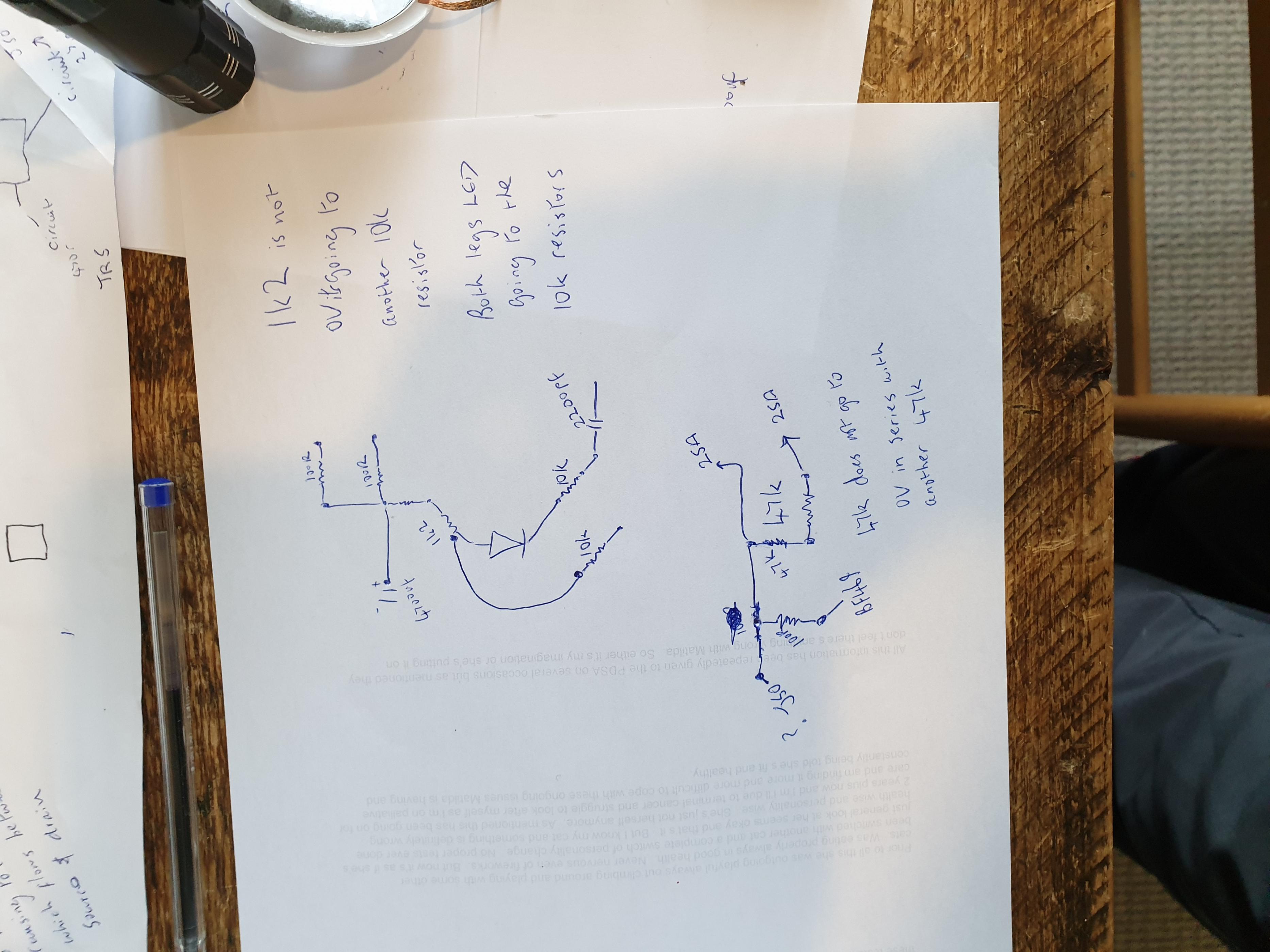

Right that schematic is not for this module at all. 1k2 does not goe to 0v it goes to another 10k do you have a 20k on each leg of the led then off to 2200pf cap other part 1k2 goes to gate of 2sa as shown.
Plus you also have 47k going to 0v but its in series with another 47k both of which go to the 2sa again but there's no other 47k listed on that schematic. Have a look plus there is no other 10k listed on it either.
Pics attached. Definitely not the schematic for this one. Well how it's looking to me have a look at the tracks on module second picture. So I think this schematic is either unfinished or parts omitted for some reason. Majority of it matches.
