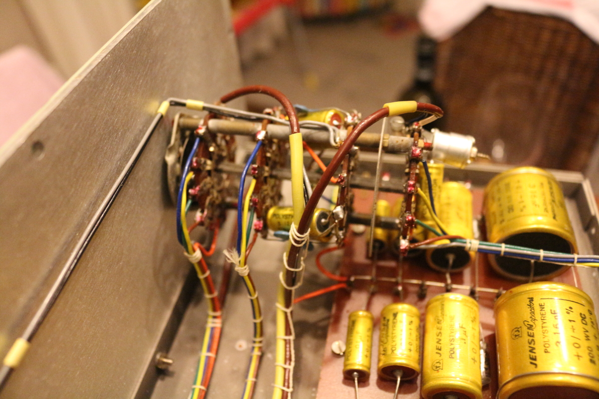

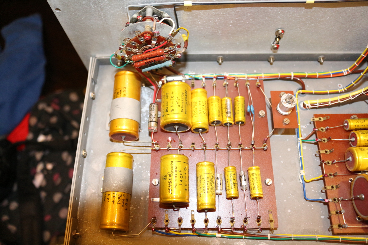

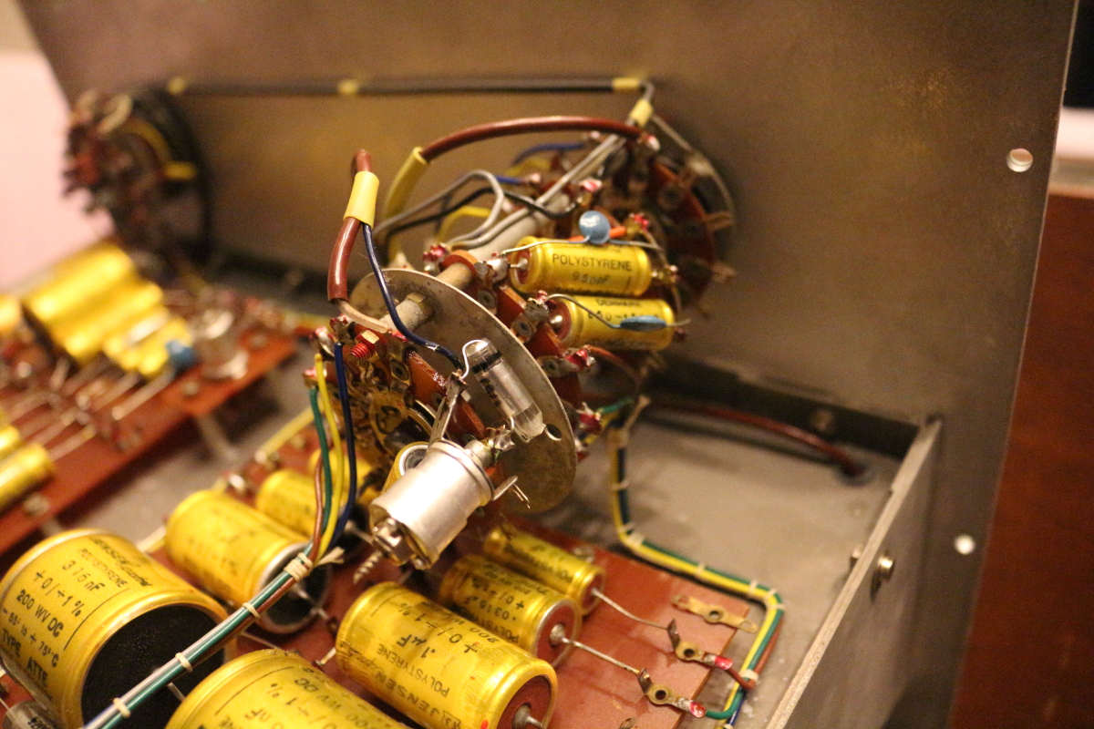

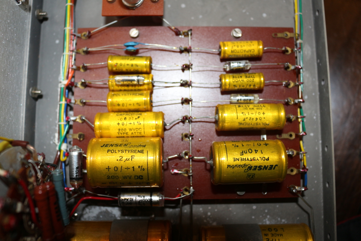

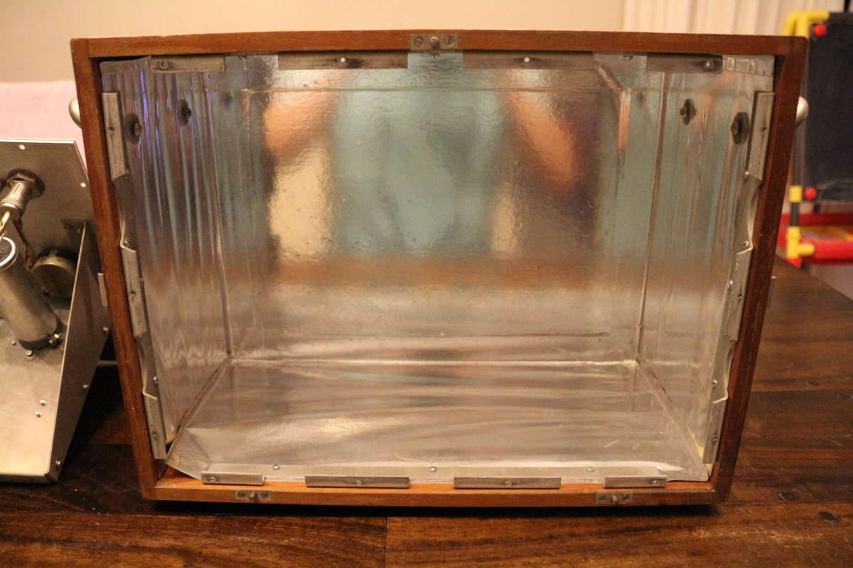

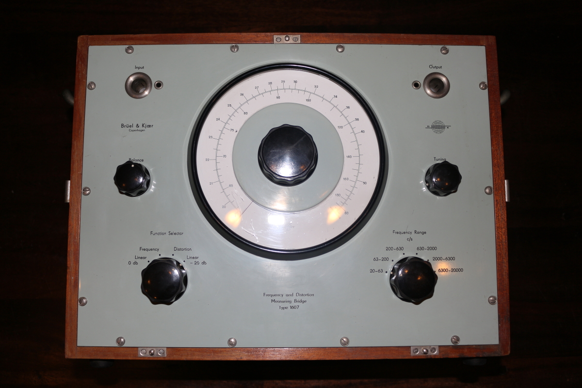

I finally received the unit, and it looks great! Pots are smooth, no sign of rubbing. Cosmetically, it looks very nice. I haven't had the change to test is yet (need to solder some BNC connectors first), but I am confident it will work.

If you are in a rush the recessed socket is compatible with a banana pin.
The wood case is a nice touch.

Thanks, I didn't know that (my first B&K unit... 🙂 ) I have some banana cables to BNC lying around somewhere, so that would be ideal to give the unit a spin.
I works 🙂. Just tested a noth at 1 khz, and could get a noth of over 80 db with carefull finetuning. This is directly connected to the EMU1212, so I would expect the input impedance of only 10K (the manual of the 1607 suggest minimum 100K) might be influencing this result a little.
The indicator is off a little, when the null is the deepest, instead of being right on the "100" mark, it is more on the "32" mark above (around 1020 Hz)
@_Wim_ -- the low input Z of the EMU can affect the notch tuning, so buffer the output of the 1607 with a unity-gain quiet op-amp before you start trying to adjust anything. Also check the end points of the scale for any offsets -- if the frequency error is pretty constant and in the same direction, then it's just a matter of repositioning the dial/pointer

@ Wim - That looks pretty sweet. Nice looking innards nice wood case.
Maybe only the EU units had the wood case and export models didn't
have them to save on shipping.
The Jensen's are nice.
@ richEEM - I didn't think of checking the other frequencies
when I was adjusting my pointer. I dialed mine to as close
to 1000 Hz as I could hold it to.
@ Everyman, if you do go to adjust your pointer, be careful when
you loosen the two set screws. Measure the clearance between bottom
of pointer and the dial face. Even a small change closer to the dial face
might cause interference with dial face mounting screws. I used Popsicle
sticks to ensure clearance. Wooden tongue depressors from the pharmacy/apoteke/doctor's office would work.
