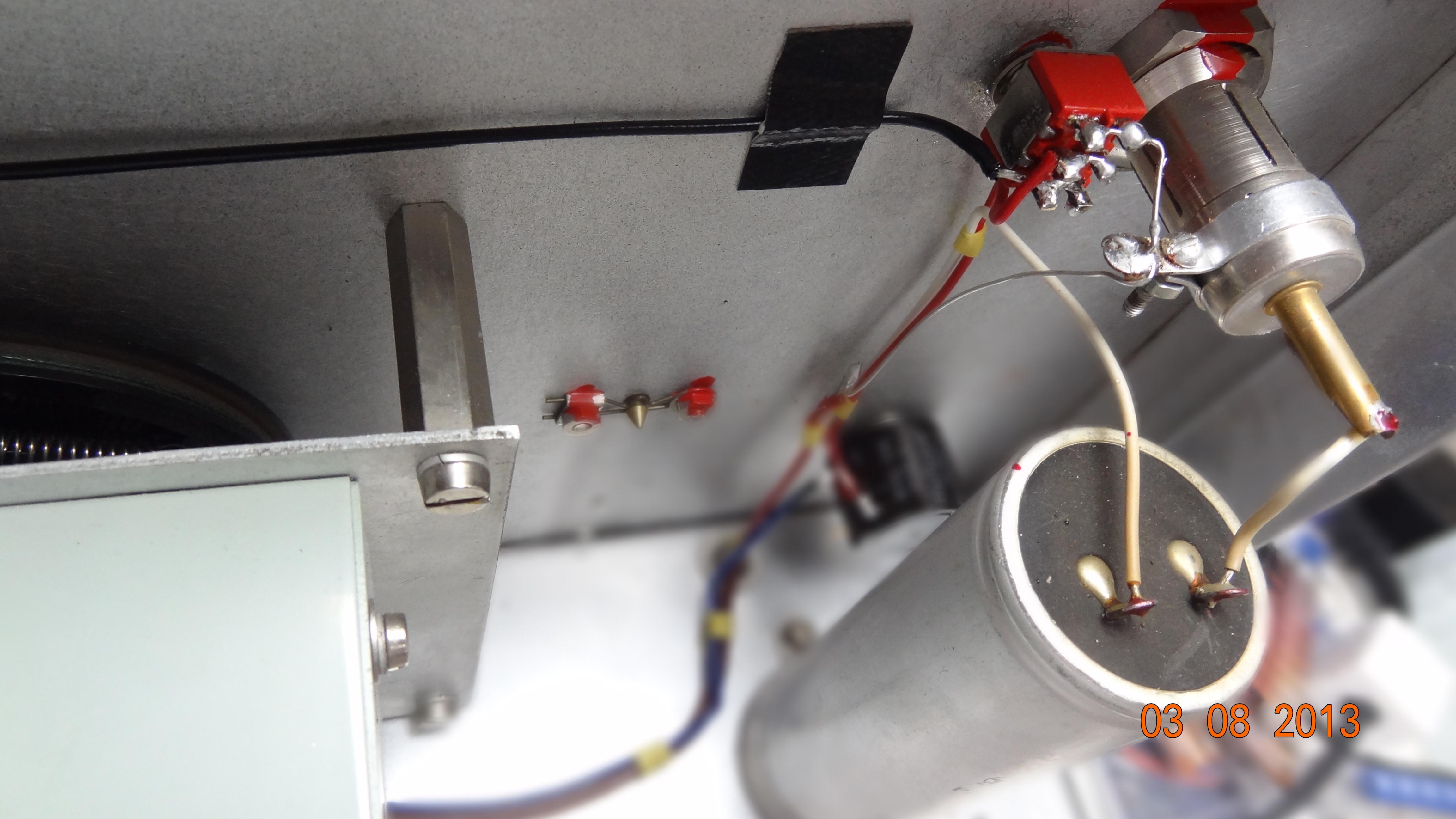

Mod pictures to activate the B&K 1607 Notch filter -

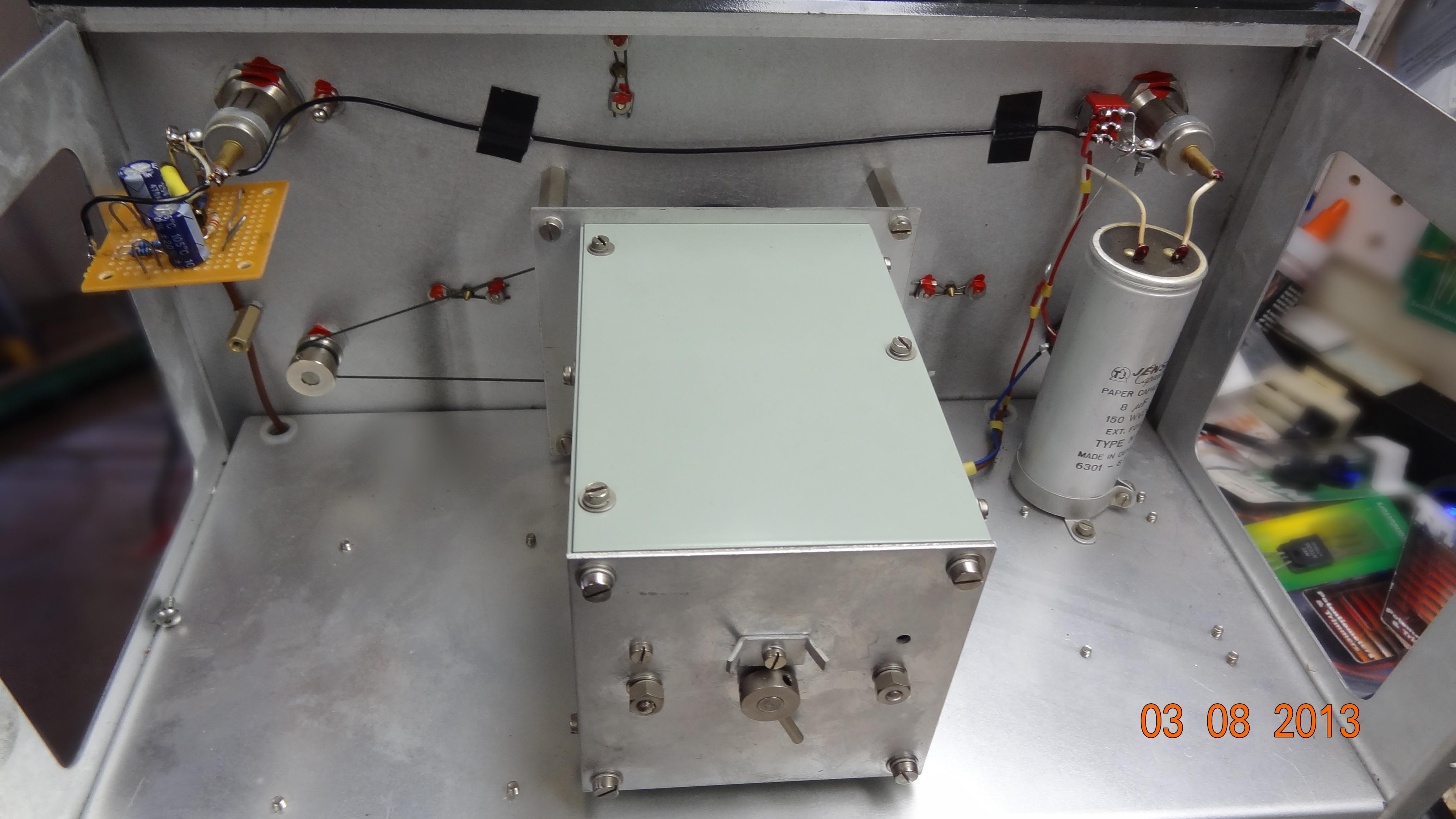

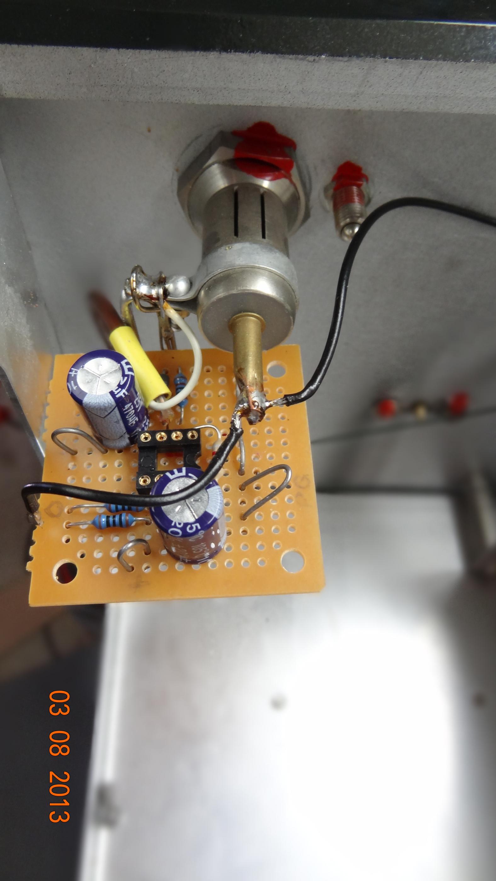

Here is my modification work for the active/passive 1607 notch filter. A 2pdt toggle (double contacts for reliable, good contact) switch to select active mode or passive, a 10 turn Spectrol pot with locking mechical turns indicator, circuit board for the opamp hung off the output socket.... plenty of room for batteries inside/below.
Thank you - ghg for the quick feedback/help which makes everything move along much faster for us all.
-Richard Marsh

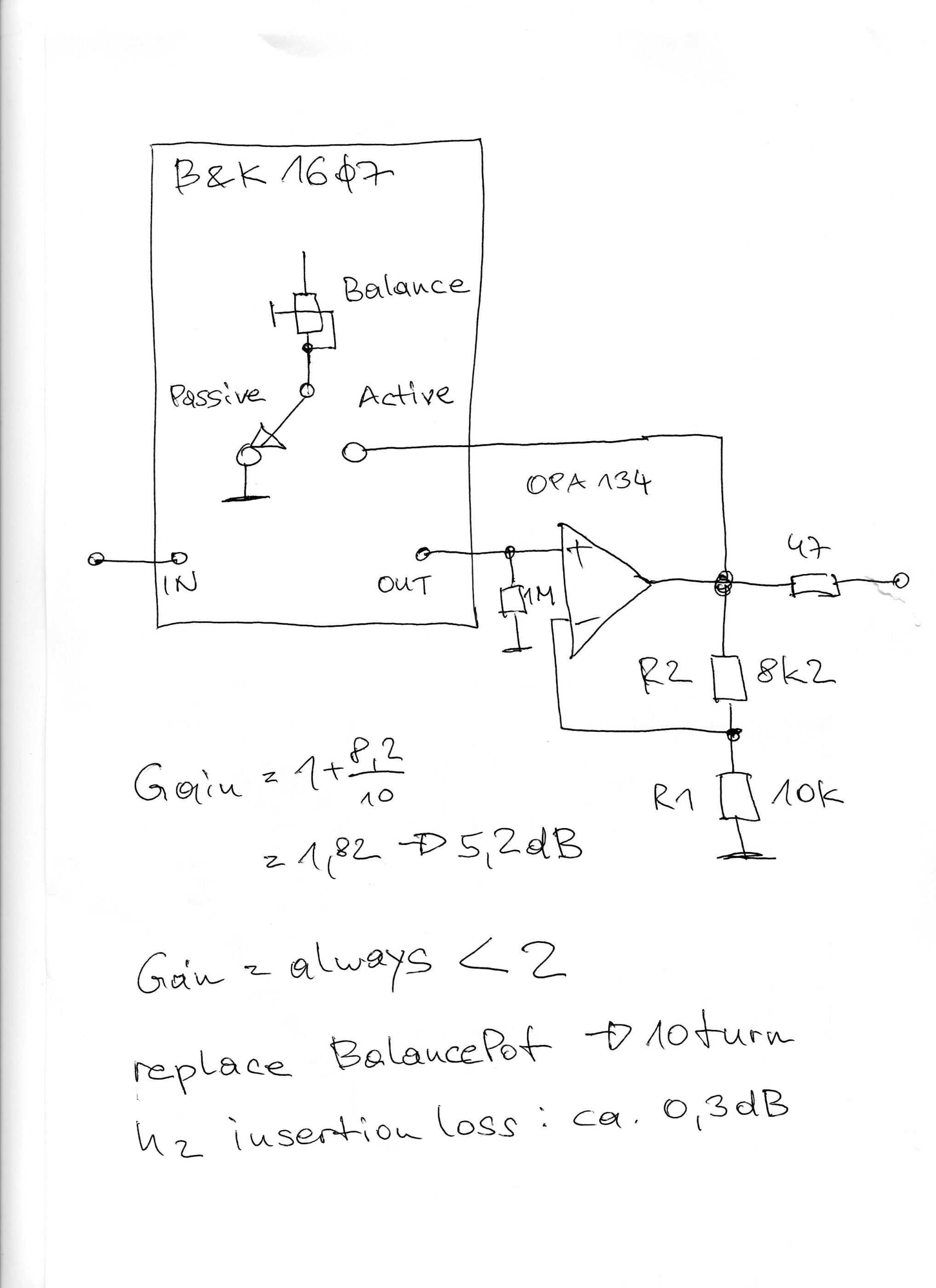

active circuit -
Here is ghg's proof of concept circuit that I then used. I am tempted to use it more often now and the low opamp output Z is helpful in many applications.
The improvement in H2 loss is much better now (only 0.3dB) and helps reduce chance of errors; One less correction to think about or remember.
THX-RNMarsh

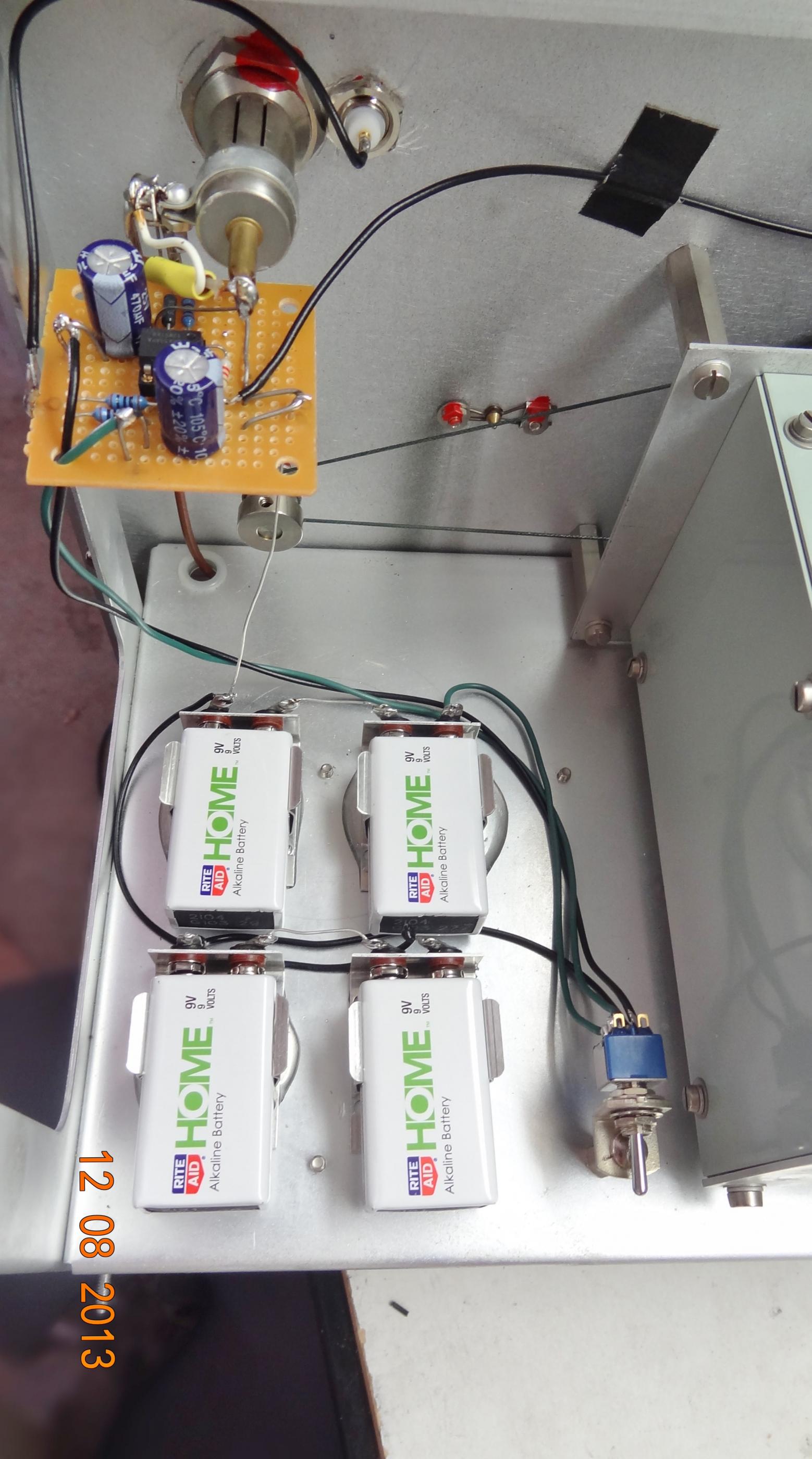

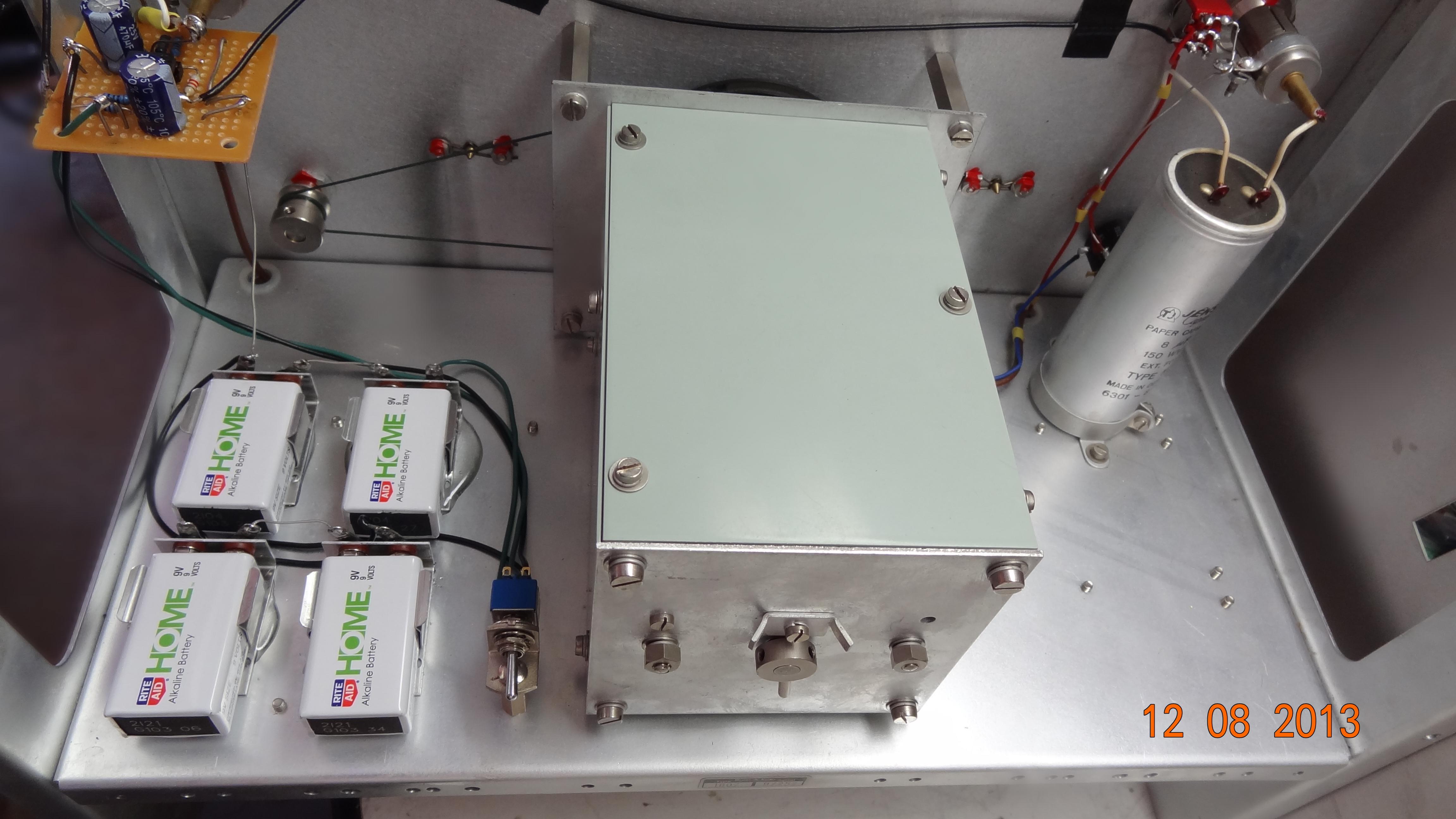

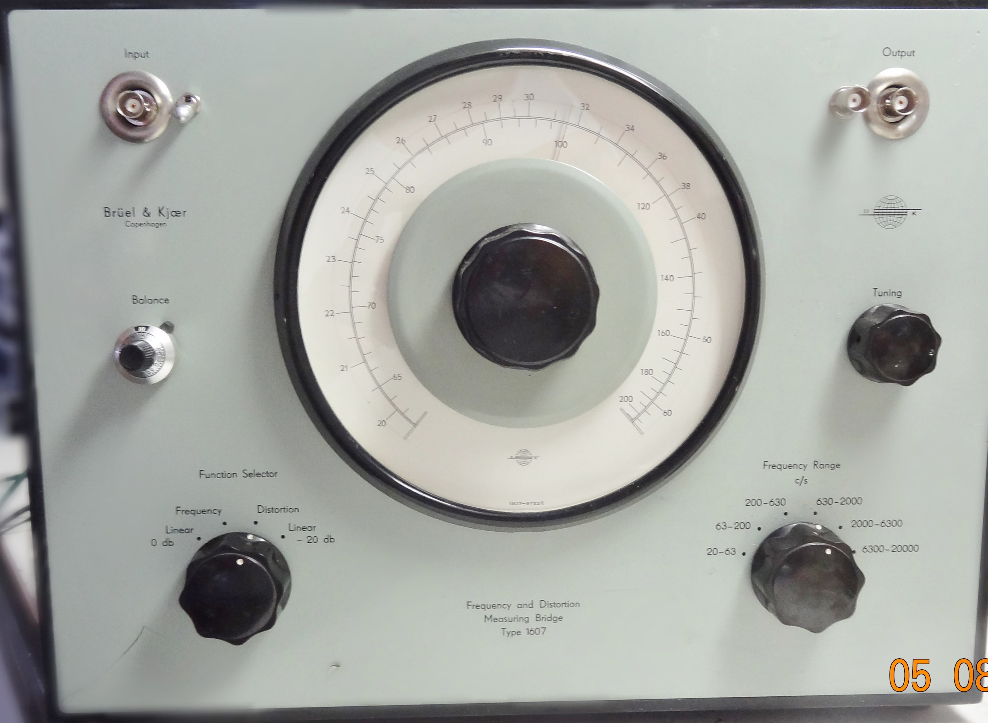

Details on Active 1607 modifications -
Last details on active mod ----> The batteries will be mounted on a removable rear panel for quick access for replacement.
The front shows the location of the passive-active switch, and added BNC active output, and new locking dial for the new ten-turn balance control.
Now it is fully self contained without taking up more work bench space.
Thx-RNMarsh
Done. Check !!
