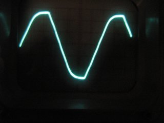

Crest factor (THD distortion) can in some locations be pretty significant.
I lived for a short time on Vancouver island and the power from the plug looked convincingly like a square wave, there was so much flat topping.
I though at first I had made a measurement error, it could not actually look like that? Really!
It resulted in the DC level for B+ being low and the filament RMS voltage being high on vintage tube equipment I had.
Modern day power distribution systems can have a variety of strange loads that cause flat topping. As well huge DC to AC converters for wind, solar and ultra high voltage DC distribution cables tend to have higher levels of THD.
iEEE standard for power systems seems to recommend 5% or less voltage distortion in the power system. This is a lot of flat topping.
The past days of nice SIN waves from clean rotary generators being fed into largely resistive loads are long gone.
Not just flat tops but also straight edges as if drawn with a ruler.
230V "sine" from my wall outlet ...

The 3 measurement effects of that kind of a Power Mains waveform:
You will get One reading of ACV if you use an old style analog VOM. It responds to the Average of one alternation in only one direction.
(Half Wave rectification)
You will get a Different reading of ACV, if you use a VTVM or TVM. Those meters respond to the Peak voltage; usually in one direction only (half wave rectification).
You will get a Third reading of ACV, if you use any True RMS meter. Those meters respond to the integral of the Root Mean Square, over time.
The point is, you get three different answers of VAC, when the waveform is distorted.
But if the Power Mains has a perfect un-distorted sine wave, all 3 types of meters will read exactly the same ACV.

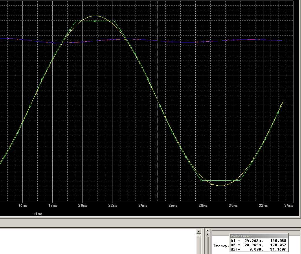

For interest I made up a spice sim of a SINE wave the easily meets the IEEE standard for 5%.
Total THD is 4.1%, well below the required 5% THD maximum.
The third harmonic is below 3% as required and all other harmonics are below 2% as required.
The result is pretty nasty looking yet this is perfectly acceptable power for your neighborhood wall outlet.

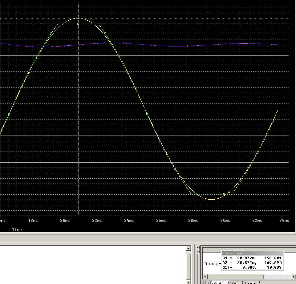

Both wave-forms represent a true 120V RMS as show by spice in the first picture
Note in the second picture the clean 120V has the correct peak voltage of 169V and the nasty one peak is only 158.8V or about 6.5% low.
So you DC supplies will all be about 6.5% low assuming the line voltage is spot on correct RMS voltage.
If the RMS line voltage is a bit low, down goes your DC supplies more yet.
Conclusion....Filament and DC voltage levels in vintage designed power supplies can be crap shoot with today's power lines.
Below is the harmonic makeup.
