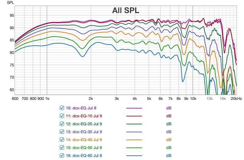

The polar response I got with DCX464 on a cheap taobao horn.
The shape is very similar to RCF HF94 horn and I believe it's a clone to it.
Measured with on axis EQ
The angle might not be very precise since I'm spinning the horn, not the microphone

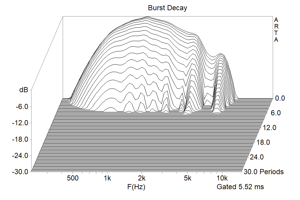

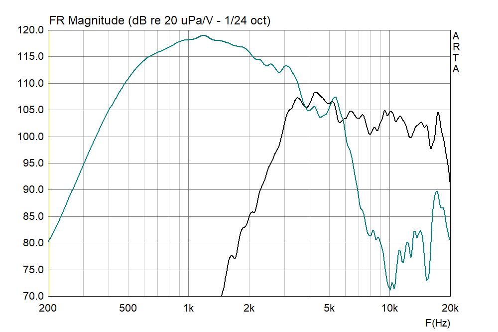

Update: the owner has put the project on ice due to personal reasons, so a more extensive review might never happen. So I'll publish what I got so far.
Mid (green) & high frequency (black) section unfiltered FR / sensitivity measurement @ 4 Vrms = 1 watt @ 16 ohm; SPL scaled to 1m distance; gated, unsmoothed:

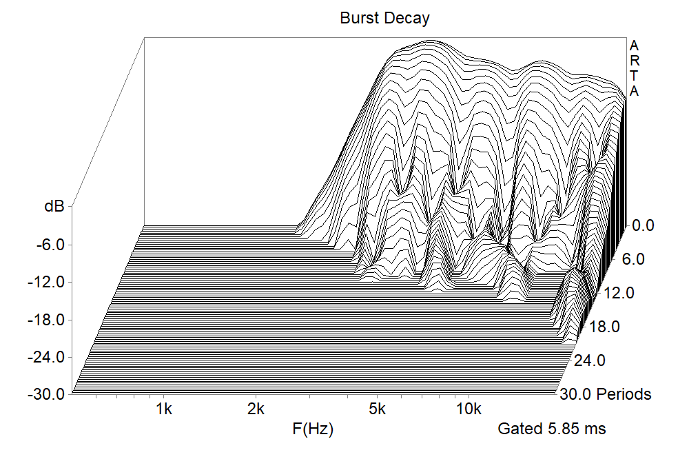

Mid frequency (left) & high frequency (right) section Burst Decay:

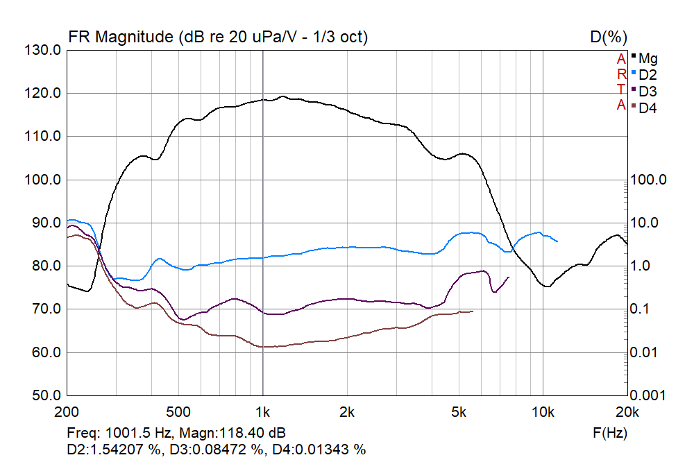

Mid frequency section unfiltered FR & harmonic distortion @ 4 Vrms; scaled to 1m; ungated (ARTA can't gate distortion measurements), 1/3 oct smoothed to flatten out the floor reflexion:

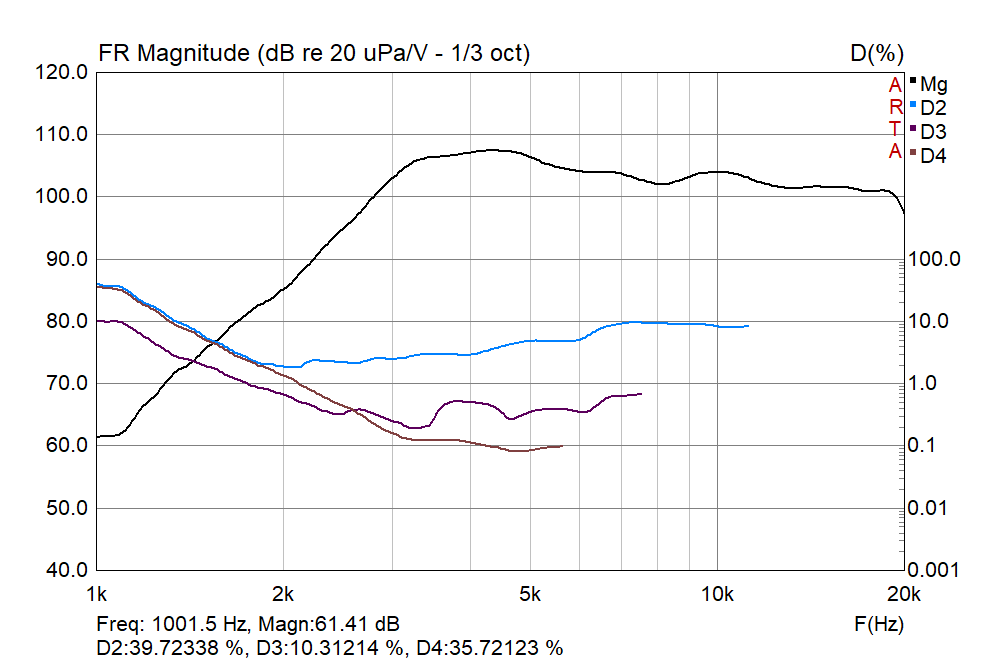

High frequency section unfiltered FR & harmonic distortion @ 4 Vrms; scaled to 1m; ungated, smoothed:

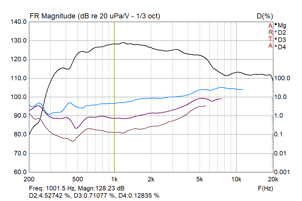

Combined mid & high frequency FR & harmonic distortion (with quick & dirty active XO; no further filtering / EQing) @ 12,65 Vrms = 10 watts @ 16 ohms; scaled to 1m; ungated, smoothed:

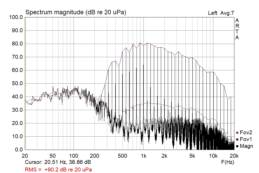

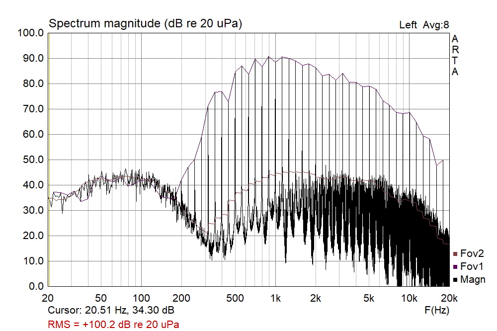

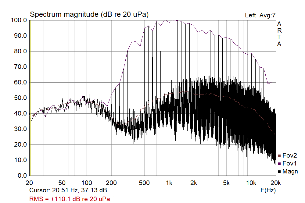

Combined mid & high frequency multitone distortion measurements with EIA-426B output filter at RMS SPLs of left to right 90, 100 and 110 dB (102, 112 and 122 @ 1m); note, environmental noise below ~300 Hz:
Hope the data proved to be interesting / helpful.

For the 10W HD measurement, and the multitone distortion tests, it was a symmetric LR24 XO in DSP at I don't remember which frequency - probably around 4 kHz? No gain adjustment, no linearization, just a quick & dirty XO to be able to measure the unit as a whole.
The owner planned to use B&C's passive XO in his final project, but as I said he'll probably abandon it.

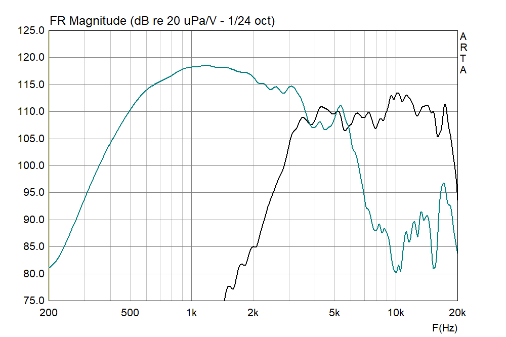

Jesus Christ.. I shouldn't refer to my measurement accuracies when I obviously can't be bothered to load the proper microphone calibration for a given set of measurements. I was already asking myself why the HF section was so quiet, then discovered I had the calibration file of my old ECM-40 loaded.. about 10 dB difference up top to my current EMX-7150.
Here's the correct 4 Vrms = 1w FR unfiltered measurement (scaled to 1m 4pi):

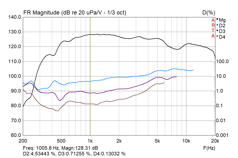

And the 12,65 Vrms = 10w FR & harmonic distortion measurement with XO:
The multitone distortion measurements are unaffected, since those were originally exported with the right calibration file loaded; and the Burst Decay data is also essentially unaffected.
Sorry for any confusion. Again, I now hope the correct data will prove useful.
