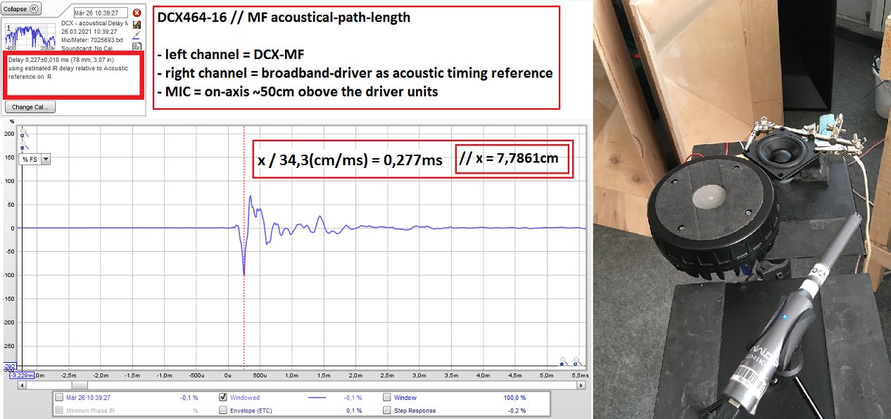

I don't know exactly if anyone has measured this in the meantime (I didn't find anything about it a while ago):dunno:. I have today made a measurement setup to measure the path lenght of the MF mebrane in the DCX.
What was already noted by others - I assume ideal room conditions - 20 degrees at normal humidity. I mean that in my workshop today it also felt like this. But of course I don't know exactly. In addition, the broadband membrane is not flat, of course, I have used a bit of judgment here to bring DCX-Throat and broadband driver in line with each other. Nevertheless, a good starting point for future simulations in Unity or Synergy. (HF shorted)
Kind regards, Christian :rolleyes:

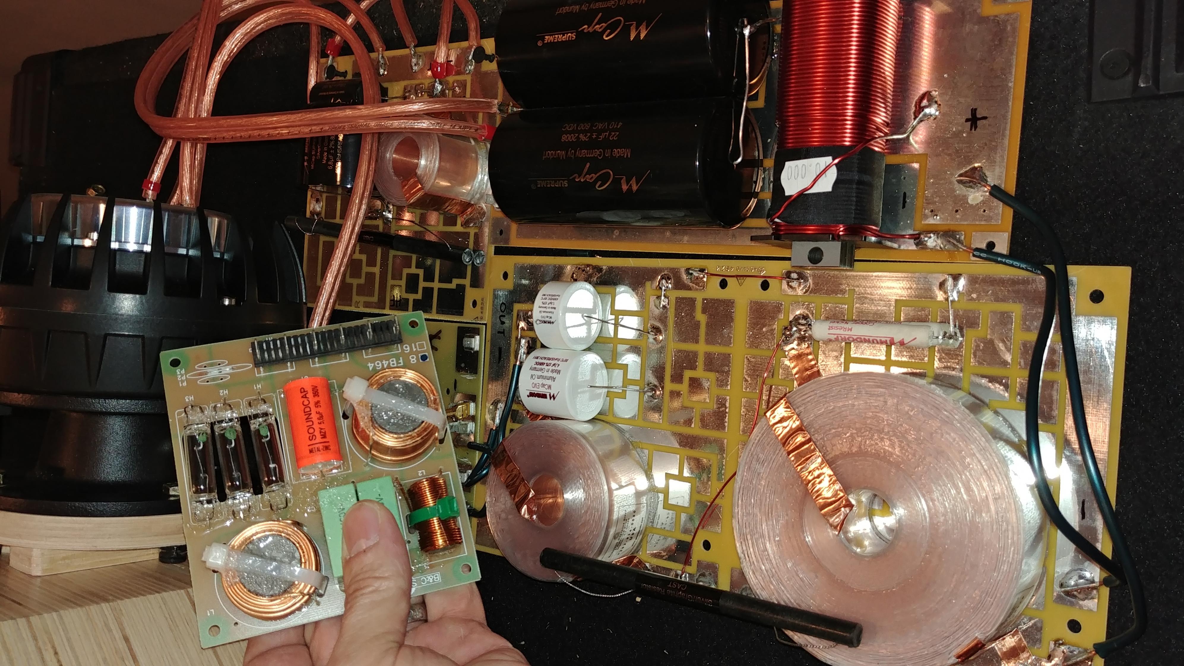

Hello guys! I sent the 464 to Joseph Crow and he designed a crossover with his 300hz horns. I must say he did a great job! worth every penny. I did end up with a huge crossover compared to the 'OEM' FB464! To A/B them is not fair because the filters that Joseph put in flattened out the response so much so that my DSP (MiniDSP) had little work to do. Good job Joseph. I am now using some Mundorf Supremes and better in the FB464 configuration and see if the DSP can 'fix' the stock crossover. Then A/B it. Its all about 'fun'!!

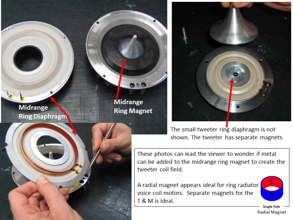

wekterstys ... I agree.... two separate magnets are necessary for the best coaxial performance. I'll keep searching for "radial magnets" being used with ring radiator tweeters. Large NdFeB radial magnets are too expensive for woof-mid speakers, but could reduce the distances in coaxial ring-radiator compression drivers, which might improve phase plug placement and shape.
Do you have a photo of the "Neodymium inside slug" of 2.14T flux density for the HF unit" B&C photos of "HF repair" does not show the tweeter motor.

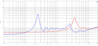

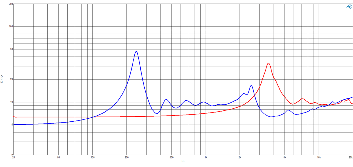

Would a copper shorting ring on the midrange motor raise the crossover freq and smooth break-up?
Hey LineSource, it wouldn't help much - and would take up space in the gap, reducing flux for the rest of the driver's bandwidth and adding cost. The part you have circled is not the magnetic gap, FYI, but where the MF energy leaves (and then passes through our MF filter, to avoid reflections from HF energy going down and returning back up the MF path). You can see in the LF impedance that inductance doesn't really start to raise the impedance until after 5 kHz, and the MF driver should be crossed over below that anyway. The frequency response falls off very quickly starting around 6kHz. The HF driver is useful down much further and the design expectation was for a crossover somewhere between 3-4kHz.
That same MF filter I mentioned is the reason that the energy falls off so quickly after 6kHz, and it keeps the HF energy smooth in that same frequency region by increasing the radiation impedance seen by the HF energy into the MF path. If you look at our DCM414 (the midrange only version of this driver), you'll see more typical smoothly rolling off HF response since that driver doesn't incorporate this filter.
For more details consider our paper here: http://www.aes.org/e-lib/browse.cfm?elib=21525
