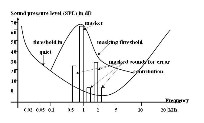

There is a masking effect in our hearing; they take advantage of it in data compression for MP3 etc. The tones that are masked don't need to reproduced and can be discarded - less data to record ... in terms of distortion it matters how close it is to the main signal and at what frequency the distortion occurs. i.e. second harmonics are more easily masked than others.

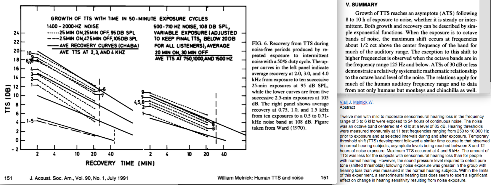

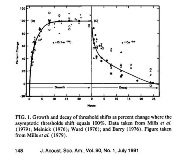

While conducting the HF driver tests, I thought that the distortion at high levels sounded quite horrible, though in retrospect, seems most of the discomfort was in my own hearing response- there is a fairly hard SPL limit in the upper range that sounds bad whether clean or distorted when my ears are “fresh”.
The “too bright” sensation at louder levels which seems contrary to the equal loudness contours that flatten out with increased SPL may be due to the manner in which hearing TTS (temporary threshold shift) occurs.
TTS is the reduced sensitivity to noise after exposure to loud noise, it’s temporary effect diminishes after time in a quiet environment.
Evidence of TTS is apparent when you get into your car the morning after coming home from a loud concert the night before, then must turn the stereo down to half the level that seemed “normal” the night before.
William Melnick has presented some evidence that indicates TTS is less when exposed to loud low frequency <125 Hz than higher frequencies.
With loud music played back with a low frequency “haystack” of +10 dB or more below 125Hz, the TTS threshold won’t “kick in” as hard, fast or with as deep of a reduction as it would from the same SPL at high frequencies. As SPL increases, TTS reduces sensitivity to the HF, but at some point your threshold of pain (or annoyance) is reached, and you will desire protection from the offensive “too bright” high frequencies.
Looking at Melnick’s charts, we see as much as 20dB shifts from 95 dB SPL of 1.4-2kHz noise, while increasing the level to 108 dB with 500-710Hz noise reduces TTS to about 10dB. The range at which TTS between subjects is also quite a lot, “too loud” is very subjective.
The decay time from TTS can be as much as 24 hours, it can be quite a while before your hearing normalizes after exposure to loud music or noise, what sounded good (or bad..) yesterday might be quite different after a break, and at a different level.
