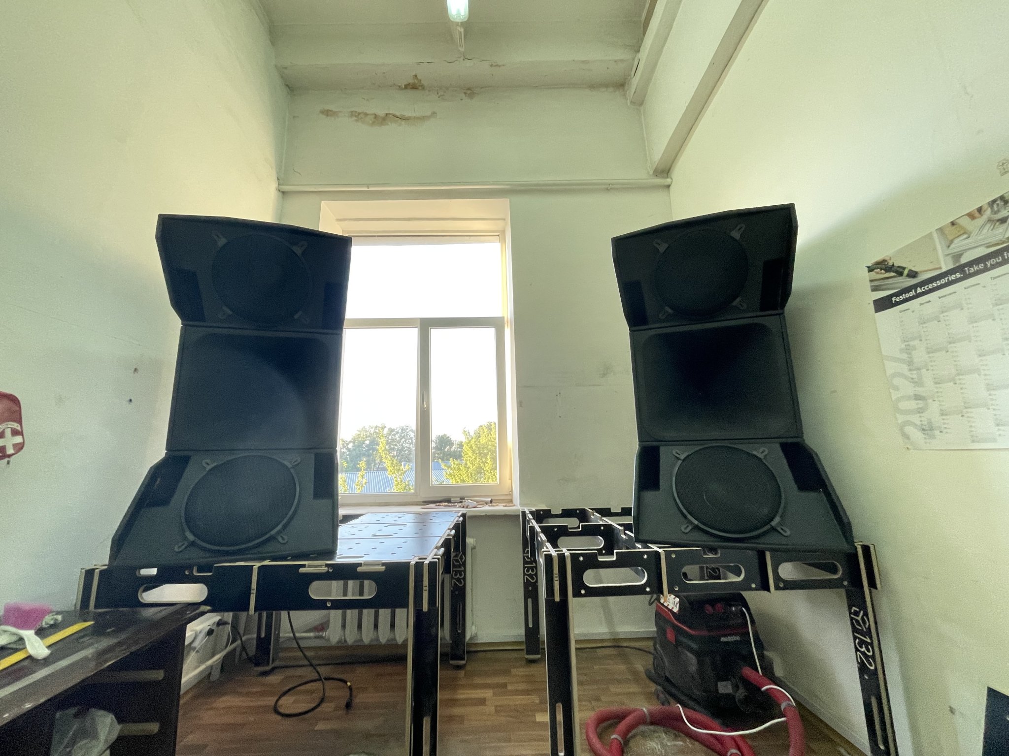

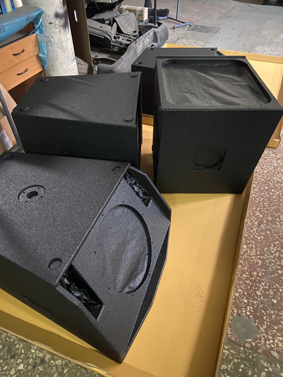

Yes, I have build this design, but with some modifications, split to modules and a bit more bracing. Painted with Line-X polyurea.

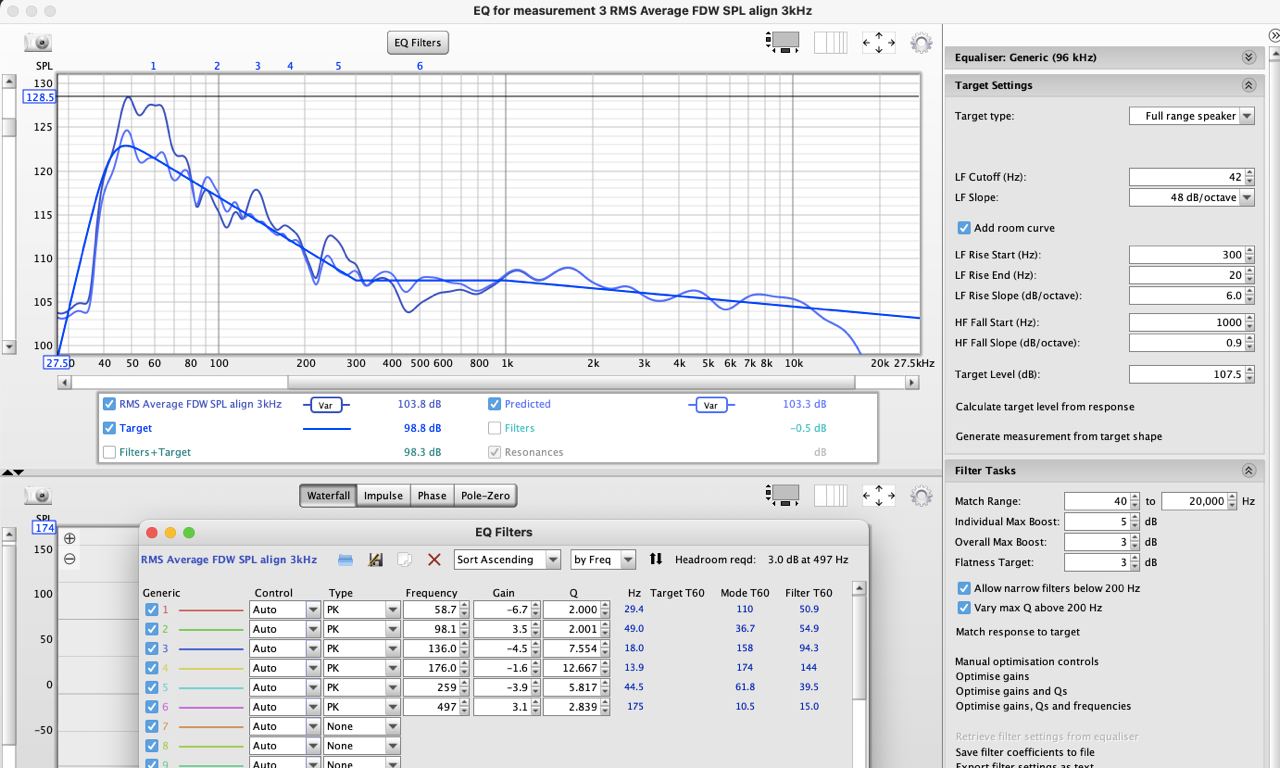

I listening them in my workshop (on the previous photo) with bare walls and notice that they sound good enough, I guess due to well controlled directivity. This build is my first PA system, so I have lack of experience of operating such systems, but AFAIK such system never sound good without EQ-ing for room, fletcher munson curve, crowd density, etc. 215-DCX gives good starting point for that, look at EQ of spatial average in room, low THD at full power of my amps. Also notice that huge 50Hz accent, they are intended to work without subwoofers and they do a lot of chest bump, this underdamping on port frequency present even without +6db PEQ from DSP preset. For me this target curve sounds genre specific, excellent for e.g. techno but questionable with d&b, etc. My amps for woofers are two ICepower 2000AS2, in 20m2 workshop this system (with my EQing) can reach hair shaking, chest vibrating SPL with comfortable and readable mids and highs. This 50Hz bump can be EQ'ed to flat easily, that's what I'm going to do for integrating with subs. Also I would like to have more midbass slap from system, maybe need to play more with target curve and preset.
I guess this bass reflex underdumped alignment is considered bad and boomy for a lot of audiophiles.
Conclusion, they sound good, but I can't witness that I heard they sound excellent yet. I hope I will tune them with subs and more experience to excellent sound.

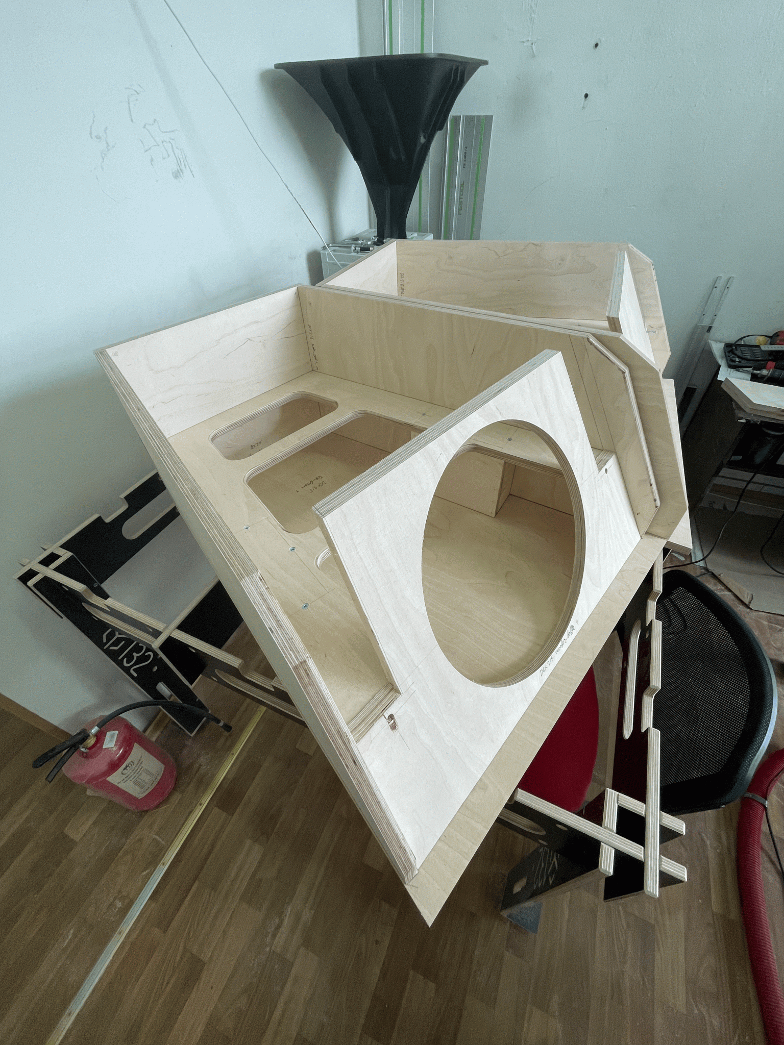

I hope this will help. Baffle is troublemaking part, double angled cut 84.83 and 81.4 degree. My recommendations are:
1) Add few extra mm to edges raw part and fit it in place by adjusting cut step by step. I used disc saw. Plywood is not precise, twisting material to hope fit this part in one step, use given angles as estimate.
2) Strongly recommend to redesign it in some CAD by yourself, there were more pitfalls than baffle question
