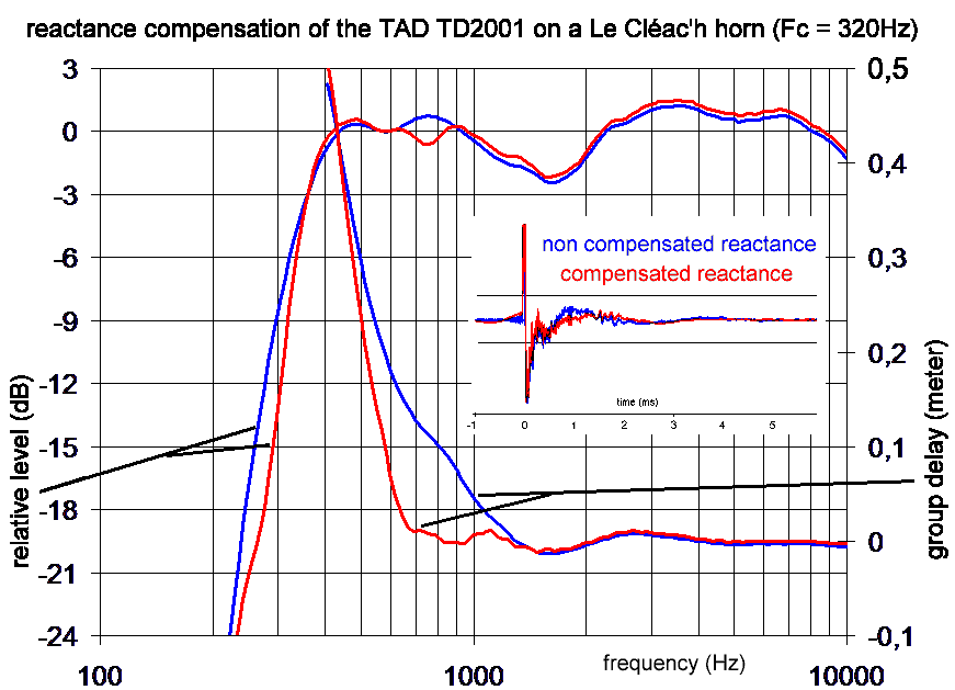

Hello,
Could you, please, give us a pulse reponse of such phase equalized horn.
From my experience, I doubt a classical equalization will improve the group delay of a horn near its cutoff (as generally any equalization increases the group delay inside the interval of frequency inside which it is active).
There is another other way to perform electronically a phase equalization.
You'll find in the attached file an example of linearization of the group delay curve of one of my TAD TD2001 on a Le Cléac'h horn having a Fc = 320Hz. As you can see we can reduce by one octave or so the frequency above which the group delay is constant.
This example was obtained using a summation with a 2 resistors summator of 2 output channels of a DCX2496 digital crossover. I described the method in 2006 on the forum [son-qc] of which I am moderator.
http://fr.groups.yahoo.com/group/son-qc/message/21764
first channel programmation:
(no equalization, no polarity inversion)
high pass filter : Fc= 20Hz
low pass filter : Fc = 20kHz
polarity: normal
phase: 0°
delay: 550 millimeters
second channel programmation:
high pass : Fc= 20Hz
low pass Linkwitz-Riley 48dB/octave Fc = 738Hz, inverted polarity
delay: 0mm
The obtained transfer function for the correction is the one of a high pass filter (Fc = 253Hz) that possess the property of delaying the high frequencies but not the low frequencies.
Best regard from Paris, France
Jean-Michel Le Cléac'h

Eva said:In most cases the group delay of a compression driver mounted on a horn is efectively flattened by applying a parametric eq at the cutoff frequency to tame the main group delay peak (to reduce the Q of the last horn resonant mode and rear chamber resonance) and by applying a 2nd order allpass (phase shifter) to the midrange. Other parametrics may be used to compensate for group delay peaks and dips due to the few lower horn resonant modes. This scheme works very well and results in matched impulse responses and optimum on-axis summing (it also allows to use midrange horns down to the very cutoff point, even if they are undersized and peaky) but the capacitor will spoil it unless it's sized to introduce very little phase shift in the overlapping region.
I can't provide plots for the moment, I can only measure phase (of each driver and the sum) and I use to do most of these adjustments by ear (and comparing polarity flipping), but consider this:
- A parametric EQ with gain results in a group delay peak, which may be used to compensate a dip.
- A parametric EQ with attenuation results in a group delay dip, which may be used to cancel a peak (at the expense of attenuation, since you are really changing the effective Q of the lower cutoff, and you may match it to the group delay of a phase shifter).
Notice the dip in frequency response around 730 Hz, it's the responsible of your basic group delay correction.
Try one (or two, one "wide" and one "narrow") parametric(s) around 400Hz with suitable Q and attenuation and you will be able to flatten the group delay (once again, at the expense of rolling off the frequency response, but this may be corrected later with global equalization on the input signal).
You can use the waveguide down to the cutoff that way (if the compression driver can handle it).

There are a couple of full-horn working systems based on that group delay correction principle, but I don't have any software capable of measuring group delay. My current adjustment criteria is the quality of the null that you get across the crossover region when the wrong polarity is used and the quality of the summing with the right polarity, and impressive improvements result from group delay correction/matching.
Hello Eva,
If the crossover frequency is set quite far above the acoustical cut-off frequency of the horn then a partial electronic compensation of the reactance of the horn is not doubtful. But a complete compensation until frequencies very near of the acoustical cut-off of the horn, with zero group delay is a very doubtful claim for me.
The problem of reactance compensation by electronic means is quite the same problem as reactance annulling by acoustic means (dimensioning of a rear cavity...) most of the time the results are not at the height of the expectation.
Also you have to consider that most time distortion artefacts in horns like reflected energy from mouth to throat results in the pulse response as secondary delayed pulses from the main pulse. By the way theses artefacts are reflected in the response curve most people are thinking they are minimum phase but in reality they are not.
But we are here in the fog and it can only be eliminated by measurements. For me it is easy, using my own Matlab routine, to obtain the group delay curve from a pulse response. Send me the impulses response of the horn systems you mentionned and I'll do it.
Best regards from Paris, France
