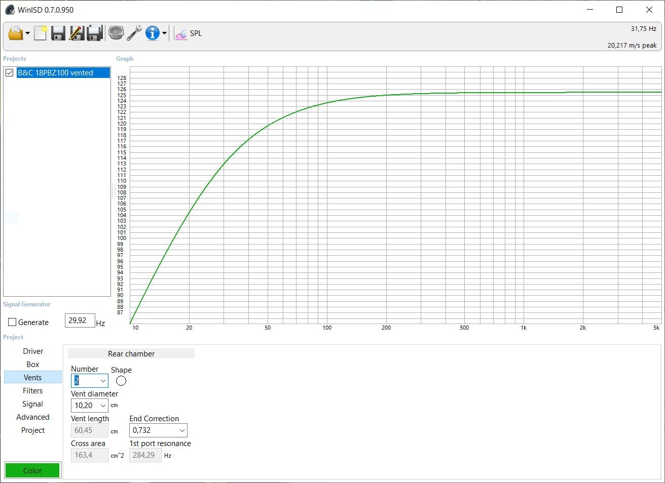

WinISD suggest 80 liter tuned at 30 Hz, and wit ca 800W you'll get +112 db at 30 Hz which i really nice for such a relatively small cab.
You should try to fit 2 x Ø10cm ports (flared if possible) to reduce port noise .... at 2 x 10 cm they need to be +60 cm long, so in a 80 l box probably need to be bended

As for the 18PZB100, in HR it doesn't calc a high GD and minimal vent damping rolls it off further, though of course it doesn't sim an optimum flat response unless 3.5 ohms series resistance is used.
