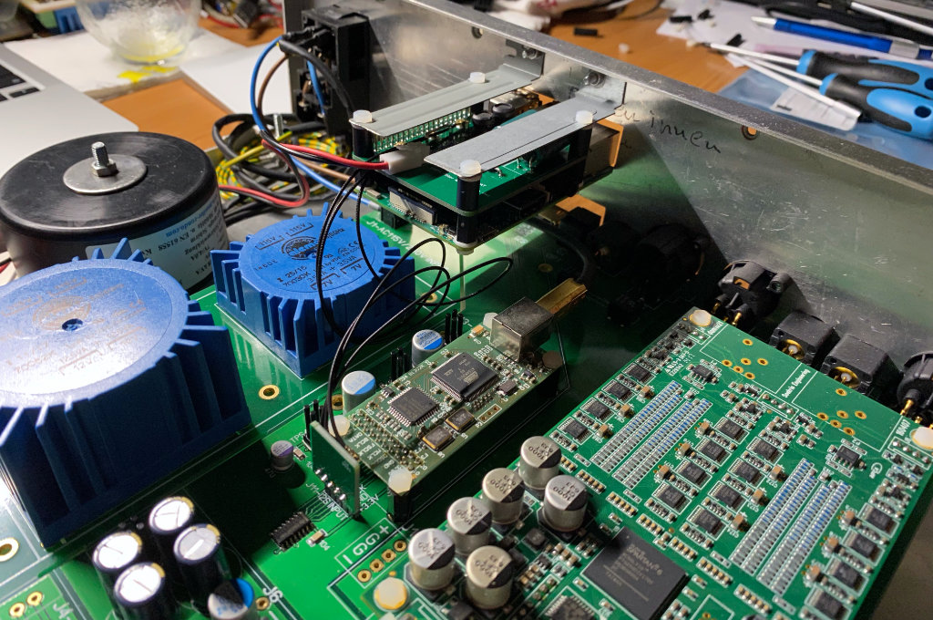

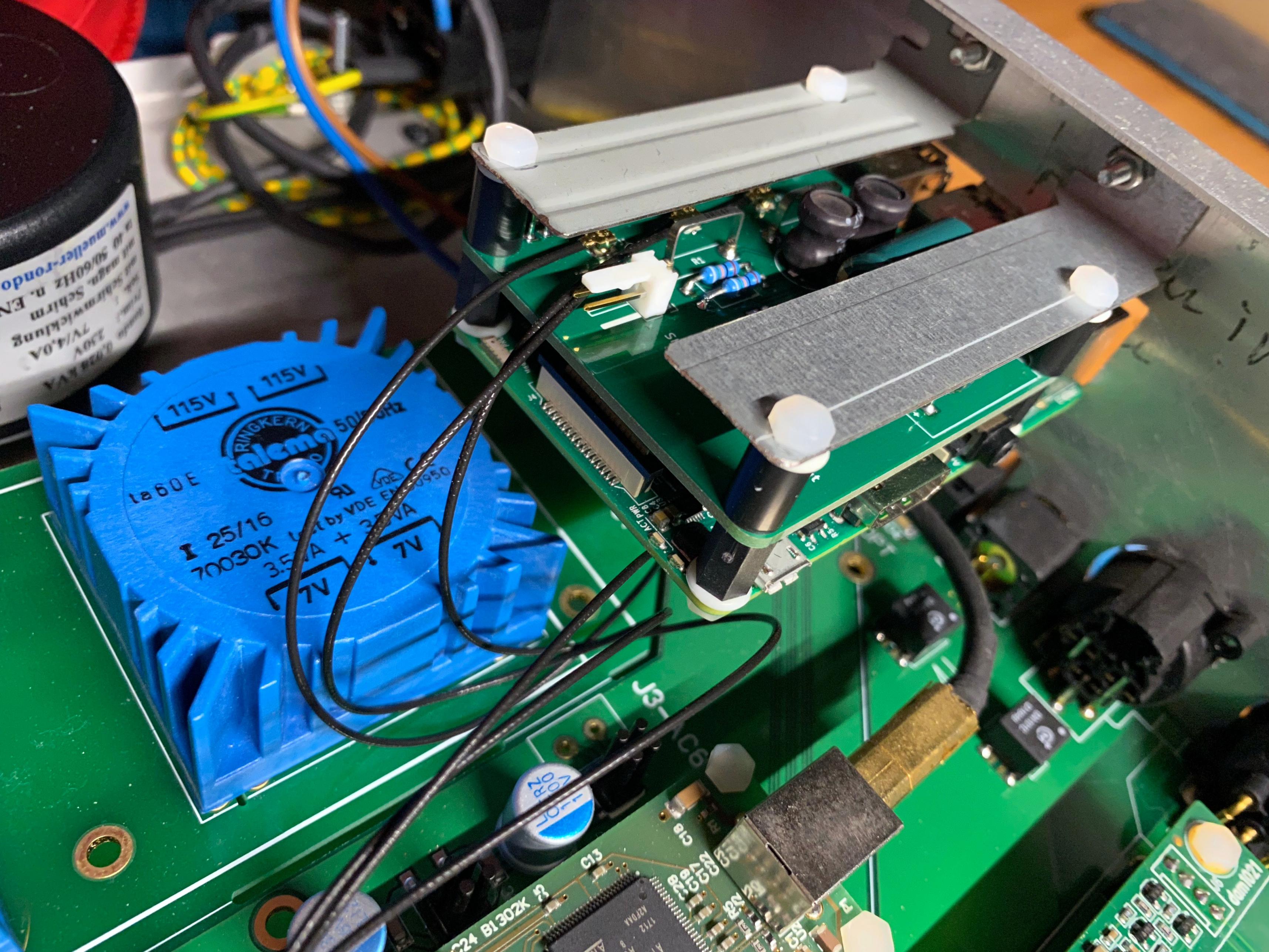

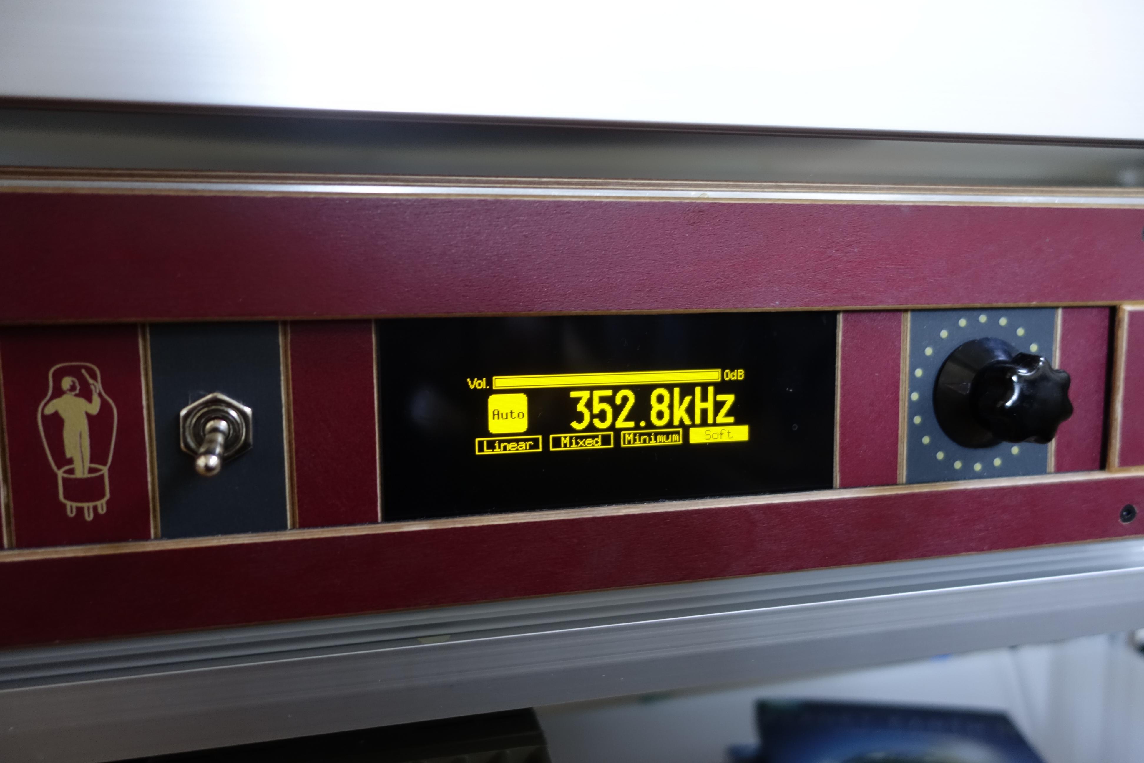

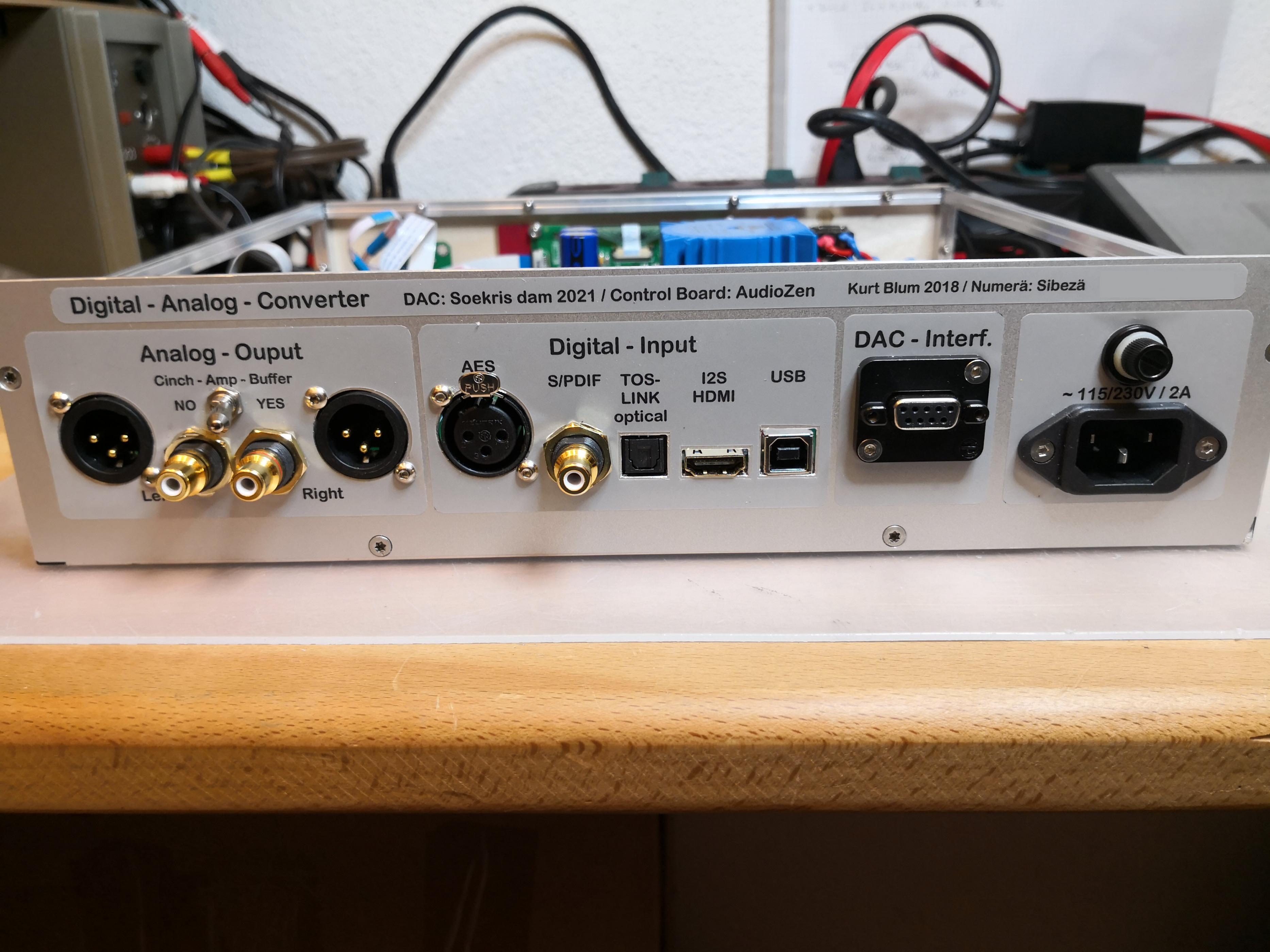

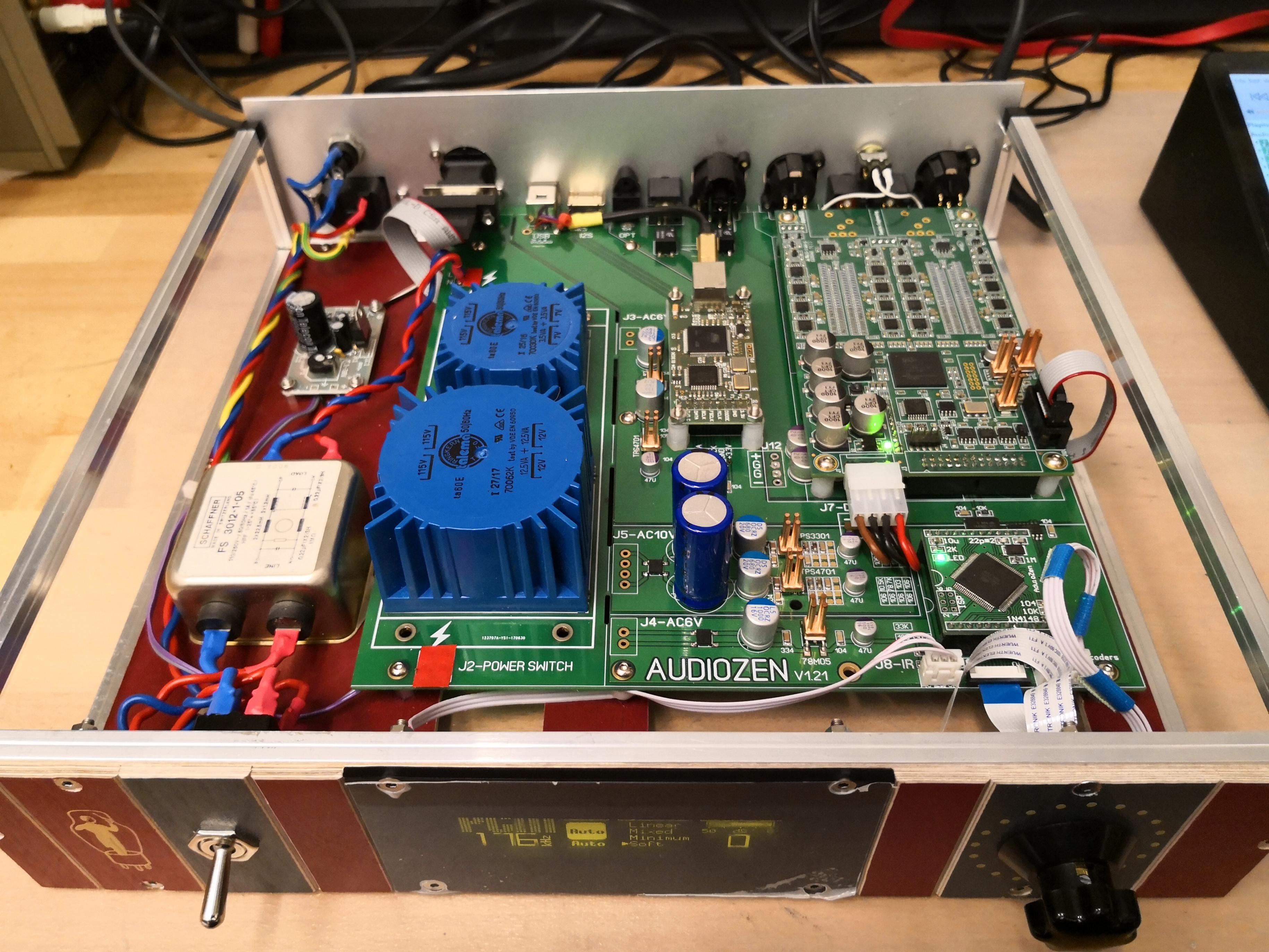

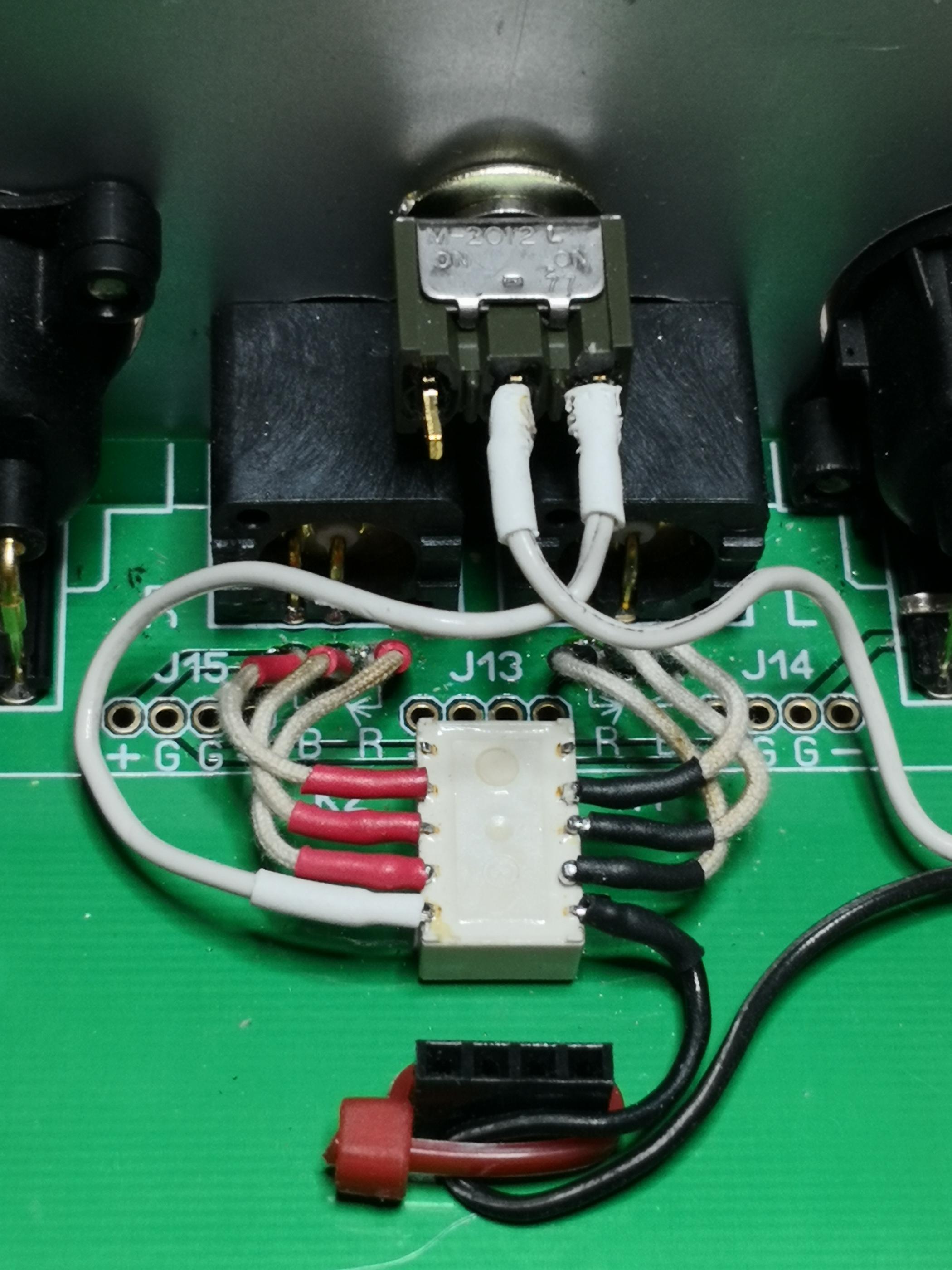

Just my Audiozen and Sokris dam1021 build into a case. I expand the analog audio output with a switch and a relay. So I have the possibility to switch the output with or without buffer easy from the outside, without to open the case.
