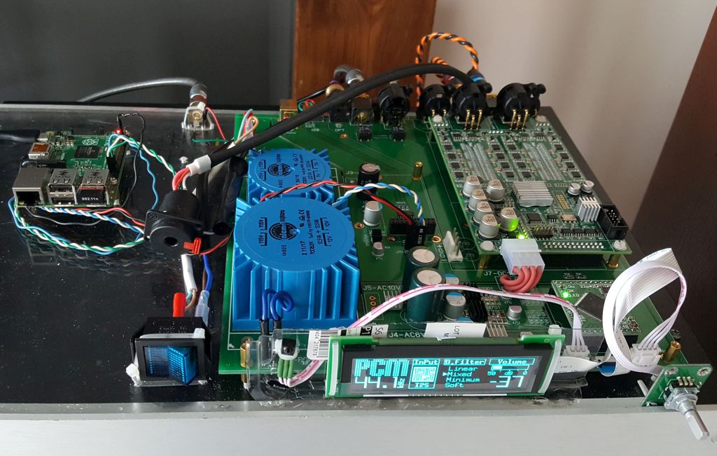

I renew my request. Can you add a hole on the back panel to mount the raspberry Pi.
Your AZ OLED is a great piece of equipment combined with Soekris. Plays great, great service. Great, great thanks !!!
My DAC looks like the picture. Waiting for the house ...

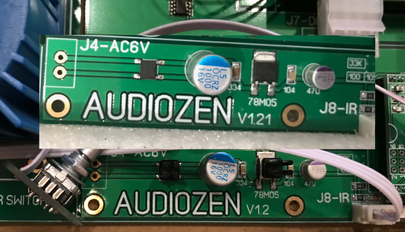

No substantive change. It only modifies the diameter of some weld holes and the leg is easier to install. :)
