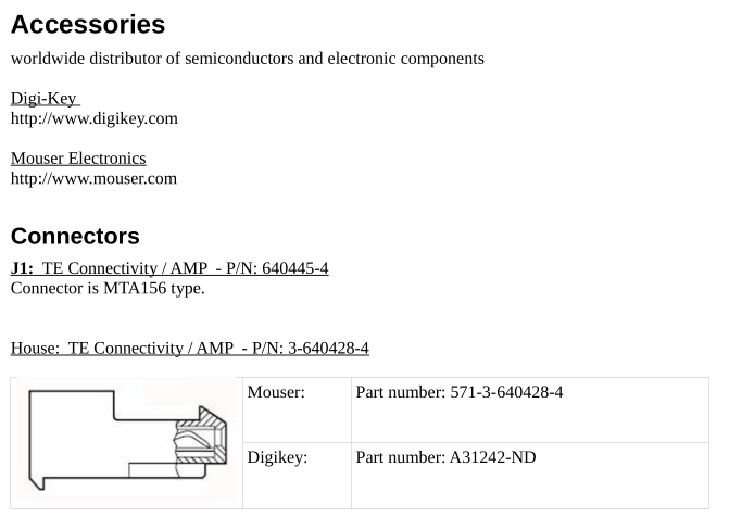

audiozen, do you know what is the part number for the J1 connector you supplied? I accidentally threw away those metal connector inserts/tabs. Thank you!

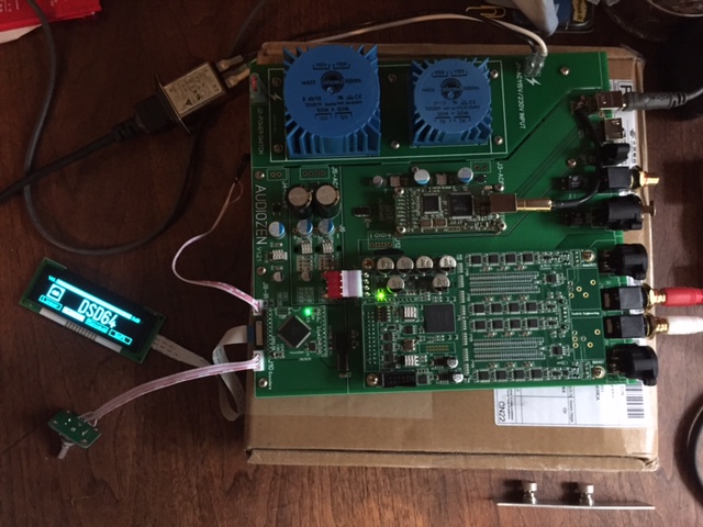

Finally put everything tother (even though still would like to get those tabs in J1) and listened a little bit. I have a question. When jumpers are in buffered mode do RCAs work properly and are connected to + and gnd from XLR? Another one (can't squeeze my fat fingers to switch on a fly), when switch to RAW where does signal go RCA? or it can be taken from J7? I am asking in case I would like to make my own buffer and would like to ted the signal from J7, whats the best way to do so, not connect J7 to the motherboard? Thanks!
Dam1021's GND of XLR and raw are connected.,RCA buff=XLR+/GND,RCA RAW=RAW/GND.
If you use your own buff, you can connect from the J13, and the J13 is the RAW output.

I now have my AZ kit up and running. Works great!
But when I use my Apple remote with it, most of the remote buttons just cycle through the inputs, and the others do nothing. I can't change filters or the display, or adjust the volume. Is this an issue with the remote, or with how I have the sensor wired? Should I get a different remote?

please use manual in post #55 Page 9 and 10 to setup IR-control

Thank you all. Most of the IR remote controls are compatible. Press and hold down the encoder and then turn on the power to access the remote settings program.

J1,part number :571-624091 @mouser.com
I think it's good for you to weld directly.
I meant that one (female part of it) 🙂:
