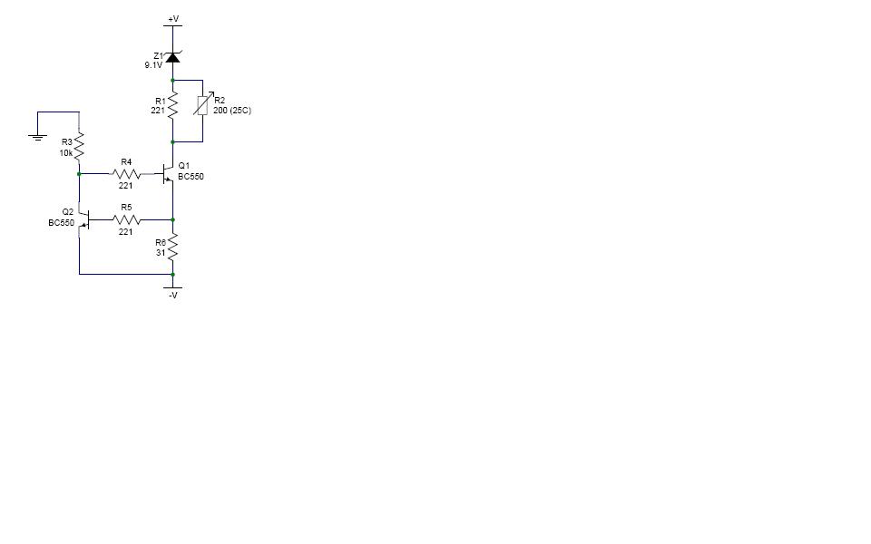

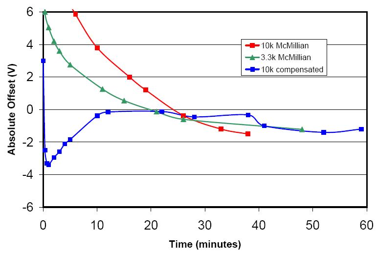

wuffwaff said:2. play with some NTC´s in the current source for the diff pair to change the absolute offset behaviour
I couldn't resist this opening.
This simple circuit compensates for all manner of temperature drift in the Aleph-X and it is easy to plug into the HiFiZen board. The control voltage is at the collector of transistor Q1. R1 parallel to the NTC thermistor, R2, linearizes the response of R2.
Jeremy
How does it work? Pretty well. For the best results, the thermistor should be in good thermal contact with the heatsinks.
Some tweaking is certainly necessary to temperature compensate your particular amplifier. Adjusting the CCS current via R6 or the linearization resistor R1 will adjust the range and magnitude of the response. The usual differential pair CCS adjustments can then be used to adjust the absolute offset after the amplifier is fully warmed up.
You may have some motorboating problems during a soft start, so be careful and don't blow your speakers.
Jeremy
Jeremy
