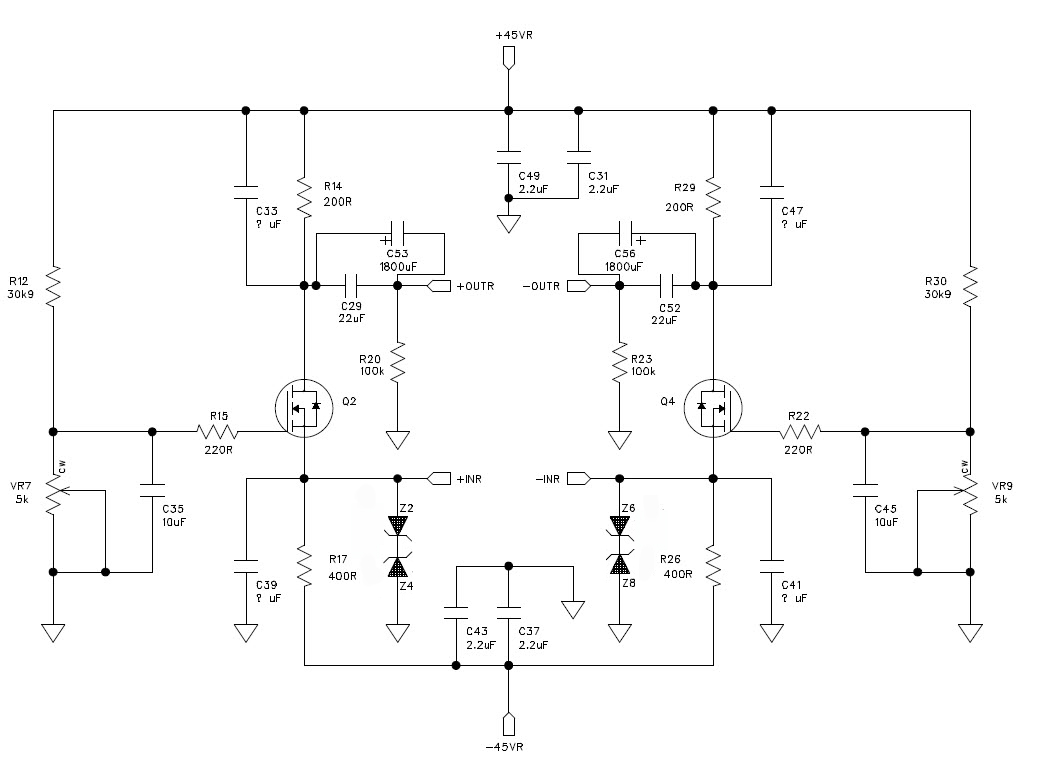

Sorry, in my application the new AVCC 2.1 does not sound as good as the old version.
I lose much musicality and much resolution of the higher frequencies.
The Buffalo III have lost all its attributes who I love on it.
The I/V stage that I use is the balanced single ended FET version from this thread:
http://www.diyaudio.com/forums/digital-line-level/154866-new-take-classic-pass-labs-d1-ess-dac-159.html
Changing the plugged AVCC to the old version solved the problem an all was fine.🙂
I know my DAC and his good sound for a long time and now I know how important the AVCC board for the sound performance is.

Because the other users are happy with the new version, I am looking now for a mistake in my DAC.
Which voltage on each output of the Buffalo board should I adjust with the trimmers of the IV-Stage? Pleease see my attachment.
I have heard half of the AVCC supply voltage is the best choice.
Now I use the Buffalo board with a static voltage of 1,7V on each of the four Output-Pins
Is 1,7V ok?
Is 1,7V ok?
1.7V is fine. 0V is also fine. 🙂 Performance in this regard really depends more on the I/V stage than the DAC itself.

I think it is the rest off your system. The new AVCC is without faults. Your system perform better with the fault.
