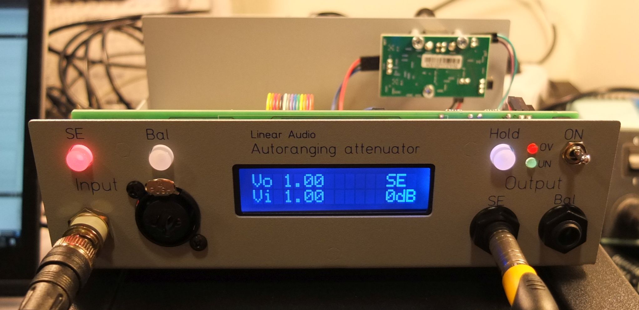

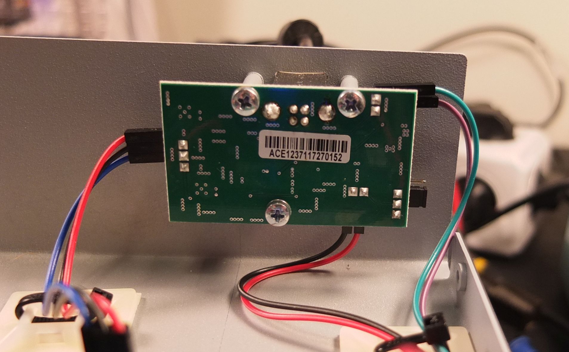

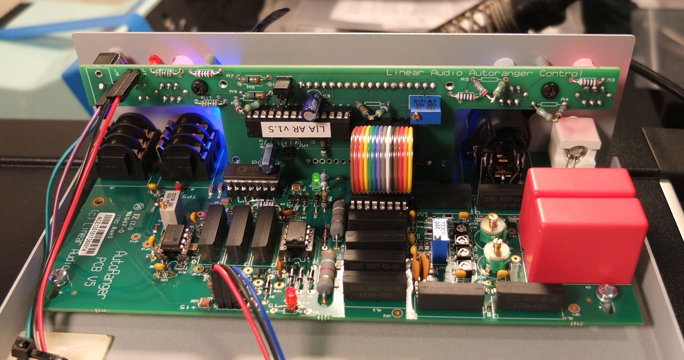

I've finished my build as well. Working nice!
I added some pictures too with power supply wiring done with red(+)/black(gnd)/blue(-), so perhaps of help for some who's yet to do the build. Also marked the C27 where pinout needs the use of outer holes olny and the latest change of C6->360pF

First results with the modified PIC software.
#1 SE-Mode, 1V out:
V2b: At 1,00Vrms (1.2kHz) input voltage the AR is cycling from -4dB to +4dB in an infinite loop. I have probed PIN1 and PIN6 of the AD536A and the input voltage cycles between 0,87Vpk and 2,26Vpk. The DC output voltage cycles between 0,653V and 1,522V. The voltage at PIN24 of th PIC is also clean, no transients or spurrs.
V1b: the same.
original: the same.
#2 In SE-Mode with 0.4V out: same, but lower output voltage.
#3 In Bal-Mode, 1V out: same as SE-Mode.
any advice?
EDIT: I just noticed, that probing at PIN4 of the AD536A to GND with x1 scope probes repeatable solves the issue.
#1 SE-Mode, 1V out:
V1b: the same.
original: the same.
any advice?
once again:
# Resoldered C20.
# x1 probe on PIN4 and the AR settles immediately, but the displayed levels are wrong.
# x10 Probe on PIN4 and the AR occasionally settles and the levels are ok.
# Resoldered C20.
