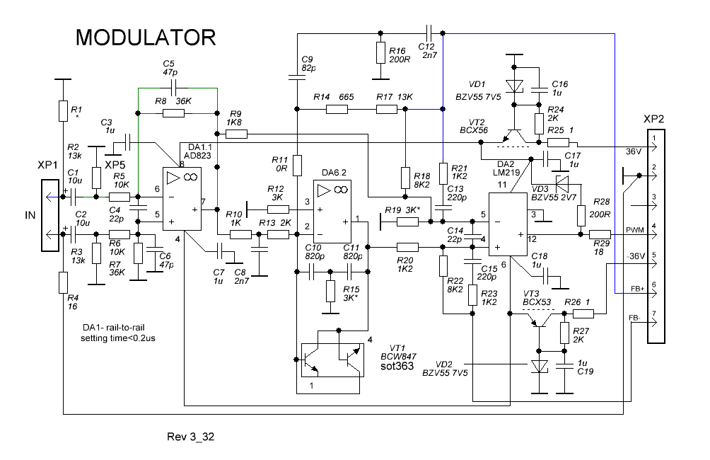

In my design i've AD8561 but simpler filter and without RC at the IRS input, output carrier is noisy.

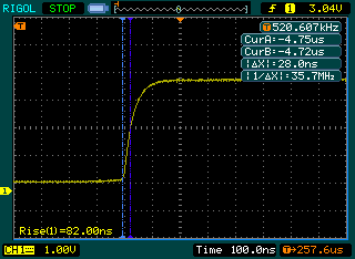

What is the frequency in such a comparator?
The input resistor at IRS was written in a old post in this forum, as a possible solution for bad S/N with high speed oscillation frequency.
In my case i've 400kHz, but giants mosfets (pair of IRFP4227 + Zetex 9A buffer).

The 330ohm input resistor to IRS was mandatory.
The 47pF from pin3 to gnd help me improve S/N after some tweaks.

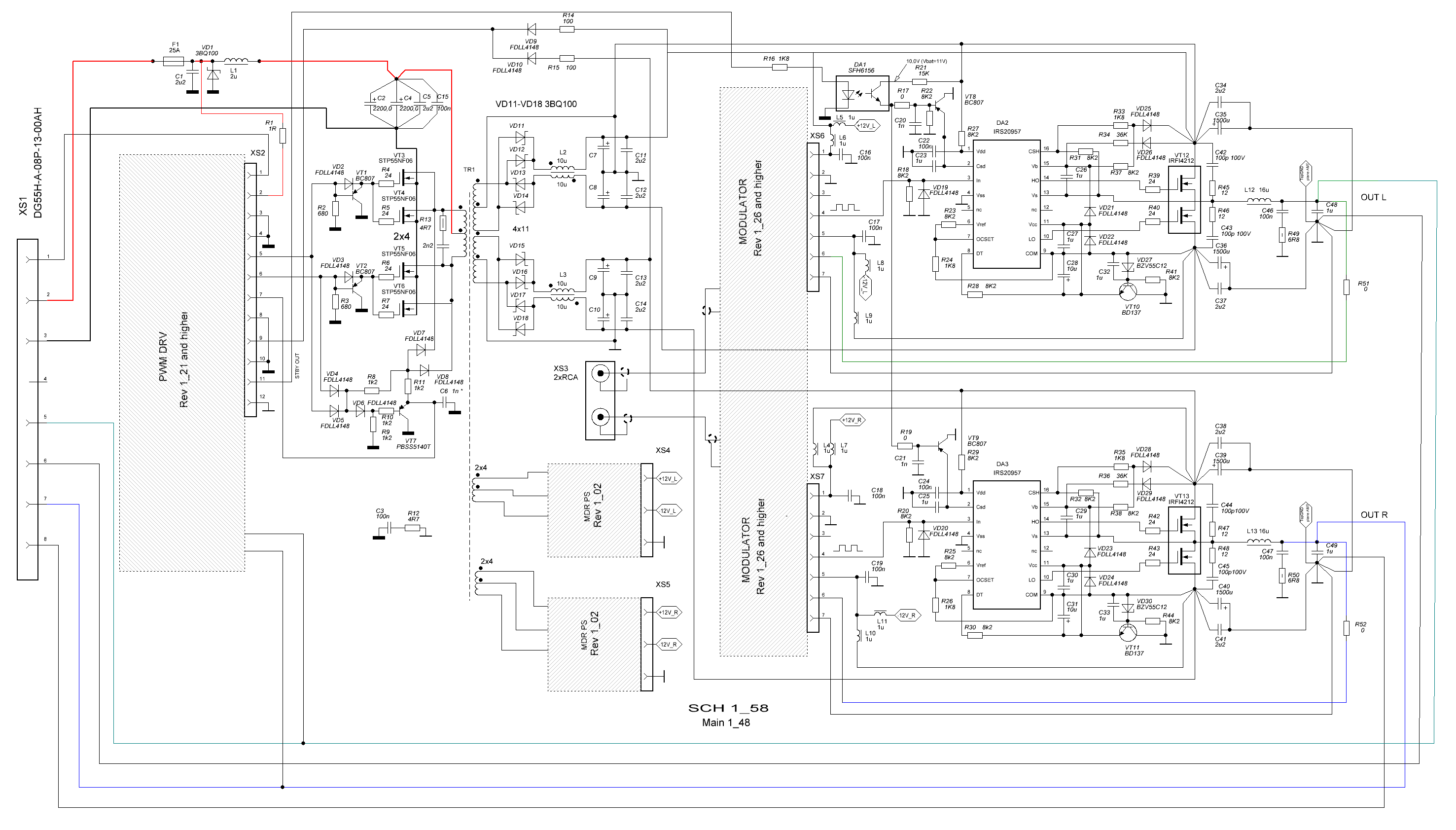

Design was a standard UCD like the Philips AppNote, but with integrated circuits (differential opamp for input buffer + AD8561 + IRS + buffer + mosfet).

Good work. This has a lot in common to something I did a few years ago. Reasonably clean.
Output capacitor has inductance, output inductor has capacitance. This introduces one or more zeros in the response of the filter (attenuation ceases past ~1Mhz).
In fact this is good to some point for 2 reasons: Dimensioned properly it can do some "carrier suck-out" and reduce switching frequency drop near clipping and thus distortion. Also, it boosts HF component of feedback signal and allows longer traces from output filter to modulator. But then the boosted HF (and any picked up noise) need to go through one pole to level HF and attenuate picked up noise in the process. This is specially important with fast comparators. The 22pf capacitor from compatarot IN+ to IN- does this job. Slow comparators have a lower pole built-in.
There is one more potential issue: Comparator bounce. The trick is to arrange traces and parasitic capacitances from OUT+ (and OUT- when available) to IN- and IN+ in such a way that there is slightly more HF positive feedback, this results in clean output transients. Too much positive or negative feedback through parasitic capacitances and distortion and noise increase due to inaccuracy.
There is a circuit that can be used to suppress comparator bounce when many channels are put together with a SMPS and environment is noisier than desirable: A zero latency filter. It can be made with a single 74LVC1G0832 gate, two resistors, two capacitors and two diodes. A ZLF detects the rising and falling edges at input and holds output at that level for some time, masking subsequent bounce for some time after first edge. Masking has to be long enough to mask FET switching time, but not long enough to force to be longer the shortest pulse produced by modulator (which is at least two times propagation delay).

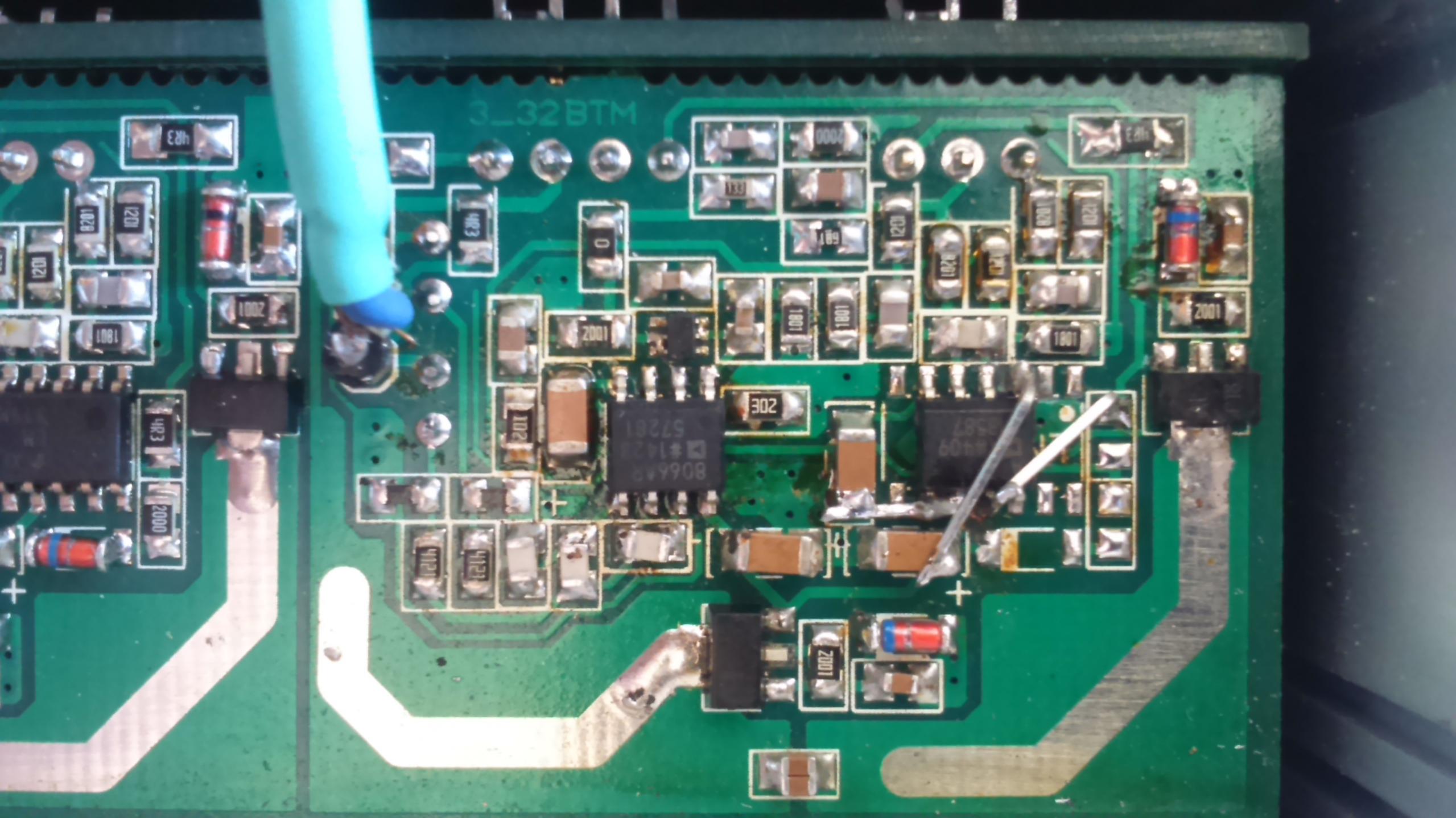

have long known that in this case important thing is correct PCB layout.

I just put this in spice, this seems SUPERIOR design to all what I have seen so far !!!
How you came across this method anyway? This may have even better THD results then "ucd hypex" !! Thd in my spice setup for this is 0,001 % for the same setup compared to 0,1 % for original UCD !!!!

This modulator works well up to 100W.

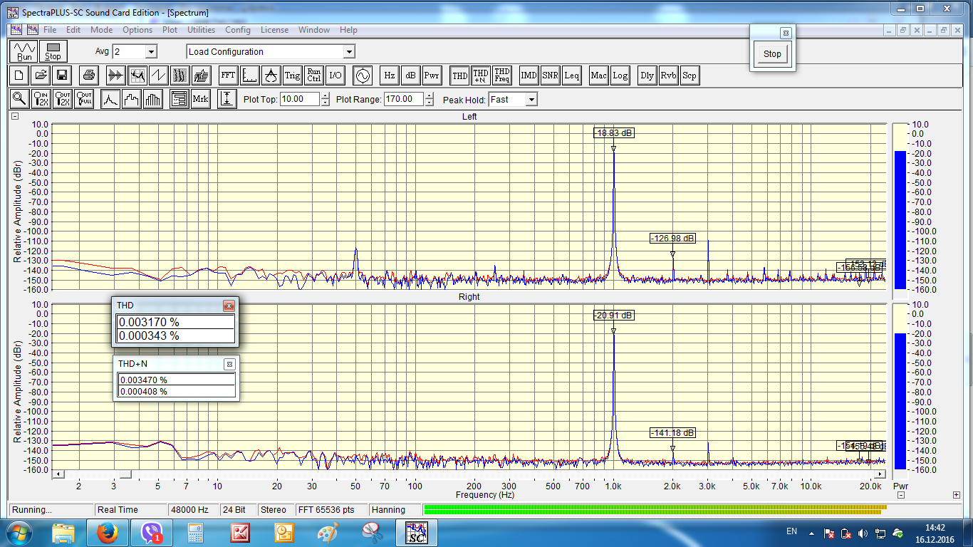

Unfortunately, the real amp shows worse results than 0.001% THD, (see atach.)
At the bottom of the real car amplifier measurements, power - 13 volts.
The load is 3.3 ohms. 15 W 1 kHz, and the sweep of the frequency at 10W
(Worst-channel amplifier, best-DAC-ADC only)

I just put this in spice, and it seems to be unstable when output signal is at 75% of Vcc, maybe we can repair this ?! I have seen this method in some paper, can not recall where: But here THD rises as frequency increases but it is always below UCD original. My simulation shows 0,0003% at 200 hz, 0,002 at 1 khz, 0,004 at 3 khz, 0,04 at 10 khz, but it is always better then original UCD.

- Class D
- Automotive UcD high-quality power amplifier 2x100W
