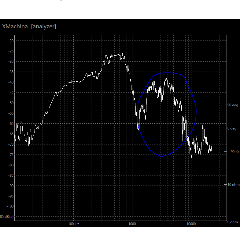

I followed this thread on and off - can I somehow force the program to suppress the peaks above cancellation notch so that it influences the HF less? Would it work to do the LF part as one way separately?
Do you mean something like this? Did you try extending upper frequency range above 20kHz?
I need to get rid of the encircled part:
Just in case, the measurements are attached. Unfortunately, they are in dBV and not dBSPL, but from using these in the program, I do not see this is a problem when I set the target at the same levels. I have already tried one of the circuits in XSim and it seems it will work pretty well.
I will try to extend the range above 20 kHz.

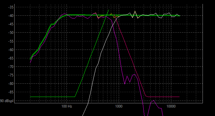

I don't see any problem in attenuating the > 1 kHz band of the LF-way (or maybe I'm not getting something). I loaded the characteristics, smoothed them out a bit first as they looked a bit noisy. Here is the result: the 2 kHz region LF ripple is 35 dB lower than the system response, which seems sufficient, but if you want more, use a steeper low-pass slope.

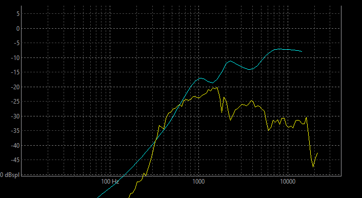

The circuits are not simple but still implementable(RLC 3/6/7). The characteristics are quite uneven and several components are needed to equalise them. For example, here is a comparison of the HF characteristic and the filter characteristics that was designed to compensate it.
Attached design file.
Let me know if this doesn't solve the problem, maybe I didn't get something.

Thank you very much for this! Yes, the HF driver just measures this way according to the datasheet and the bump in the LF is from the bandpass chamber - I might actually try to remove the cone volume filler to see if the bump goes away - I would expect that maybe worse problems could arise since this peak is relatively well behaved compared to what I measured in the previous build.
I will have a detailed look at this later, I really appreciate your input on this!
Edit: By the way, the smoothing can be done in the program itself? I must have missed that. I used 3 points per octave for the task to reduce the crossover complexity.
