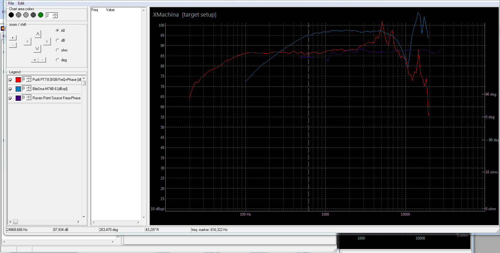

Greetings,
I've had a project in my mind to make a 3Way Speaker, and first thing I did was download this brilliant tool, and enter the Frequency Curves for all 3 Speakers via Images from companies technical data (which took me some time but anyways). And I have three questions (I'm a f*cking newbie hahah) :
- From what you can see, the midrange (BliesMa M74B-6) is much louder than the two others (PurIfi PTT8.0X08Ohm & Raven Point Source AMT Driver), so how do I make my target SPL ? (I'd like the crossoverpoints at around 300Hz and 9 000Hz, I guess that's what's best as they would be used as for my HiFi and Studio Monitor setups).

Click your system target as you like, for example a flat line. System target domain is dBspl. But remeber not to draw the target above driver's spl (in its usable range). XMachina is a passive crossover designer so it can easily attenuate a driver but it can't amplificate it.- From what you can see, the midrange (BliesMa M74B-6) is much louder than the two others (PurIfi PTT8.0X08Ohm & Raven Point Source AMT Driver), so how do I make my target SPL ? (I'd like the crossoverpoints at around 300Hz and 9 000Hz, I guess that's what's best as they would be used as for my HiFi and Studio Monitor setups).
