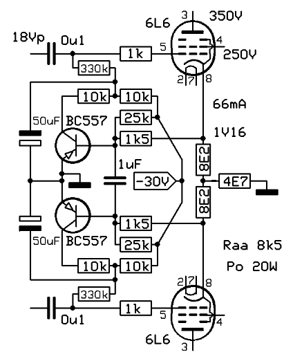

Perhaps this will work.
Inspired by B&O 1959.
Mona
Lots of people miscalculate a cathode bypass cap value, thinking that they are merely bypassing the cathode resistor when in fact they are operating with the typically much smaller cathode impedance.
^^^^^^^^^^ THAT.
Most worry about a parallel RC network: cathode resistor and capacitor in parallel; while actually capacitor plus internal series resistance/impedance is way more important.
And its value is not nicely printed on the schematic or with colored bands 🙂
Rk or RC is trivial, do you really think a 100uf or 150uf , f3 at -5hz or 1hz would make a difference? I don't.
The worst that can happen is that the capacitor value is higher than required by like 50%, it is not the end of the world.

Agreed, many people use the self bias resistor resistance to calculate the needed capacitance of the bypass cap.
But the resistor is in parallel with the cathode impedance.
The cathode impedance of a triode is larger than 1/Gm, because the plate load is not zero, except for a cathode follower. The plate load/u is in series with 1/Gm.
Or is it 1/Gm + plate load/(u+1)? Anyway, they get the idea.
