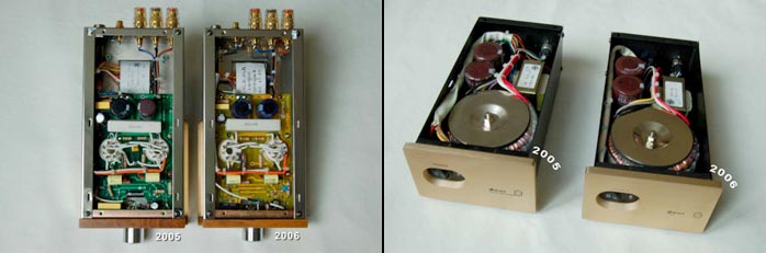

OT:
The incorporation of a CR to a valve amplifier is not very common, as far as I know, it is a great comfort to control the volume, the input selector, the switching from triode to pentode, the mute, all from your chair!
Regards
