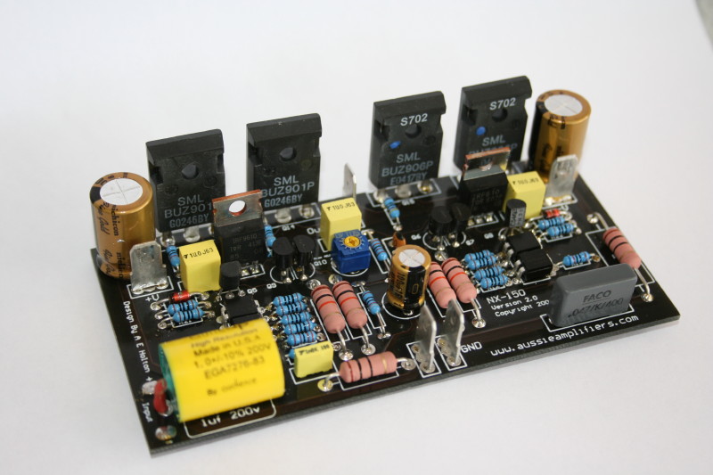

AussieAmplifiers NX150 Spyder

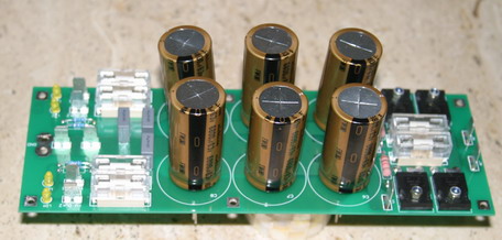

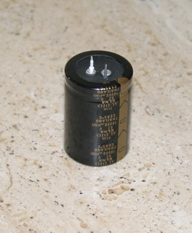

This is my PSU Caps Elna 10000uF 63V
So all my nichicon FW will be supporter now
Even small this caps heavy enough

so we will look the original aussie PSU
there are two size caps in there use
10000uf 100v and 6800uf 63v
you can look the picture direct to aussie site
http://www.aussieamplifiers.com/index3.htm
This PSU use Jamicon 10000uf 100V looks cool

What are your rail voltages going to be ? This will help to know, if they are 70V as recomended for the amplifier then id stick with 100V cap's But if they are going to be around 50V then 63 will be fine.
Jase
" ... What are your rail voltages going to be ? ... 70V as recomended for the amplifier then id stick with 100V cap's ..."
Absolutely correct. These capacitor manufacturers know what they are doing and when the say 63 volts rating, they mean that 64 volts or more has a very good chance of causing a failure ... zzzzztttttt ... smoke, smoke, stink ... :bawling:
45 Volt
My rail voltages will be 45 Volt so i use 63V caps

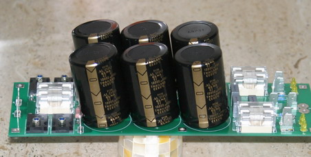

This is the picture with Nichicon FW 6800uf 63V

I think this is better than the other one
More weight, bigger and hope more performance
So Lets Go TITANIC
