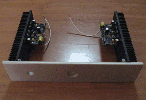

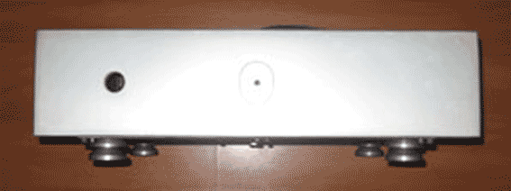

Thanks God
Hiii guys ... It is nice to meet u again
I stop this hobbies for a while (4 months)
Because i need to make some money for my family
and i work a project and at the end i knew something
wrong that project was a little dangerous
When Anthony Holton wrote me an email a week later
Asking : "do you need some assistance ?" so i answer
him : "your amplifier works beautiful but i make printing
on the front plate ... all thing finish except front plate
(Thats time i knew that im ok, in my real life ... Amin)
I lost a little but if i calculate i can buy Meridian CD
G08 and 2 set SQ 28 siltech cable for my system
Thats ok ... sometimes we must pay our careless
Im glad that i can continue this NX again ... feuww !
I will continue this project guys, it is near the end
Maybe i will take a time for my family first
Regards
Jeffry Widjaja
Regards
Jeffry Widjaja
Hi mate!
Looking really good!
When do you hope to have it finished?
It would look great in my web site gallery.

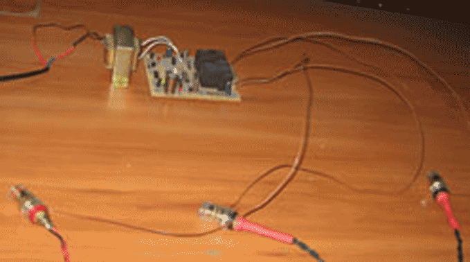

PSU Shock
When i was screwing heatsink to chasis
i hear a little sound like "Tess"
( Contact from PSU connector + to - )
So i got a little nervous how can this thing happen?
(I forgot when i test PSU, theres a capacitance there)
So i look wheres the source of a little sound
When i look around for the source
i hear a bigger sound TASS !!! and the bright light
Oh my eyes ... my eyes ...
but i can still looking several second after
Grrr ! I must reduce the capacitance first
i will always remember this thing
Boys and Girl dont try this at home
It is very dangerous

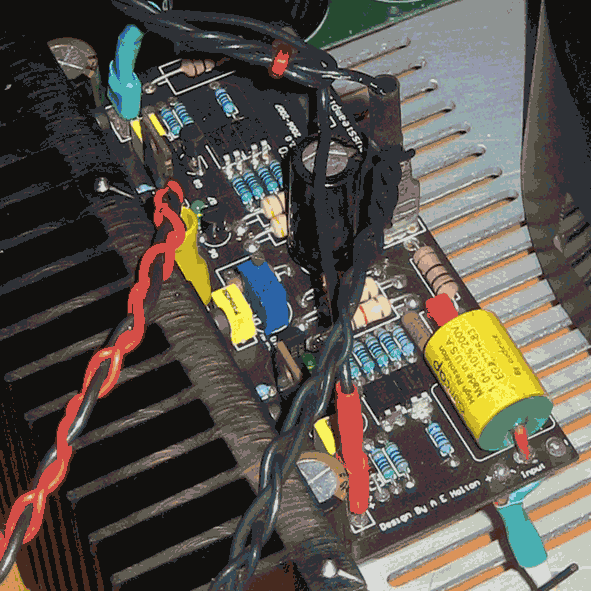

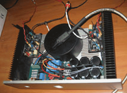

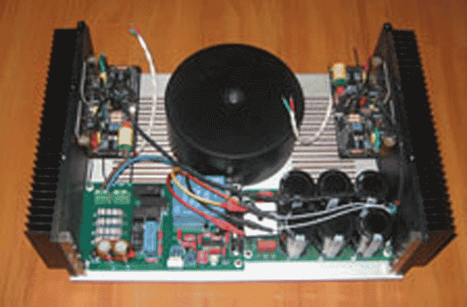

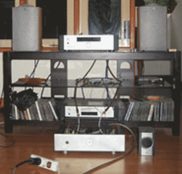

BIAS
The Amplifiers is on now
so i check the heatsink but after 1 minutes
The Left heatsink is very hot
But Right Heatsink is so cold
I try this module six month ago and their work fine
So why ???
After i tried to remember and realized
i forgot something i change Trimer Pot & Signal caps
I change TrimPot with BOURNS cause more accurate
BG F 100uf 50V Replace Nichicon FG 100uf 35V
Bias Left Ch from 7 Volt to 0.9 Volt ... Ups this is A* Amp
Bias Right Ch From 0.23 Volt to 0.9 Volt
Wait for one minute, heatsink still cold
Wait Five minutes, heatsink a little warmer
Wait for ten minutes, heatsink still little warmer
No Wait anymore to Play CD
