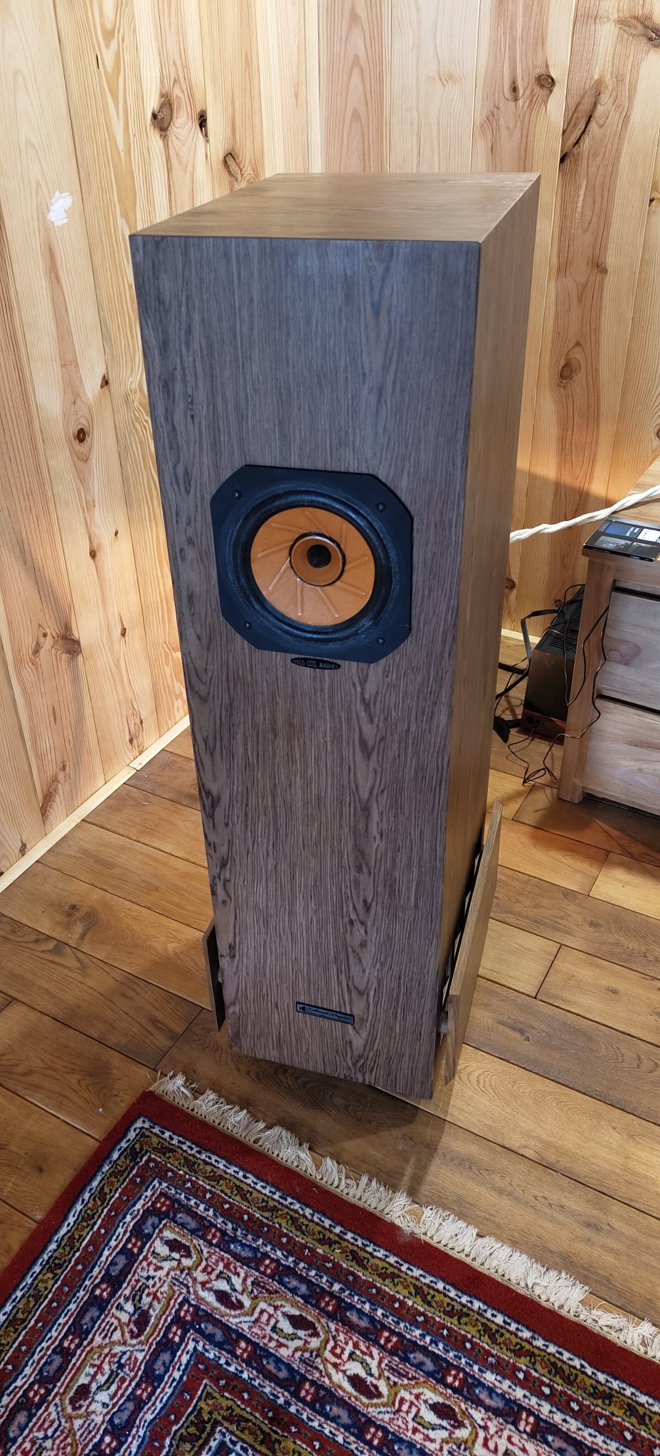

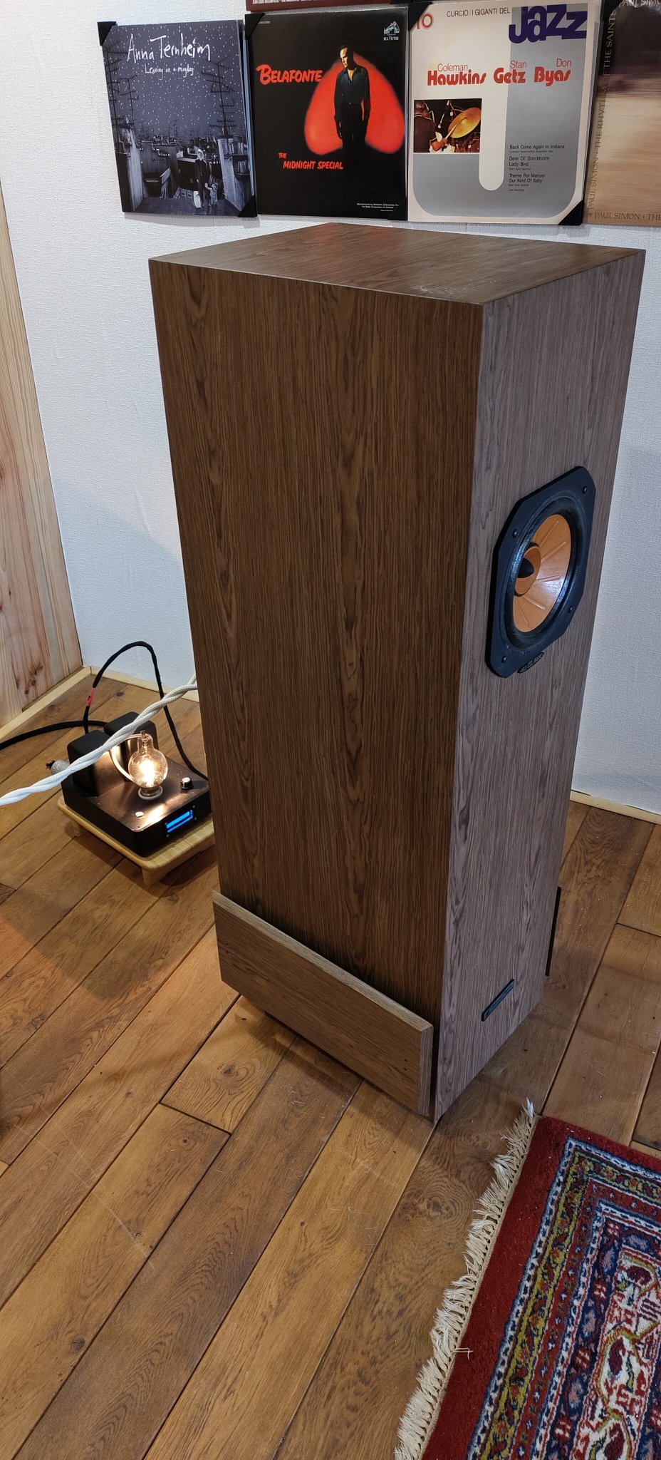

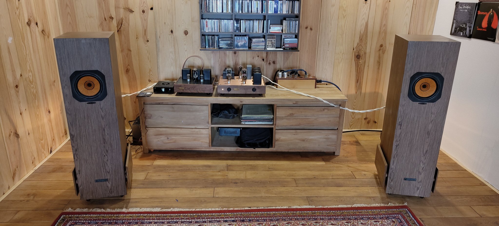

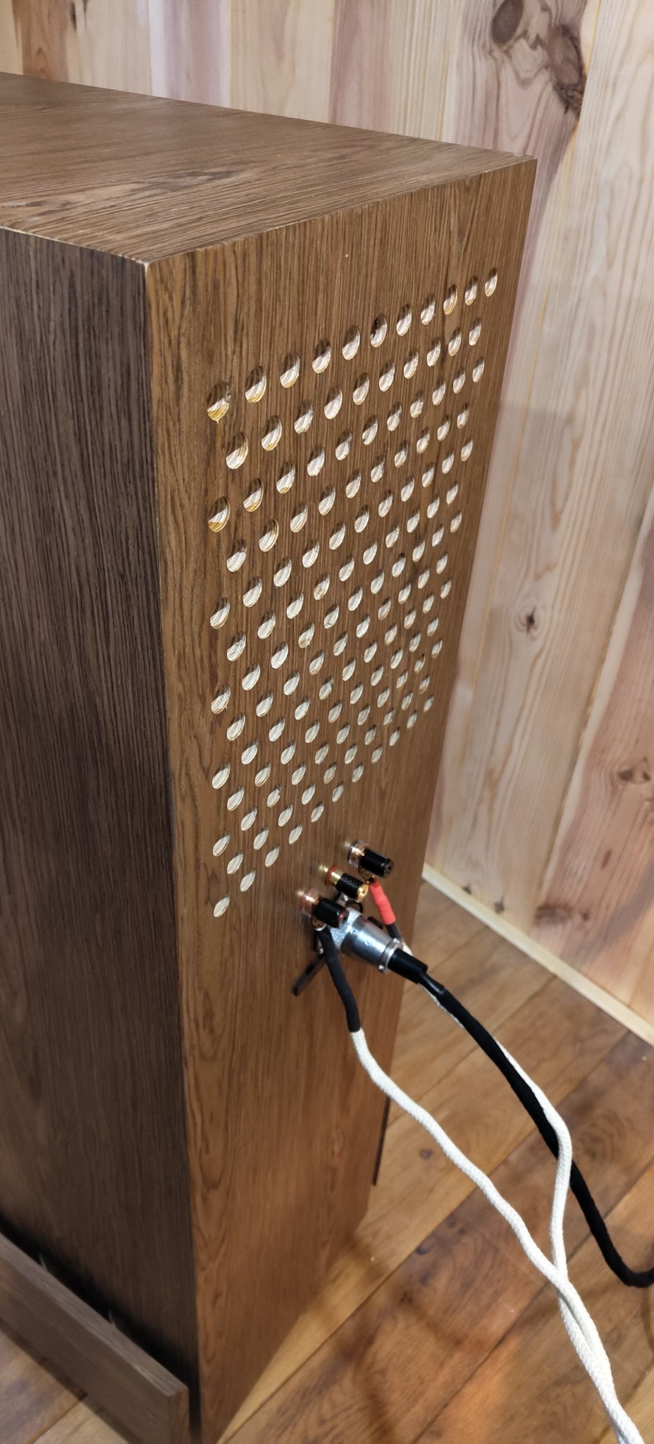

My units are back and need to play in. First impression: more open and more depth. Will keep you updated. It takes around 200 hours. I use them in a box supplied by Rudy Gunawan (Aurel Bryan). This is the original box he also used for the magnet version. The difference is the hole on the back. Still in love with this units... They are very good, and the cheapest fieldcoil available I guess...

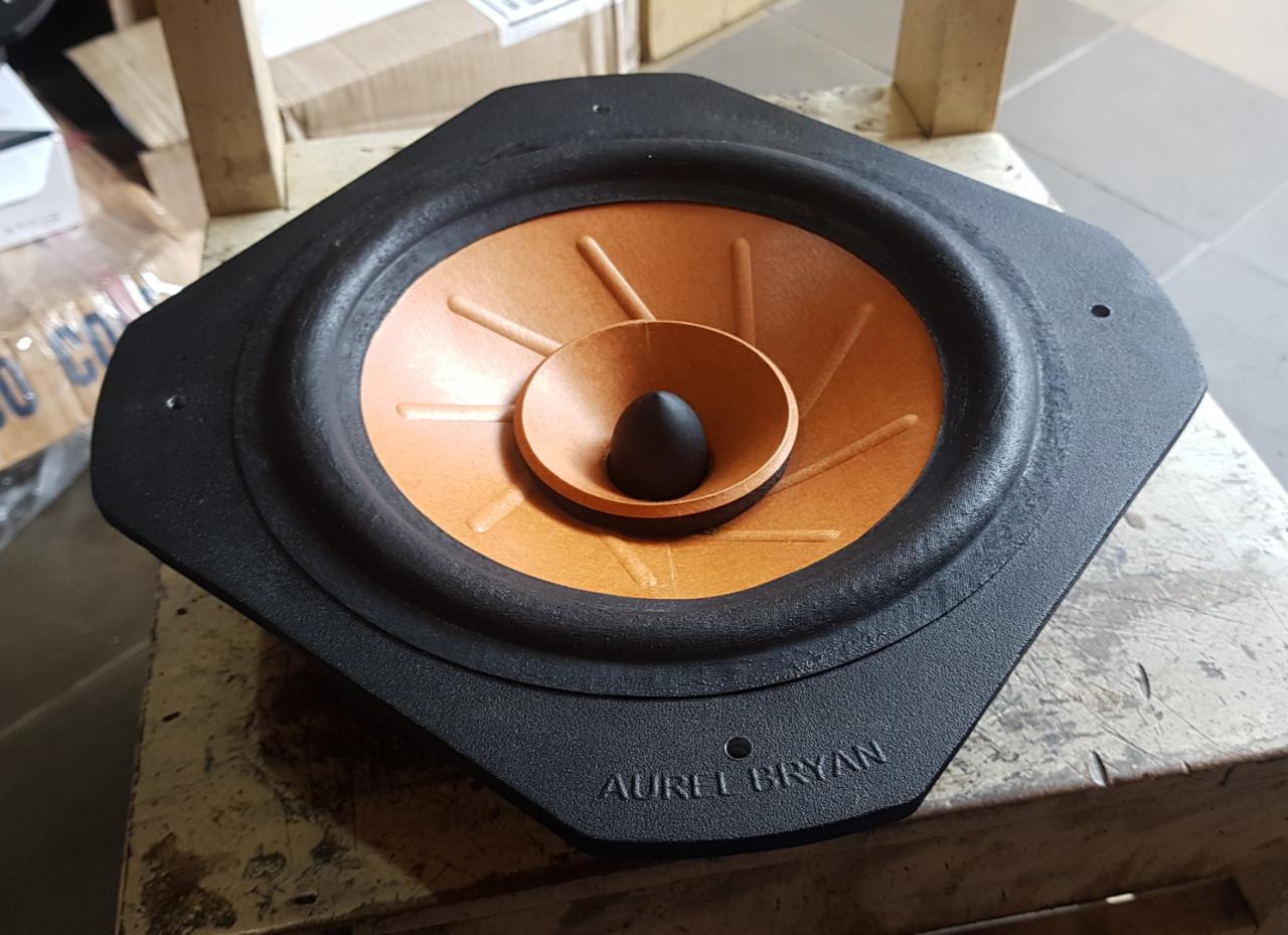

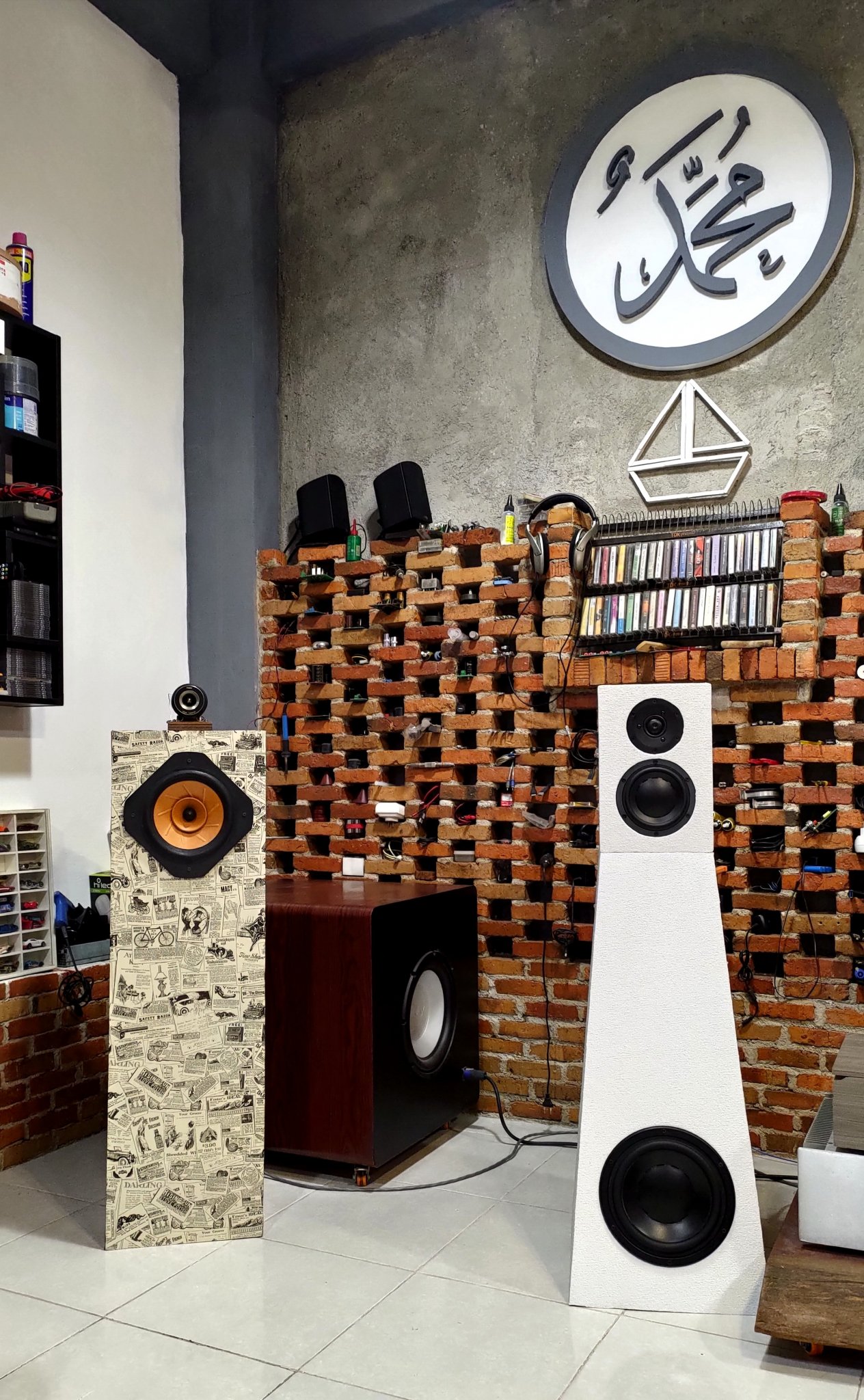

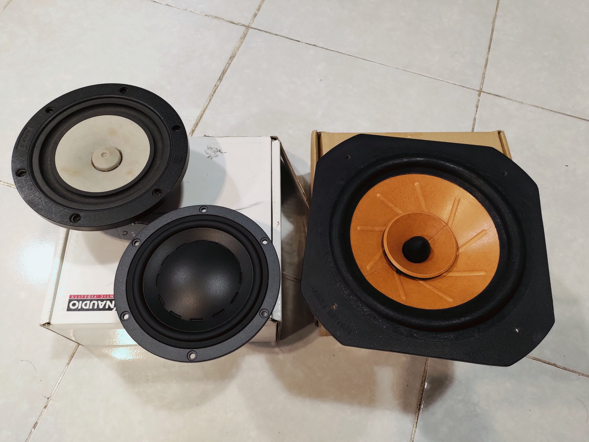

I had 1st gen aurel bryan with empty dust cap as TS had, now i have upgraded to a new design which use phase plug. i just sent my unit to Rudy as designer and he upgraded it properly
test with my other drivers : alpair 10p & dynaudio mw152
I can say that the new gen of aurel bryan has much better balance sound and less peak noticed by my sensitive ear. cranking the volume still keep it's balance
meanwhile dynaudio mw152 started to give me headache due to occuring peak, adding 0.82mH helps to tame that peak. however alpair 10p here gives the biggest peak which i can't endure. maybe that's the reason this alpair stays in my drawer
kudos to the new gen Aurel Bryan 👌

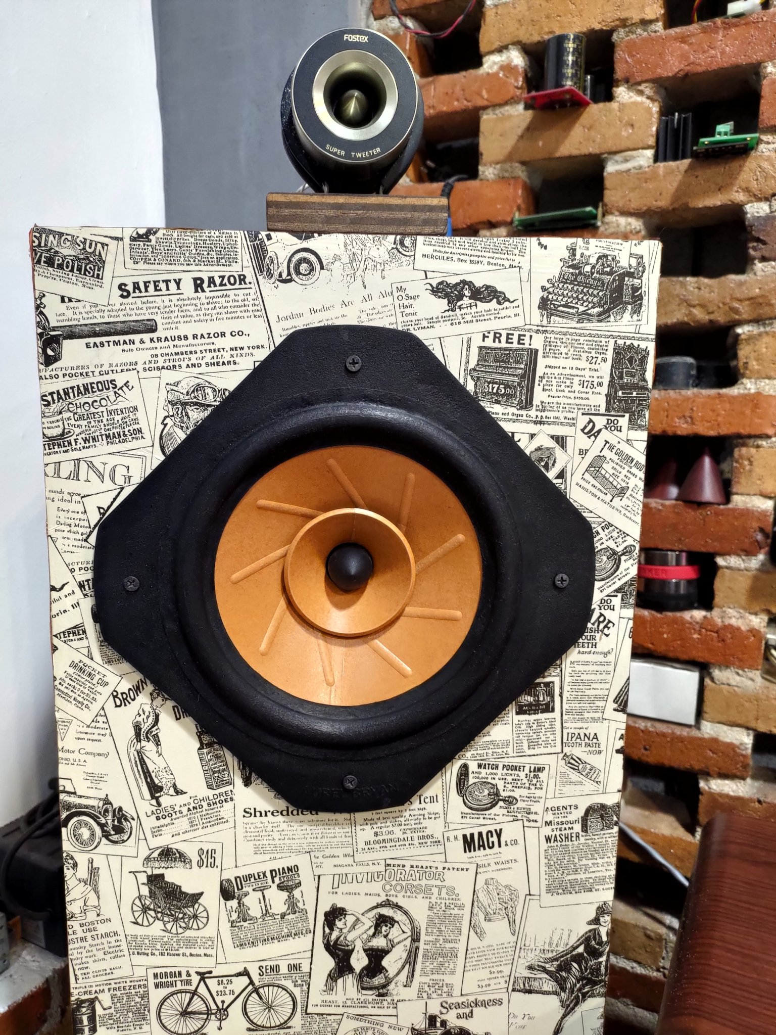

I have finished MW152 on other 3way project, while I'm building Whammy preamp to SIT L'amp for Aurel driver. now I have to crank my dcb1 volume to max for Aurel, with extra more juice from preamp will give me extra headroom
I use 80L BR box with 8.5cm hole without port, this box was occupied by AudioNirvana Classic 8 but now Aurel replaces it, AN is removed and stay in the box now.
I can say that Aurel improvement is subtle compared to shouty AN, eventhought Aurel has to trade more balance sound to lower sensitivity. it has higher sensitivity than Markaudio 10p, maybe around 92dB

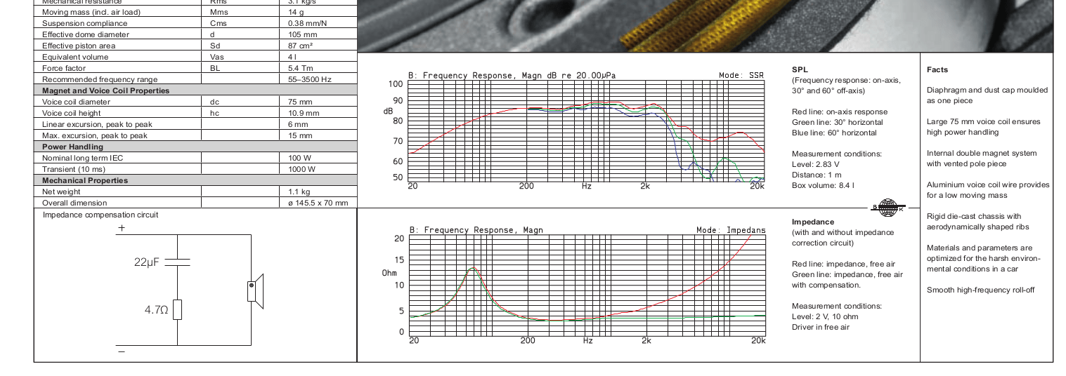

I use dsp instead of passive xo, much easier to deal.have put the correction net con dyna ?
sorry but you cannot correct the impedenceI use dsp instead of passive xo, much easier to deal.

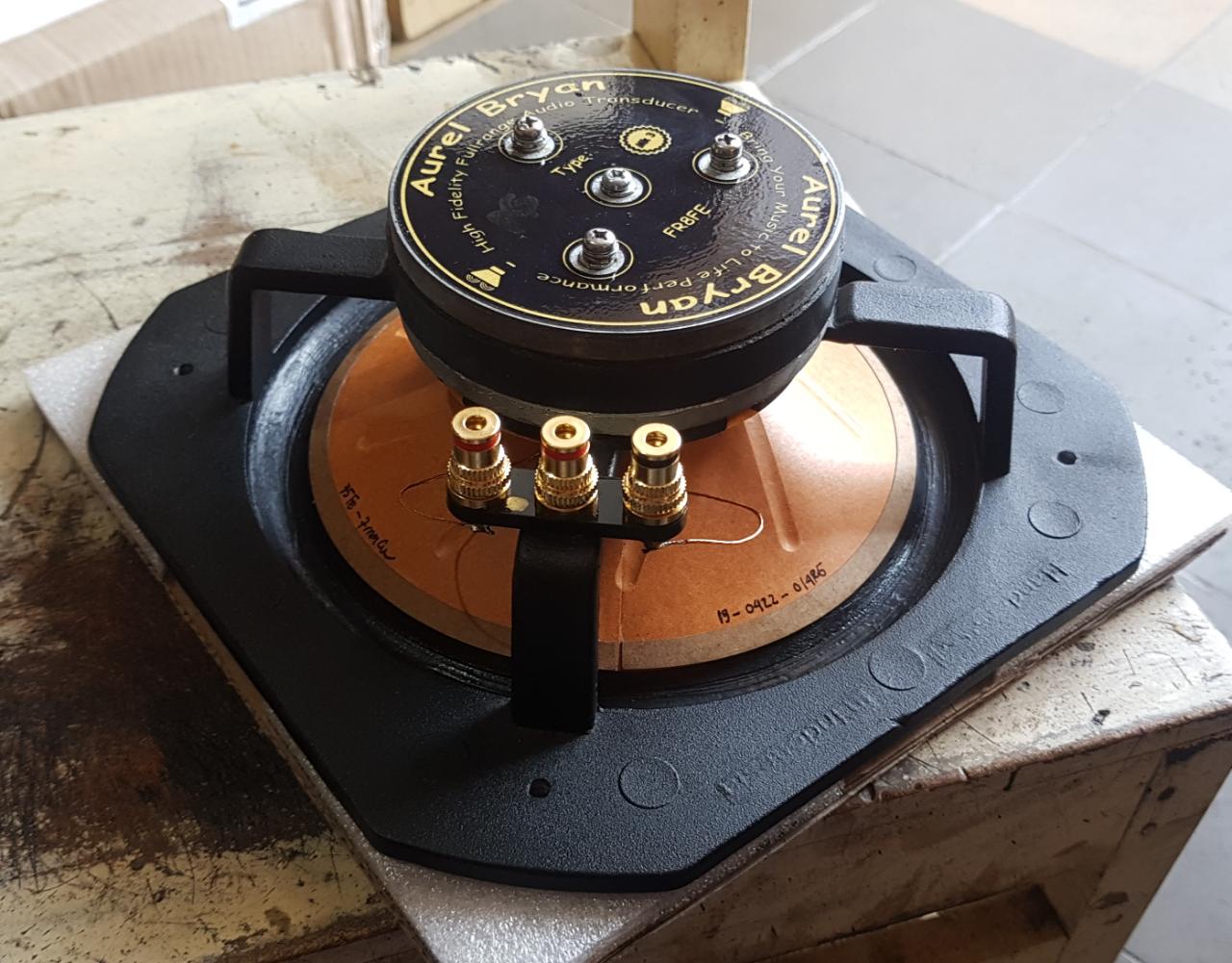

Hi,I use the 8 inch fieldcoil version of their speakers. Exceptional good sounding. My units are for a update at Aurel Bryan, they will be back end of this week. Later I can post more information or pictures.

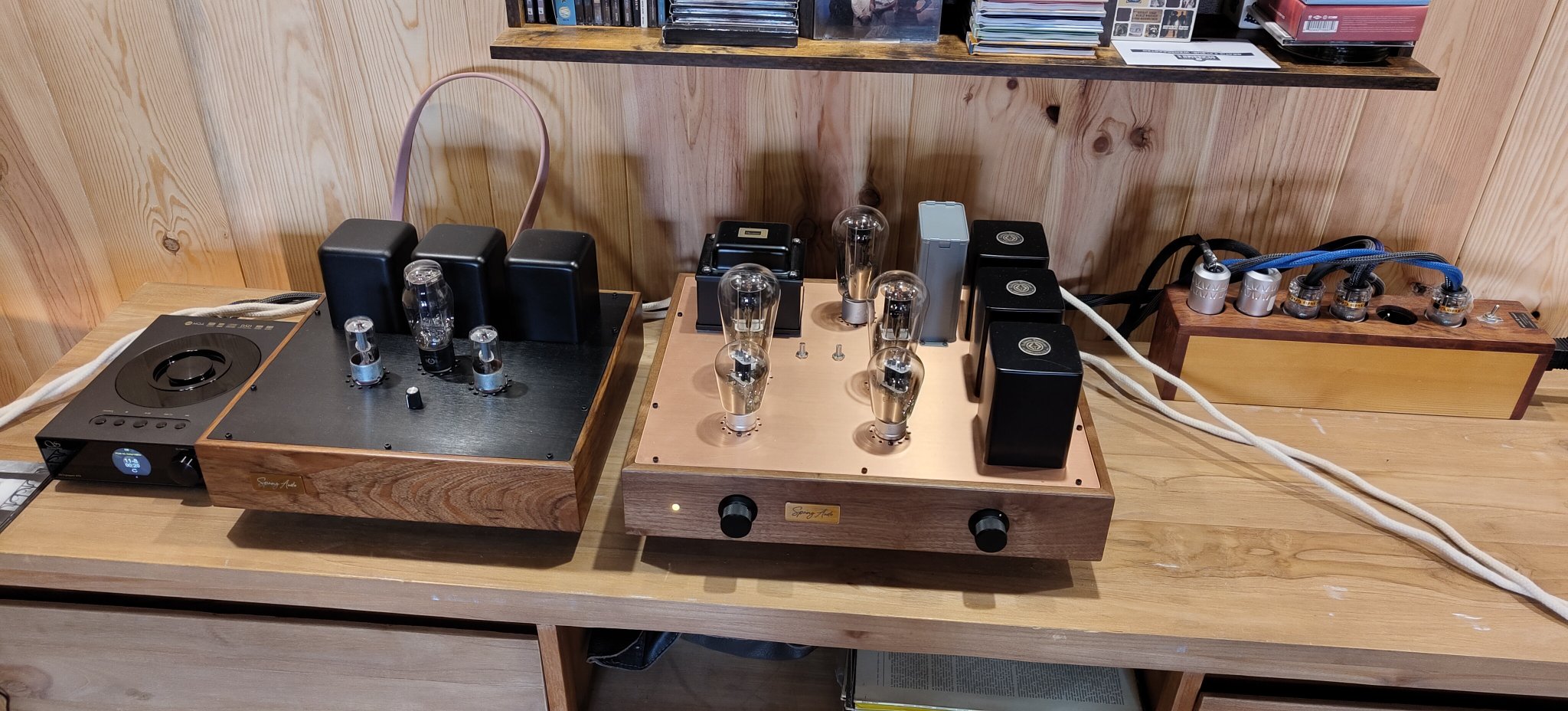

Awesome. Is that the power supply with the tube being the speaker ? What kind of tube does the power supply take?
