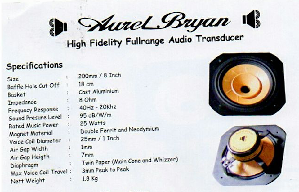

I've seen recently a lot of praises for a local indonesian fullrange driver builder called Aurel Bryan. But i can't find much info about it or reports that don't come from Indonesia. Does anybody have any experience with this brand or more info about their drivers? They look wel made i have to say...

I have the 1st gen 8" driver with ferrite magnet and it has evolved into many varations from smaller 4" or 6" to 12" woofer + super tweeter. additional Neodymium and FieldCoil are also available.

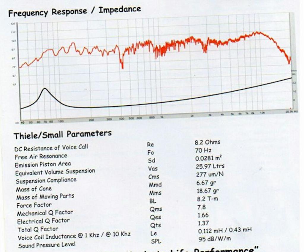

I've seen pictures of documents i can't read with what look may be graphs and t/s parameters, but no real documents that i can read. And i did search on google and on this forum but found no info so that is why i opened this topic. So if you got links, that would be handy.
I had to click on the title image on FB to see the whole picture with the T/S of the 8" driver.
Qts 1.37. That should please the OB crowd!
I like that it has a natural small dip at 1kHz. I usually add that dip with EQ as that frequency hurts my ears.
Zoomed in picture.
The Ohms scale is hard to read, but it looks highly compressed to show a flat line. it is from 0 to 64 Ohms, in log increments.

As for my impressions, I feel they are transparent, but they get 'busy' if the whole music spectrum is played through them. I believe they will shine as a midrange. Furthermore, I believe they shine on an open baffle, as members gadut and Leonidas mentioned earlier.
For what it's worth, I've tried simulating the 8 inch driver in a ported enclosure in WinISD but couldn't find a design that I like. The high Qts explains this, so I'm not sure why the designer recommends a ported or horn enclosure.
I received an original file of T/S parameters from the designer, and perceval's scans are as good as it gets. The SPL scale is 10dB increments.

I tried to contact whether it sales or designer about this product they have 2 version one with neodymium and another one with ferrite magnet and neodymium version price pretty high I reckon. but anyway on photo it wrote double ferrite and neodymium.
not sure about subjective sound quality it seems has a positive feedback but it somehow like buy something stuff in aliexpress with amazed spec and positive review.

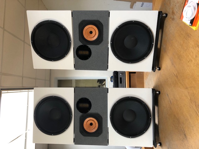

I ordered them last Fall and have been so blown away I have been working with the designer, Rudy, and will be helping distribute them in Europe and North America.
A pair of the drivers I have sent through the rounds of some DIYer I know (I am more active on Lencoheaven) to get feedback. Currently in England with an amp designer.
We are already on the third iteration of the drivers and finalizing a speaker build.
We have an official online review lined up once we have the final version (driver and speaker) to submit.
Thanks to Blok15 for offering a demo.
I am doing a road trip through Europe (Estonia to Norway) once safer to travel. Would be happy to stop along the way to let people have a listen.
Also glad to continue the original pairs journey to fellow DIYers.
