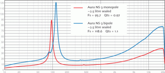

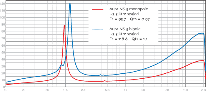

We tried them briefly as bipoles.
Impedance curves give an Fs of just under a 100, and the bipole in the same box about 20 hz higher. I plan on adding an aperiodic port to the back baffle to see if i can lower the bipole's impedance peak.
Now using them with a sub. XO currently set to 60 Hz.

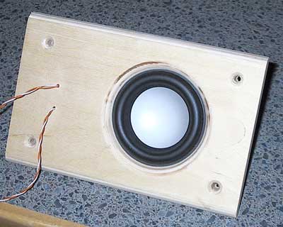

I found that the sealed enclosure worked best (the kits I'm about to launch have a removable rear baffle allowing the user to switch between sealed, aperiodic, ported and bipole)...you won't be able to pull much more bass out of these with a BR..maybe a transmission line ala Tim? (Tim's NS3 TL)
The sealed enclosure helps out in the power handling department as well.

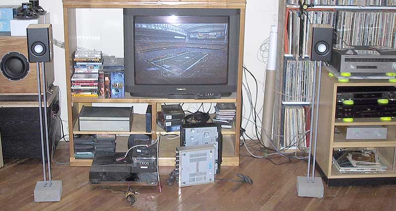

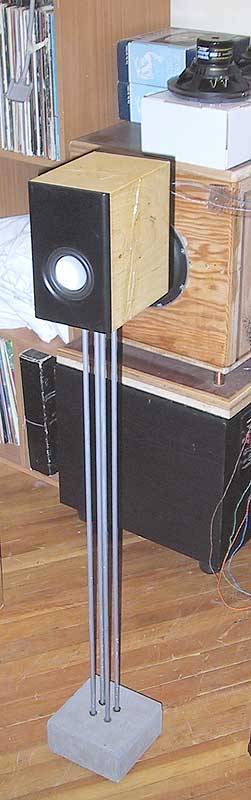

As an aside, Dave how are those Ikea stands? (I assume the ones in your picture are these.) I was looking at them recently because I like the look and the price, but was worried that the thin metal tube supports would cause energy storage problems even if the ones that weren't running wire were filled with sand...

Pallas said:As an aside, Dave how are those Ikea stands? (I assume the ones in your picture are)
So that is the source for those (i picked the ones i have up at a garage sale or VV or something.
They seem to work well. I haven't been tempted to damp the pipes.
