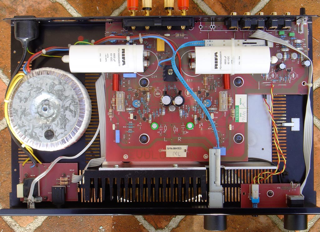

As for my VA100 it does soooooo good!:
As you can't see there is a LME49720HA instead of the LM4562NA and a pair of LME49710HA on the phono stage wich can be powered off via the former Tape switch.
It's all better and clearly noticable, as expected. Won't do much on this now, I need good sources as the phono is not mine and the DVP5500 SACD player just want to detroy my ears in highs.
For later is planned a dedicated PSU for the LME as it works better with higher and regulated voltage (13.6V unregulated here from the main 50V).
After havin the best sources of the world (that means at wallet & speakers scale), then, if I'm in the mood, discrete op amp as Audio GD. Or not.

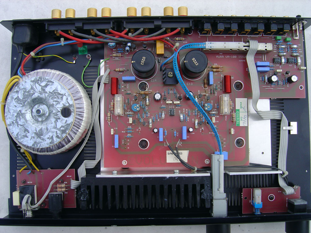

Hi everyone, just read through this fascinating thread. I have a VA100 which I bought new in 1993 and am still enjoying today. It is only recently that I have started to give it some attention. I have replaced the bias resistors and reset the bias currents according to the service manual that B&W very kindly forwarded to me. Perhaps you can point me in the right direction of what I need to replace to reduce the mains hum. From new this amp always had a very slight hum (zero volume & no inputs connected) but now after 16 years the hum is audible from a few feet away. The hum is from the speakers, whereas I have experienced the amp humming (vibration) over the years with certain other appliances switched on.
Any advice greatly appreciated, at the moment I just want to reduce the noise, maybe later I will get more adventurous like some of you guys.

About the caps I don't think they can bring noise or they should be in short and this is worst than old 😉
Anyway you'll be wise to change the main big caps (go for 6800µF instead of 4700 as far as they're "audio" and fit the slim case) and the 4 around op amps supplies, they are defo old now. Rubycon ZA/ZL works fine and I stick to these.

What about bypass the mig Rifas? They are among if not the best lytics, need something to bypass them like some (what I have left) 1µF MKS or 1nF Teflon? Someone ever done this?

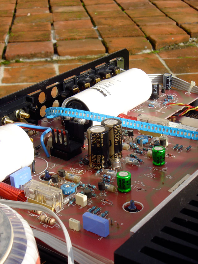

The 2SK1058 & 2SJ162 are screwed to the radiator via a piece of soft plastic or such, I have to unscrew them again, is it wise to remove this and put my brand new never used Arctic Silver IV?
Well I've read some and redone the radiator like it should: it's defo warmer, good sign.
Final pic, the way the source ribbon cable routes is the one with no humming. Some noise floor is still here, always been and unfamous on these amps. It's just working like a charm, the best on the low power amp I ever owned!
