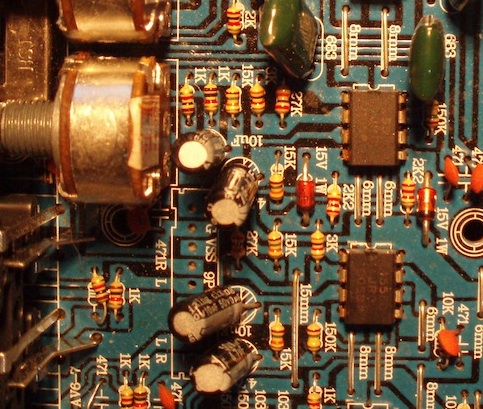

2 Zener diodes are near audio section? If you meant those then they have 3.5V across them and they are IN4744A.
1N, not IN. They are 15v Zeners and if you have 20+v on the resistor, you should have ~15v on the diodes. Desolder them to see if they're leaking. Do NOT power up the amp with the Zeners out of the circuit.
I read from internet, that zener diodes should be checked with variable power supply or analog multimeter. I dont have either. I just checked them with my digital multimeter using diode check function. Probes one way: open circuit, probes the other way: 1.540.
I'd expect open one way and 0.7v with the probes reversed. 1.54 is a bit much. Does your meter read ~0.6v when testing other diodes?

Yesterday I reinstalled the zeners, found a cap with similar value to the one that was missing. Tried the amp, everything is the same, instead of 15V I have 3.5 and resistors are getting hot. Thought that maybe TL072 which I inserted is the cause? Removed it and still 3.5V.

I noticed earlier one more thing which I did not think was important at the time.
Near inputs there is opamp? with 9 legs drawn to the board but the opamp itself is not there.
It looks like it has never been there, maybe its for some other model which uses the same board? By the looks of it, it has something to do with RCA outputs and can not cause the problems this amp is experiencing?
Photo attached.
Photo attached.
