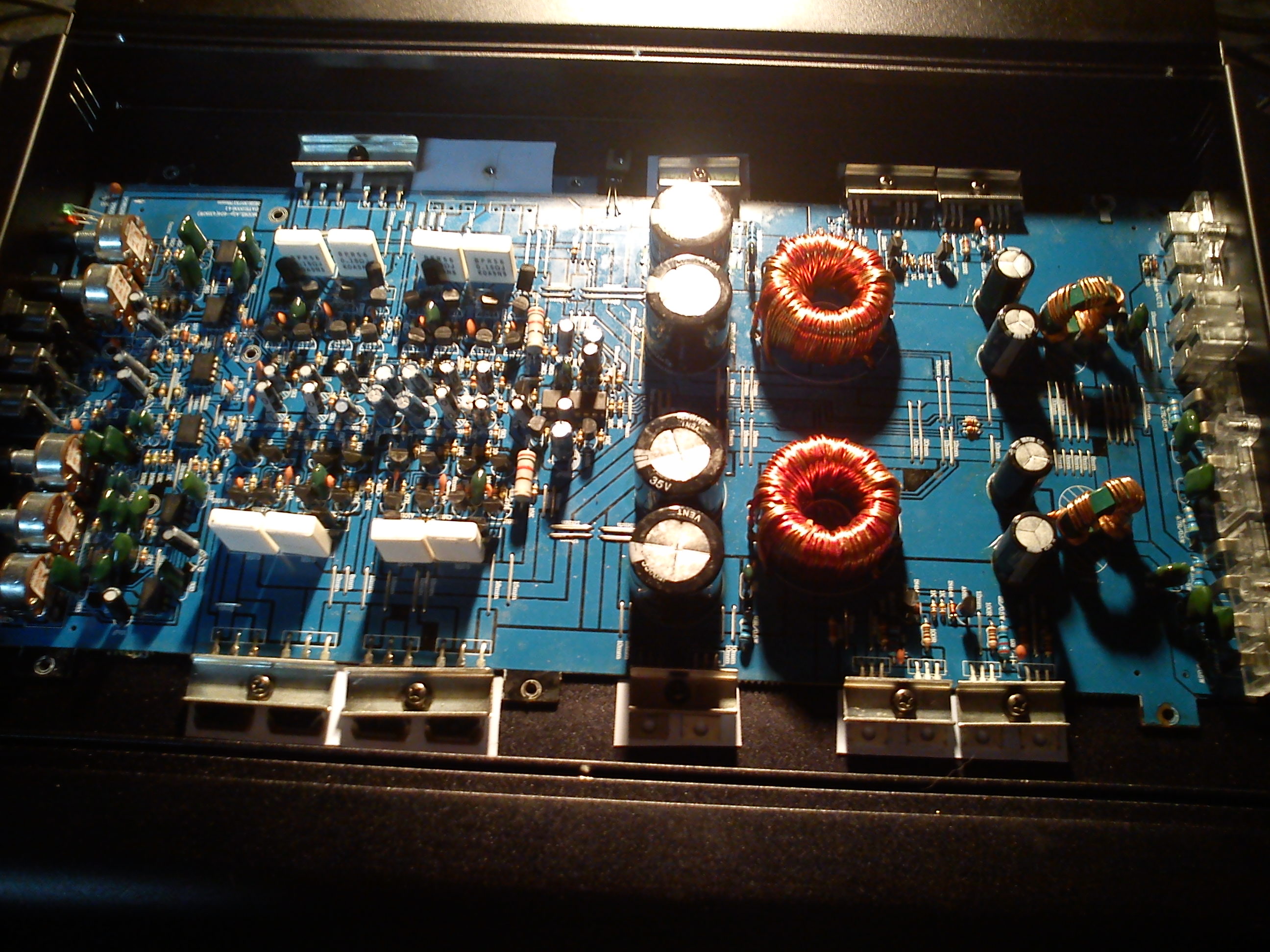

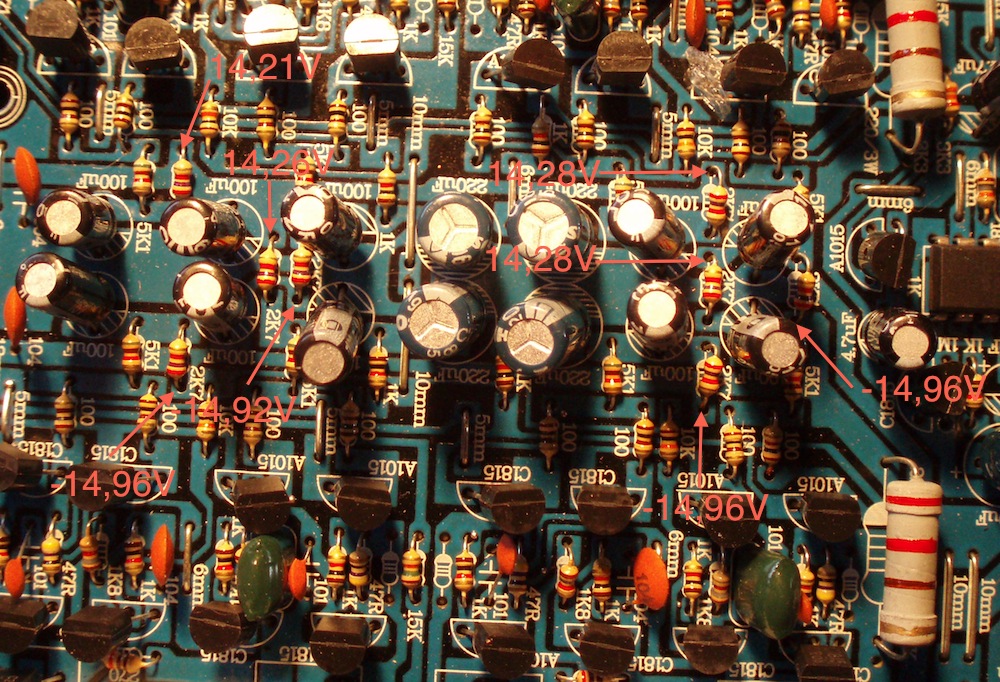

With jumper wire connected from RCA shield to amps ground terminal I still have only 2V on op amps power supply legs. But speaker does not make any noises anymore and amp does not draw current with speaker connected.
Posted a real big resolution photo of the amps guts here:
http://mote.planet.ee/auna/auna.jpg
Maybe someone can see something which might be causing problems.
