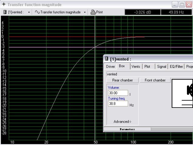

What frequency were you expecting the vent to be tuned to? Let me know the box outer dimensions, panel thickness, vent length, height and width, and I'll do a double check for you.
pinkmouse said:Hmm, the port is obviously wrong somehow. What happens if you block it completely?
Blocking completely is easier said than done, but covering it with my hand cone excursion is reduced at 25hz but increased at 31hz and especially 40hz. This would suggest it's tuned correctly I think.
richie00boy said:What frequency were you expecting the vent to be tuned to? Let me know the box outer dimensions, panel thickness, vent length, height and width, and I'll do a double check for you.
It's supposed to be tuned to 40hz. Externally it's 600 x 188 x 460 mm. The port is 250 mm long, 145mm wide and 30mm high.
Actually, I think the port may be slightly detuned. I might not have taken account of the thickness of the front panel
Yes, I accidentally made the port a little longer than it should be. It would appear to actually be tuned to about 39hz, see pic. Doesn't make much difference tho, and I think it sort of sounds as it models - a little shy.

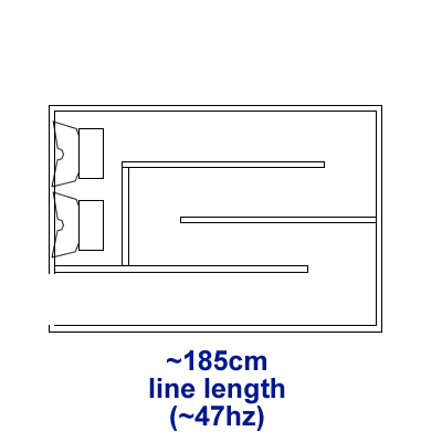

Hi all. This project seems to have run out of steam right now, as the isobaric ported prototype was only 'ok' and not impressive enough to justify carrying on with and building two of.
With the other speaker being cut to the right shape for a ported box (boring) I wondered if I could squeeze a transmission line in there. I've heard one set of TLs and I loved the smooth high quality bass they made. Like nothing else.
I've drawn to scale a possible maze arrangement, and although it's long enough I think (just about 1/4 wavelength of Fs) it's rather a small diameter line. Worth building to try??
Vikash said:I'd suggest getting those T/S extracted as accurately as you can first 😉
I'd agree. The problems with the isobarik box you built are most likely down to the size and porting being wrong, not the drivers or the concept.
