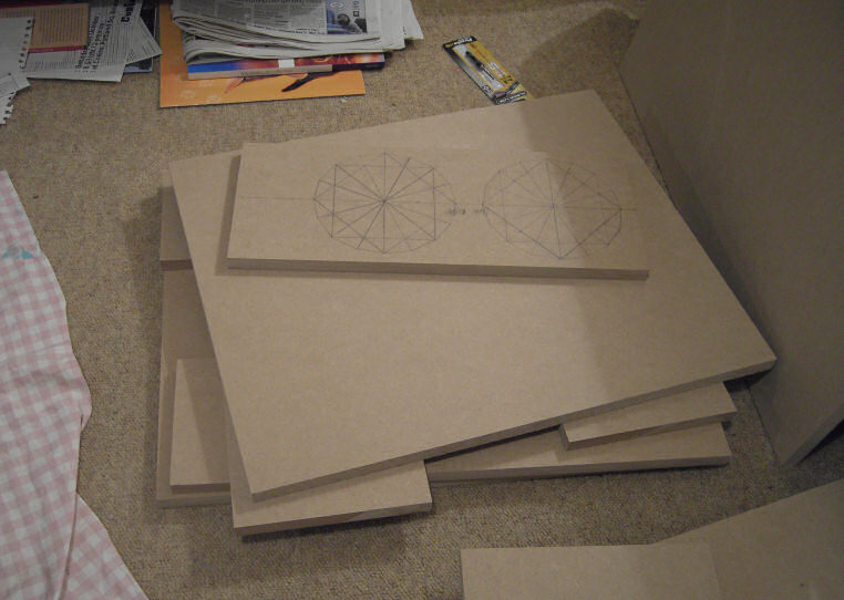

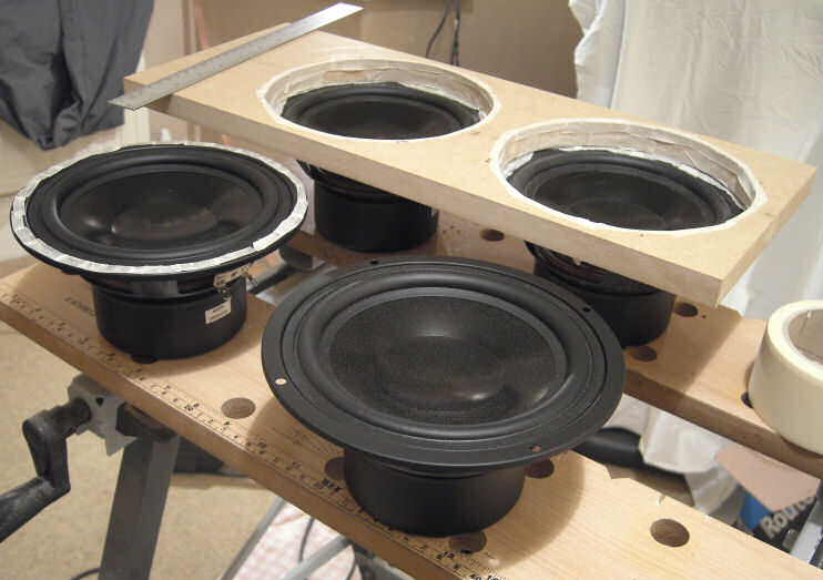

It might look cool yeh! And I agree I need to do test boxes (hopefully will do some of that this weekend!), but there's a small obstacle to overcome if I clamshell mount the woofers into each other - the surround protrudes from the basket! I'd need some kind of spacing ring (can't be making those with my tools/skills very easily).

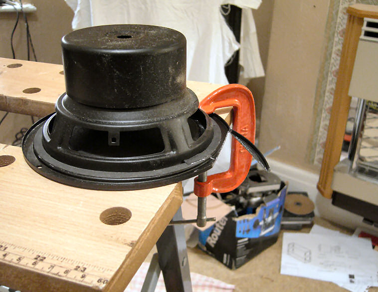

If you don't need the screening, it might be worth disecting one driver to see how easily the can and extra magnet come off. That would make the drivers look a bit cleaner/ more attractive.
If you do go for isobarik for the final cabs, then I'll mill up some spacing rings to your dimensions for you in return for a few drivers.

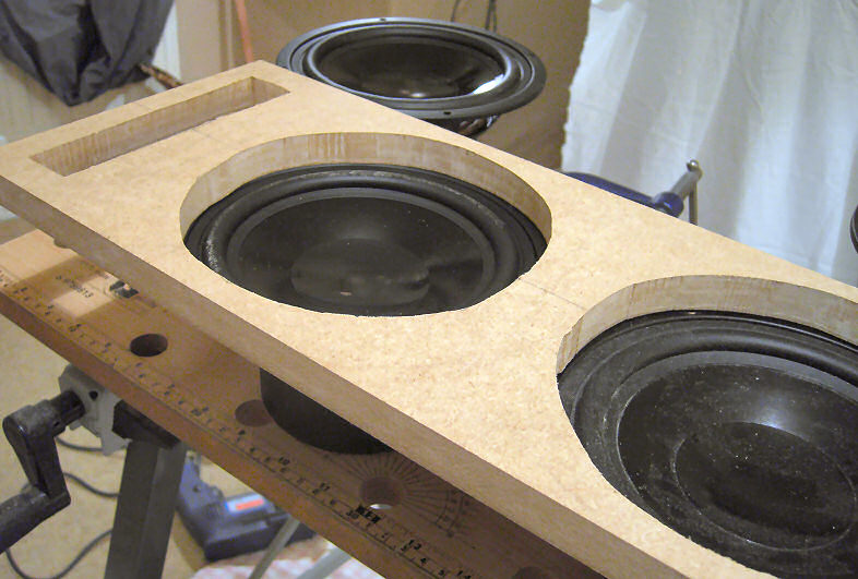

the cabinet wall becomes your spacing ring.
Is that wall too thin to be a spacing ring?
Remember that the two speakers in isobaric move in the same direction when powered.

I don't think I need to lose the shielding part, as it looks ok. Altho my other drivers aren't shielded so it's a bit of a waste, but nice to have. What worries me a little though, is the possible filtering effect of the sound having to go through quite small holes in the driver frame. Care to guess how high I can x-over without this being a problem?

Some interesting thoughts here. The cabinet wall could indeed form my spacing ring, but I bet it's harder to implement than it sounds.

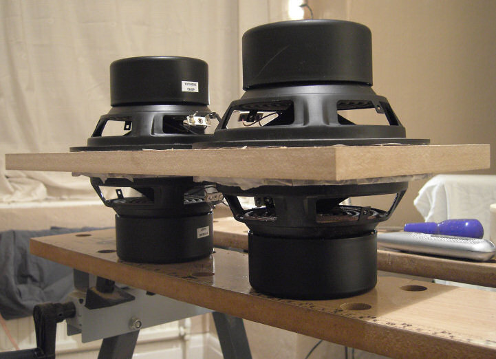

The reason is simple - in this configuration each driver is a compound driver - that is, two drivers facing each other, with no air leaks inbetween (it is sometimes called a 'clamshell' for obvious reasons. In that diagram, although you can't see them all there are supposed to be EIGHT drivers!
Isobaric loading halves the compliance and therefore the Vas (this determines cabinet size), so to have the response and box size the same you need double the (compound) drivers.
Having 4 pairs like this gives the same frequency response as 2 ordinary drivers in the same box, only now there is 4 times the thermal power handling, and theoretically lower distortion too.
This is because as one half of a pair pushes the other pulls (it's wired out of phase, and hence the name 'push-pull'). This supposedly reduces non linearities caused by the voice coil leaving the magnetic gap, or something like that.

I use foam draft proofing strip for sealing drivers, cheap, and works well. You could use blutack or similar for a test box.
Good morning and thanks PM, that is a good tip.
