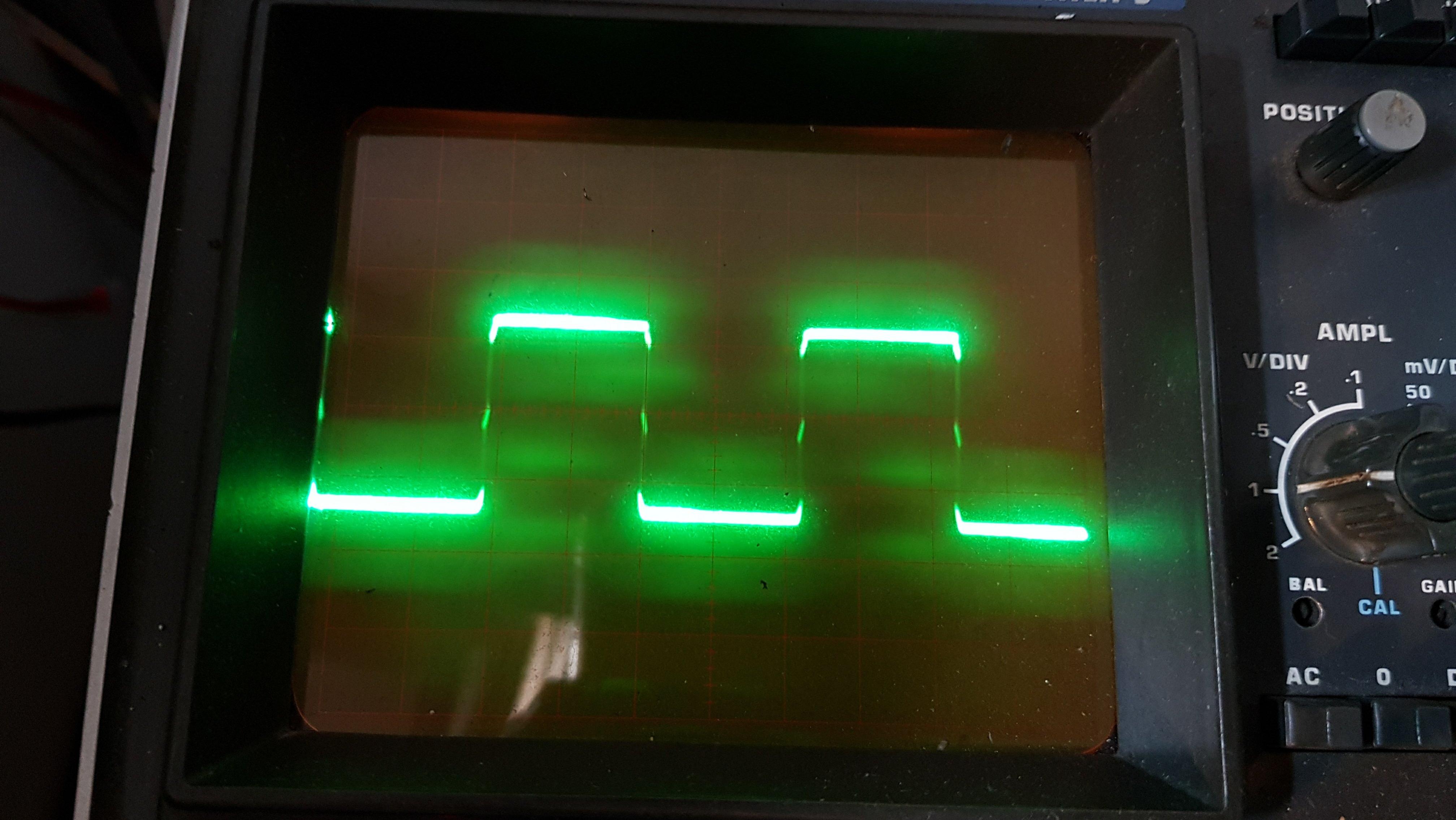

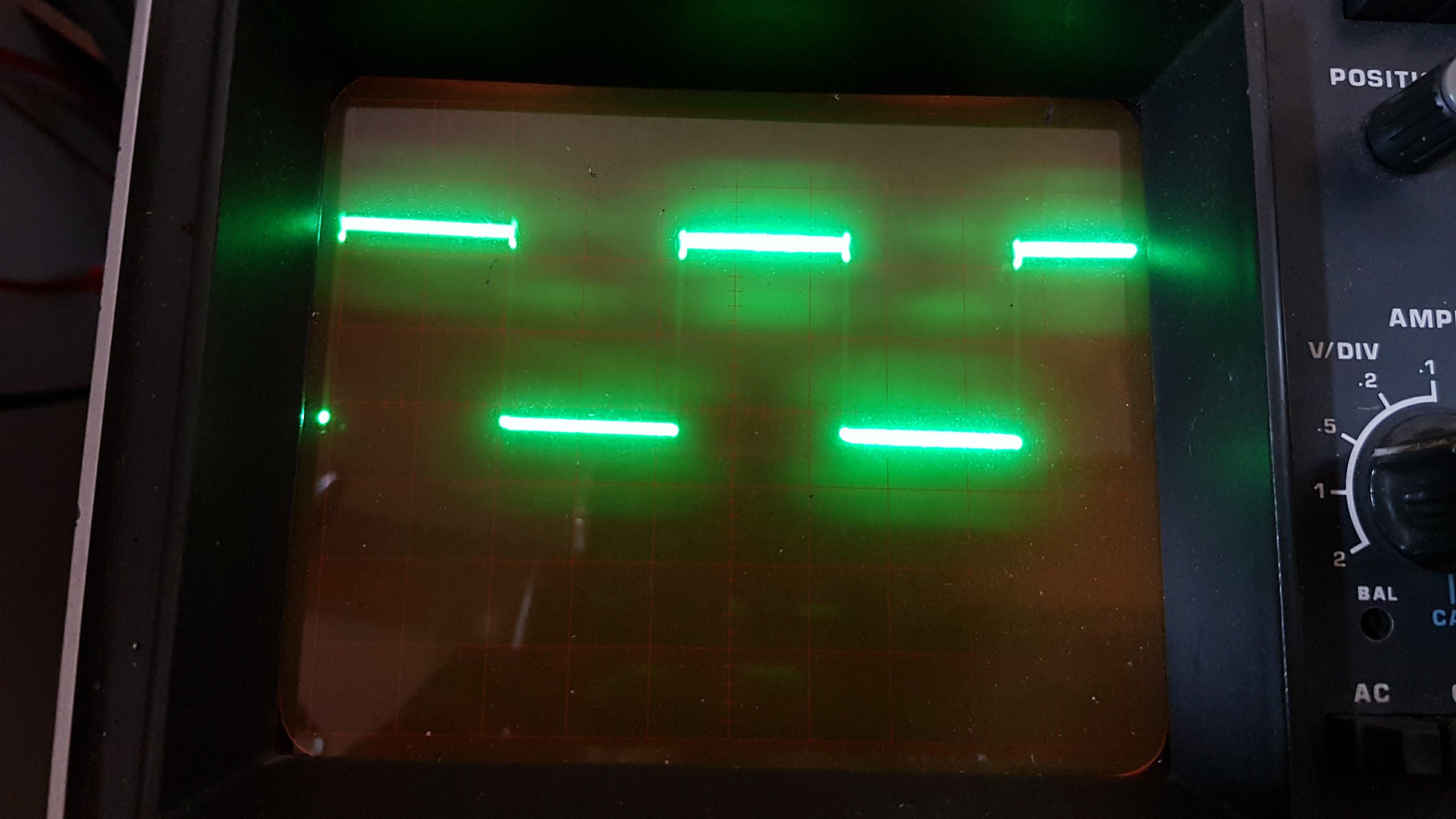

Did you look at the signals in differential mode?
Use DC coupling in differential mode. Align the trace to the reference line.
For the differential image, one probe would be on the source pad of the output FET and the other on the drive signal.
Photo 1 is the high side gate drive
Photo 2 is the low side gate drive
Trace is aligned in the reference line before measuring.

Using differential mode gives the scope a better reference and allows you to see DC offset.
Neither signal appears to be going back to ground.
Confirm that the scope is reading as expected by checking the signal with the probes on the gate and source of the PS FETs.

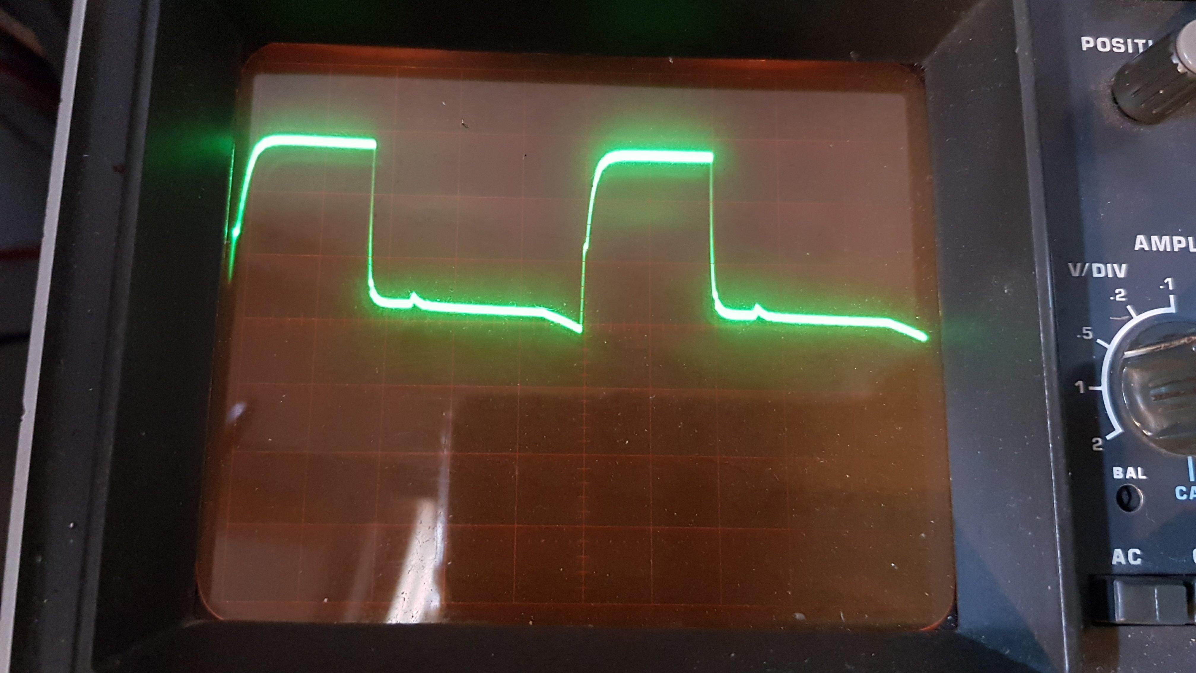

Looking more carefully at the graticule (difficult to see), it now appears that one signal is going below ground.
Do you have channel 2 (inverting channel) on the source leg of the FETs and the ch1 probe on the drive signals?
To both statements, correct.
It seems to drop juuuust below ground on the PS gate drive.

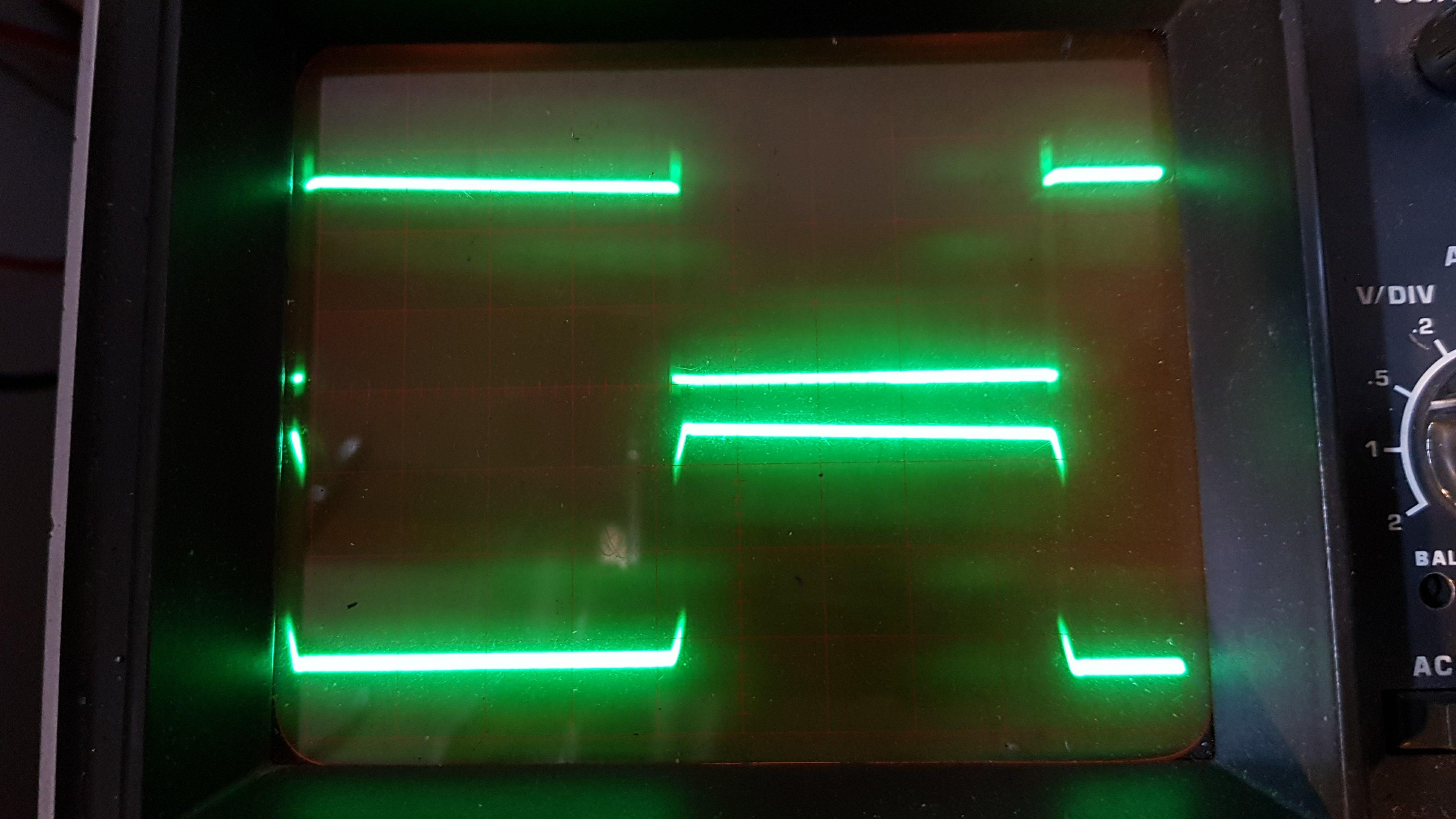

The PS drive is OK. I was looking back at the other two waveforms you posted in differential mode.
Ah, excuse me.
Also in this case, to both statements, yes.
It's the low side gate drive
Differentail mode measurement, probe 1 on the driver board output pin, probe 2 on the source pad results in the same.

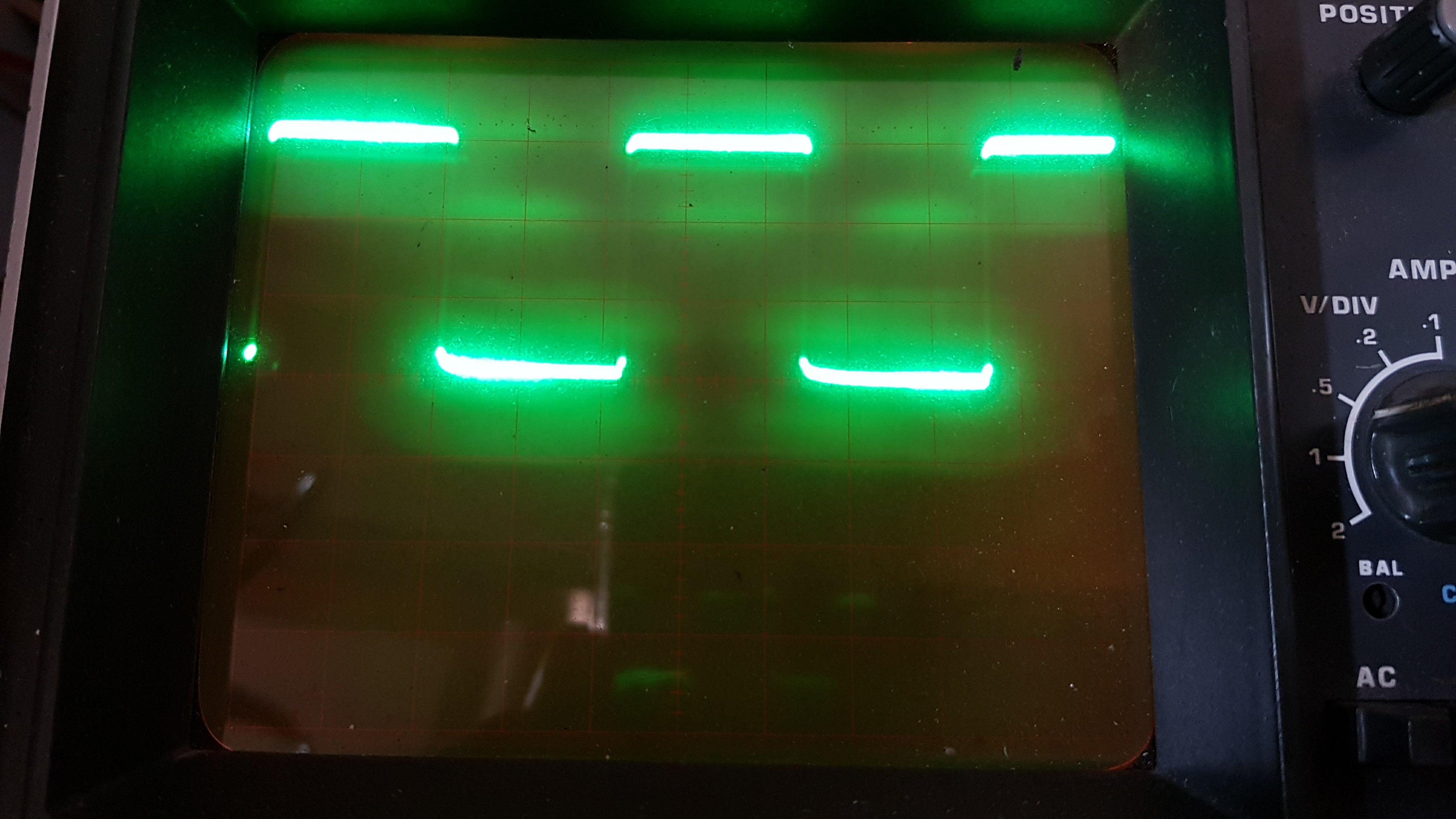

With the ch2 probe on the same point (low-side source pad), probe the -vccs on the driver board, what sort of signal do you see. Set both channels to 1v.
In differential mode and both channels to 1v, a straight line -4v below middle reference line
Are the two shunt resistors within tolerance?
You should read essentially 0 ohms between the -vccs and the source pad of the low-side FETs.
