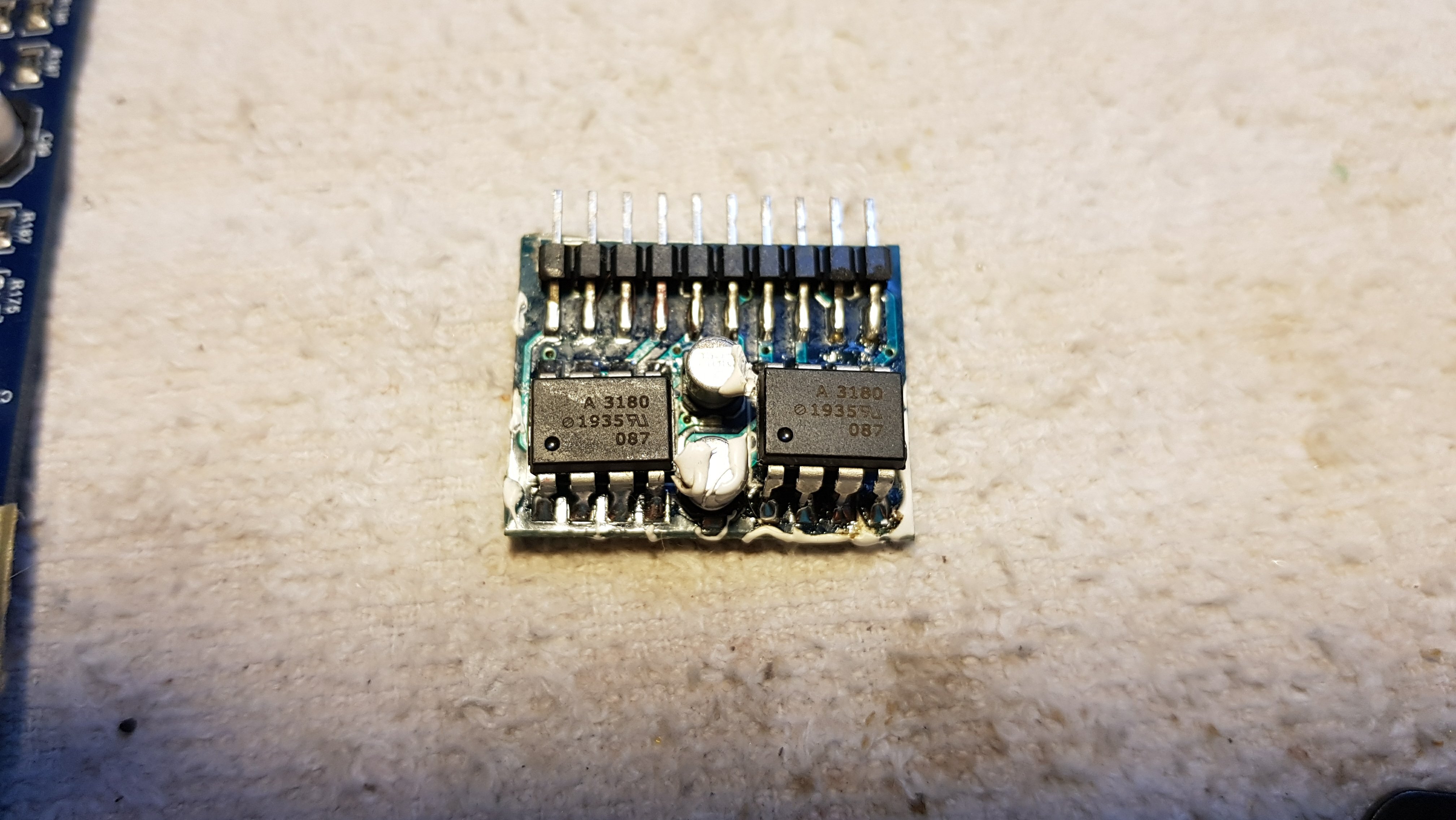

Hi there guys,
Got an Audison SR1Dk which outputs no High-side gate drive.
The driver boards has a very clean input and a very clean low-side output drive wave, but absolutely no High-side output wave.
I changed both HCPL3180 optocouplers, changed the LM219 comparator, changed the SMBTA92 (2D transistor) and checked every single resistor on the board. Everything is original RS-online material.
Anybody got an idea?

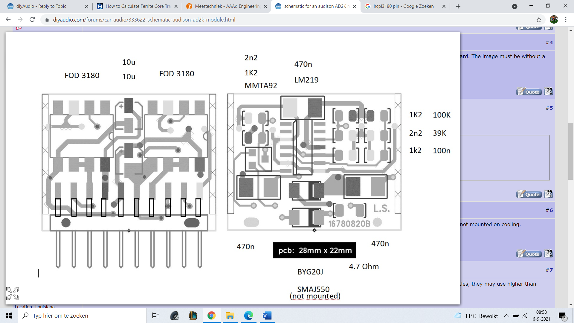

Please use circuit board designations of the components you're referring to. What is the circuit board designation of the optocoupler you're referring to?
The optocouplers are not present on the schematics. The driver board schematics are not included.
The High-Side optocoupler is present on the AD2K driver board.
In the beginning of this post is a photo from the driver board. The HCPL3180 IC on the right side is the one i'm reffering to.
Attached is the schematics from the driver board which I got from another DIYaudio post.
In this photo, the left HCPL3180 is the one i'm reffering to.
Yes, VB is directly connected to HCPL3180 Pin8.
HCPL3180 should have 15V between Pin5 and Pin8.
Is it correct to say that the HCPL3180 can't have the correct 15v voltage between Pin5 and Pin8 when the output fets are not installed?
