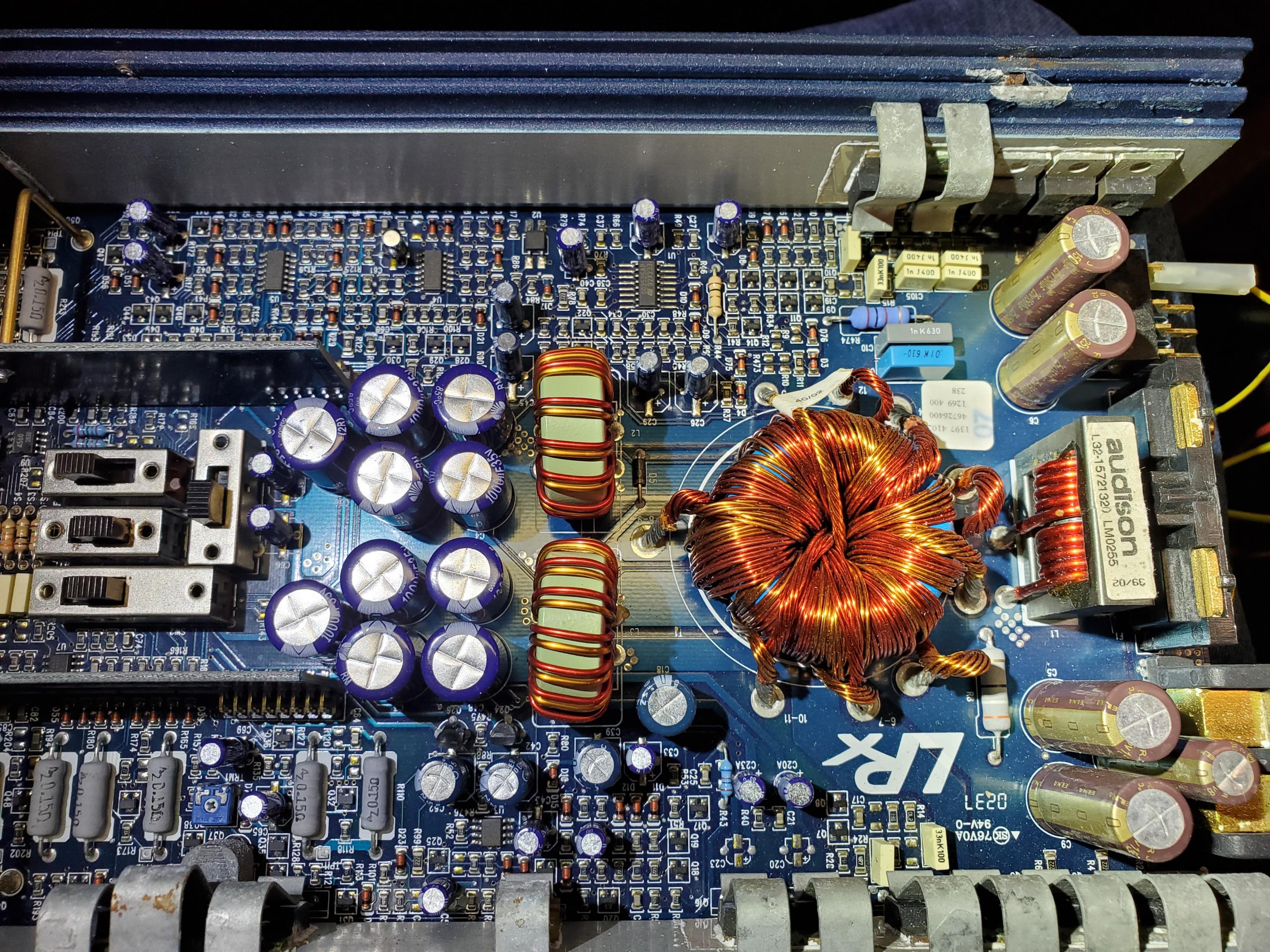

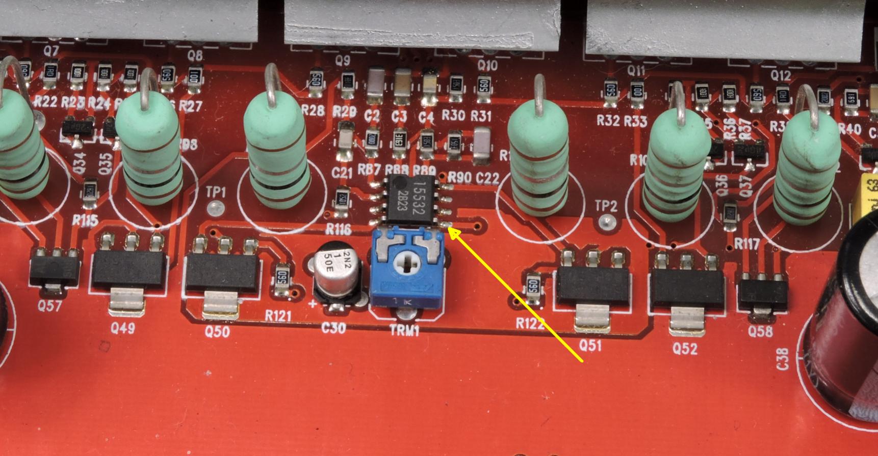

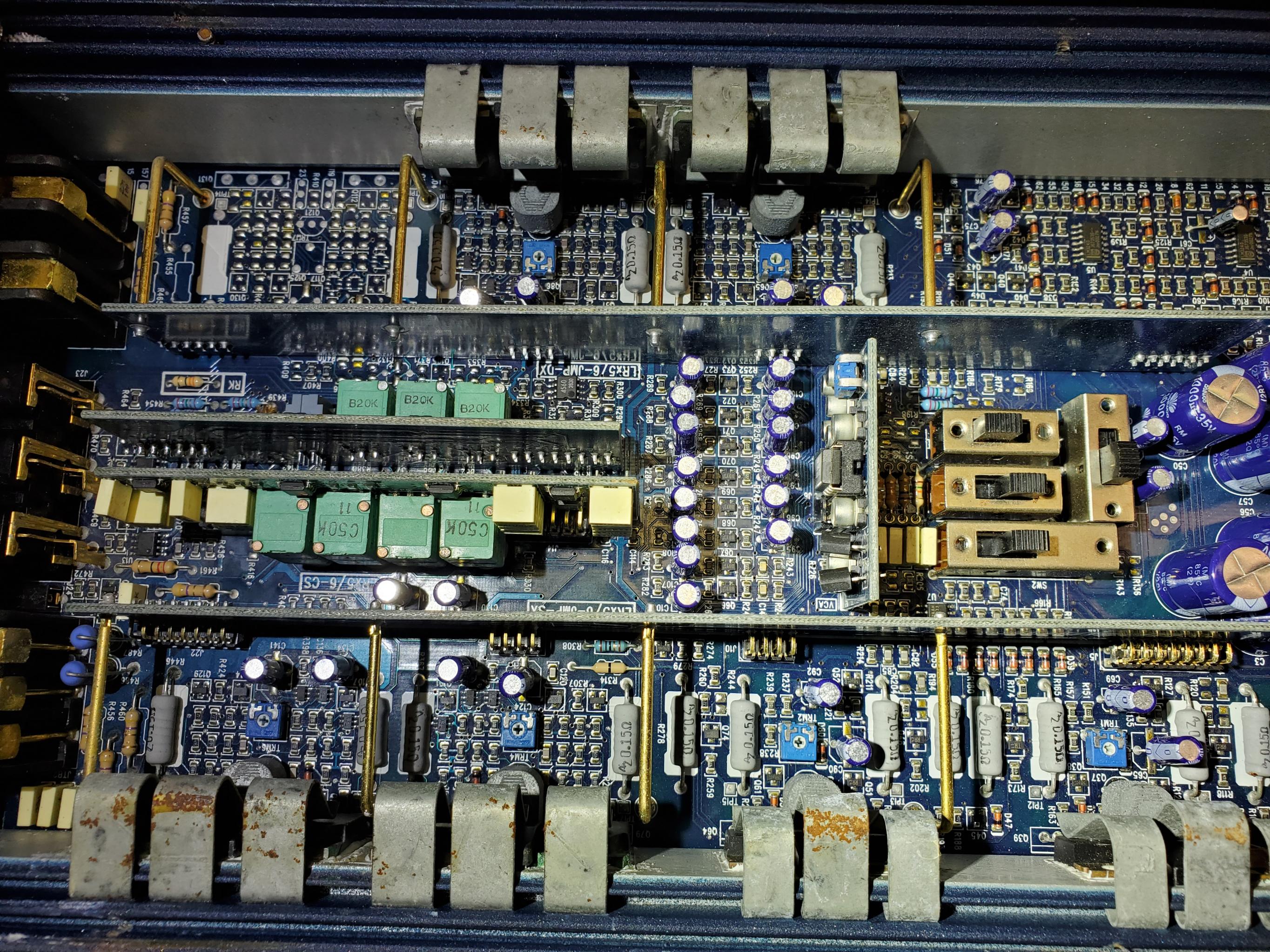

Yes I did but iam still confused because I dont see any 8 pin chips near the pots. Sorry if i spoke wrong I was just trying to be proactive.
Perry,

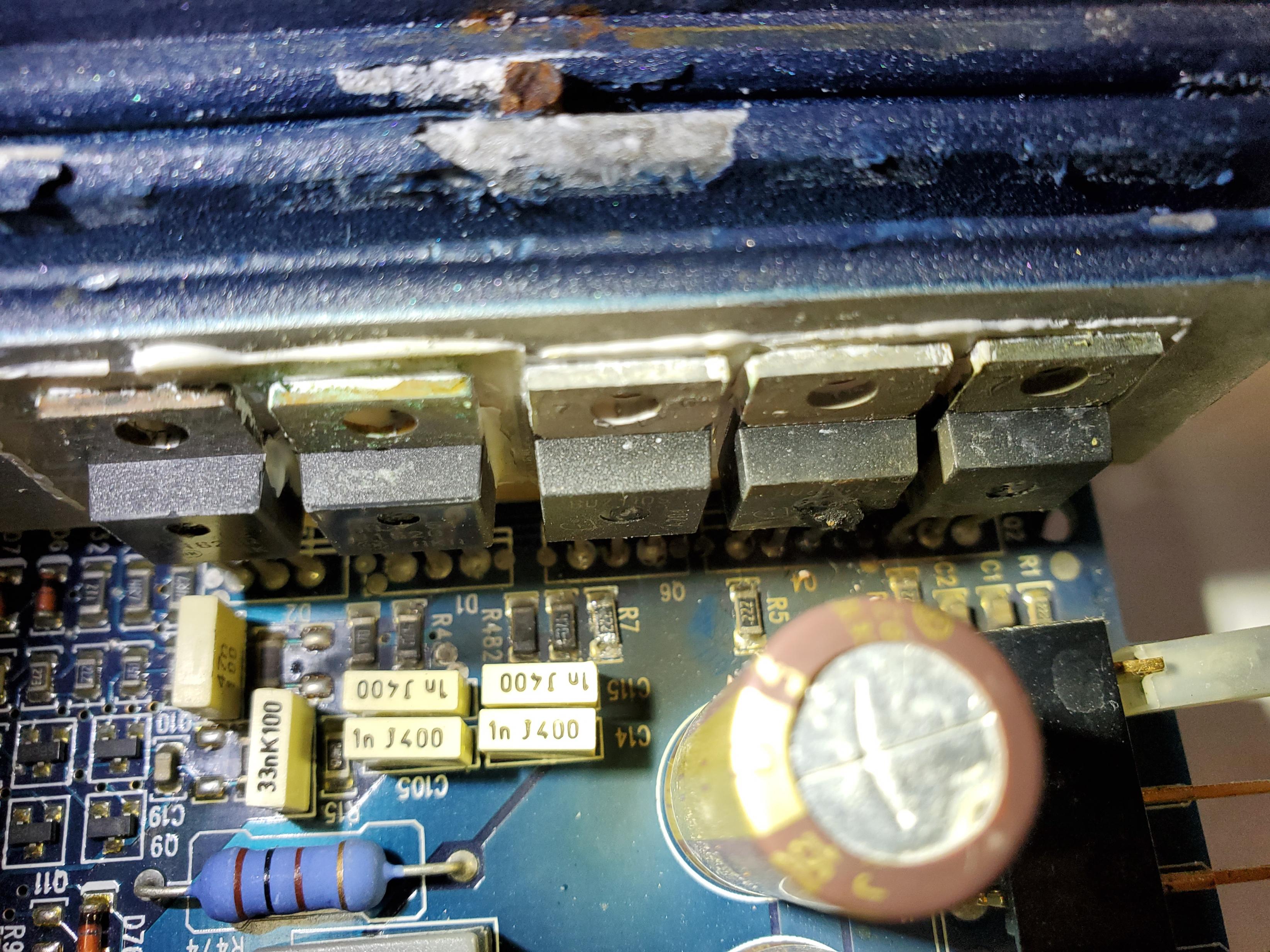

Sorry I was a little confused and I was looking for something that I was unsure about. Here is a picture around one of the pots.

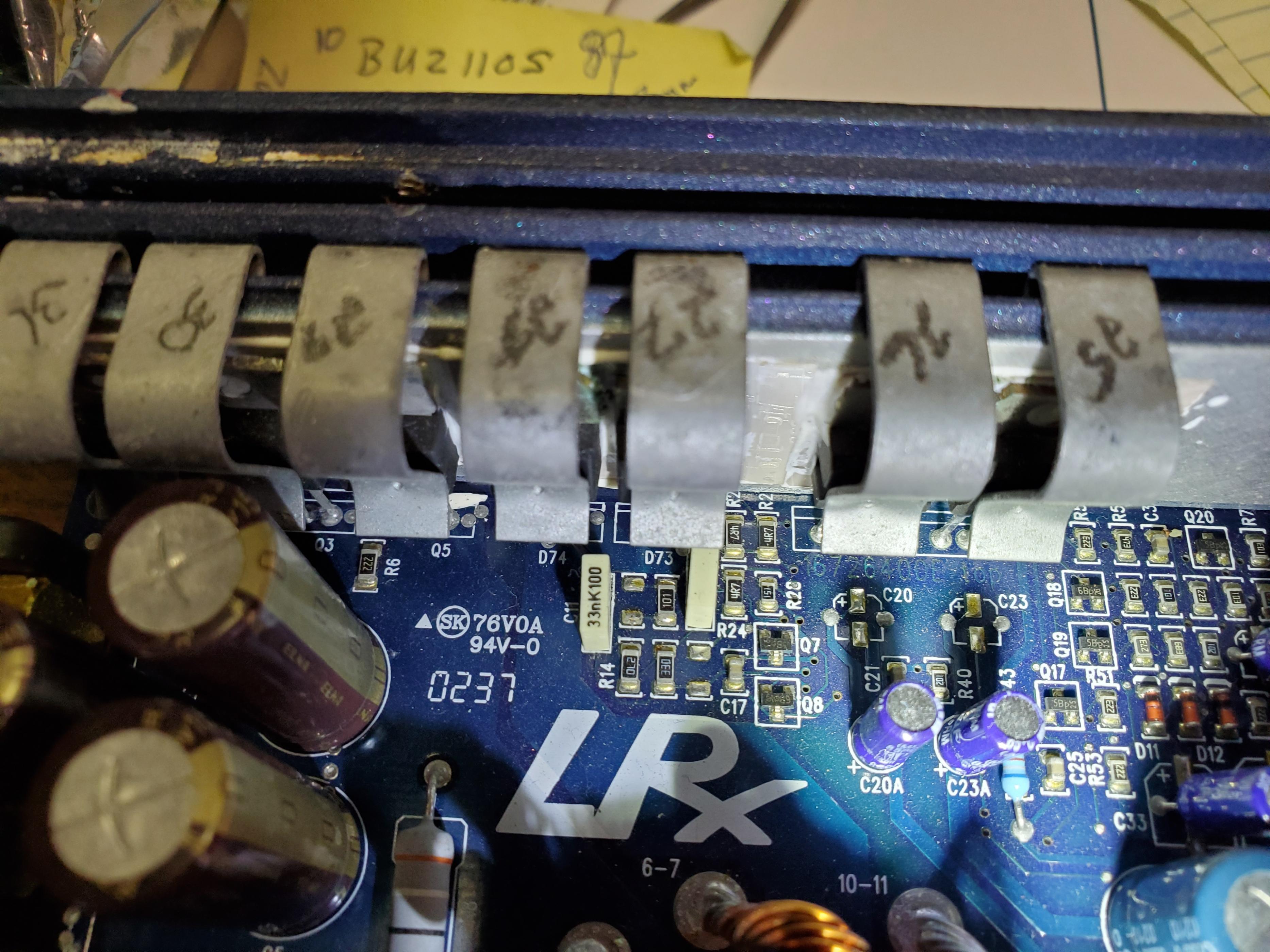

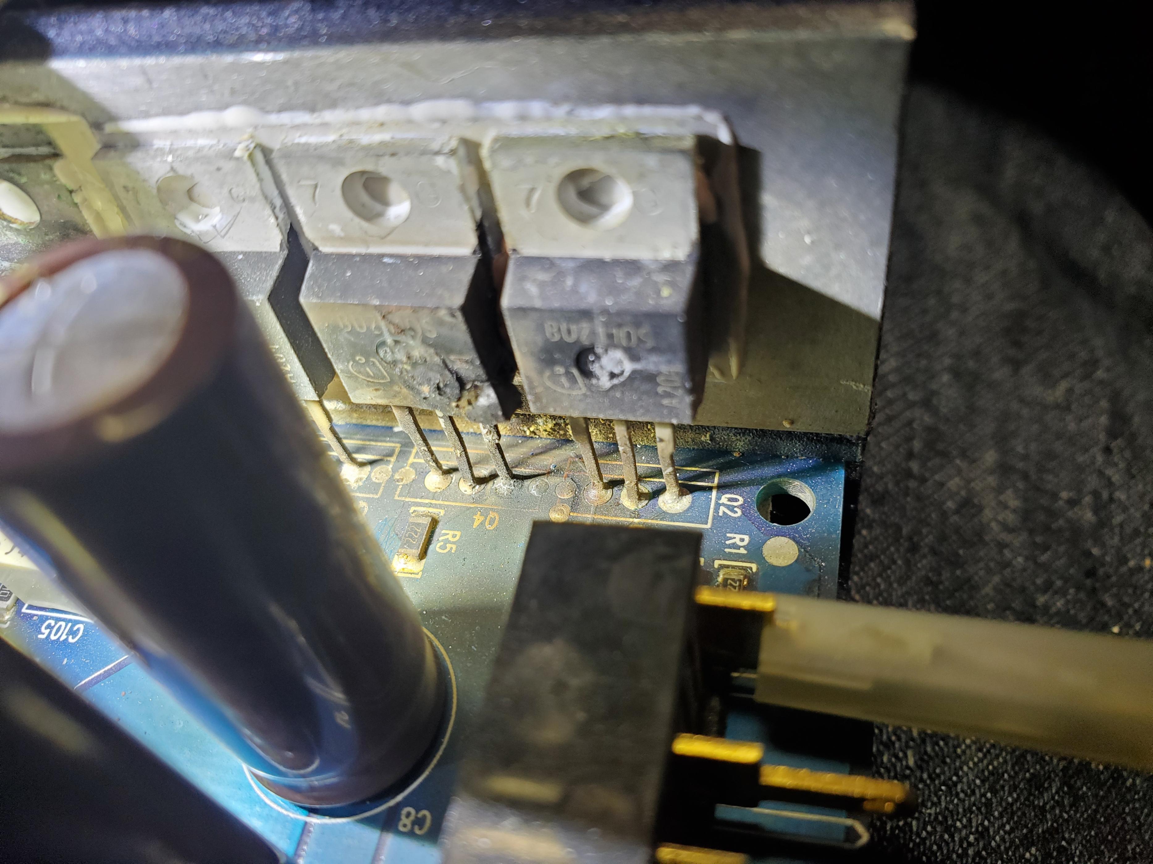

Also after removing some of the heat sinks I found one of the power FET's to be blown. I measure all the center pins and have the 13.24vdc
Without a wider photo or a description of how they're being used in the circuit, I can't offer any more advice than to replace the blown FETs.
You removed the spring clips that hold the semiconductors tight against the heatsink. The heatsink is the large massive piece of aluminum that soaks up the heat from the semiconductors.
It appears that they are the PS FETs. If the PS is blown, you're not likely to have many voltages present in the amp. That's why I asked about rail voltage earlier.
The gate resistors and the driver transistors may have been damaged as well.
Iam looking to replace the power transistors to try to power the amp up for further testing. They are BUZ110S I belive this is the datasheet:

Iam having trouble finding replacements. Is there any part number that these can be changed over to?
BUZ110S pdf, BUZ110S description, BUZ110S datasheets, BUZ110S view ::: ALLDATASHEET :::
Here is a link to a cross-reference source
MOSFET Cross-reference Search | Equivalent Transistors
It shows you may be able to use the IRFZ4410Z which is available through Mouser.

The IFR3205 should be a good sub. Use 47 ohm gate resistors.

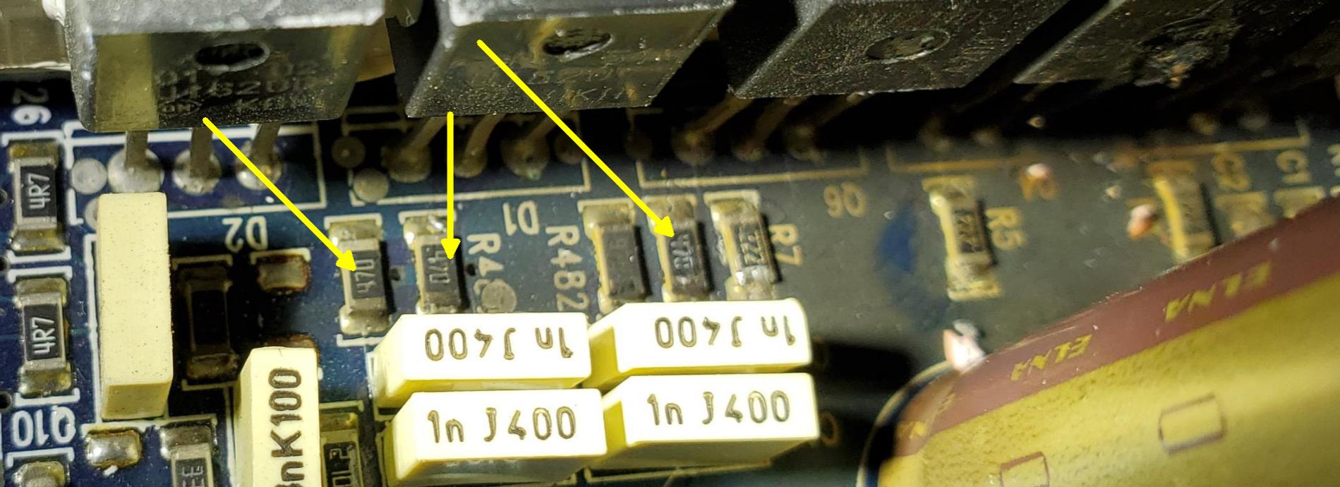

It looks like the resistors off the gates have 222 on the top of them. Am I looking at the wrong ones? I thought they were R2,R3,R4,R5,R6
Bear in mind that I have no information on this amp except what you provide. Good quality, high resolution images would help reduce guesswork.
The 2.2k are likely pulldown resistors.
The gate resistors will be much lower in value.
I suggested 47 ohm. If the original gate resistors are OK and 47 ohms or below, you can leave them.

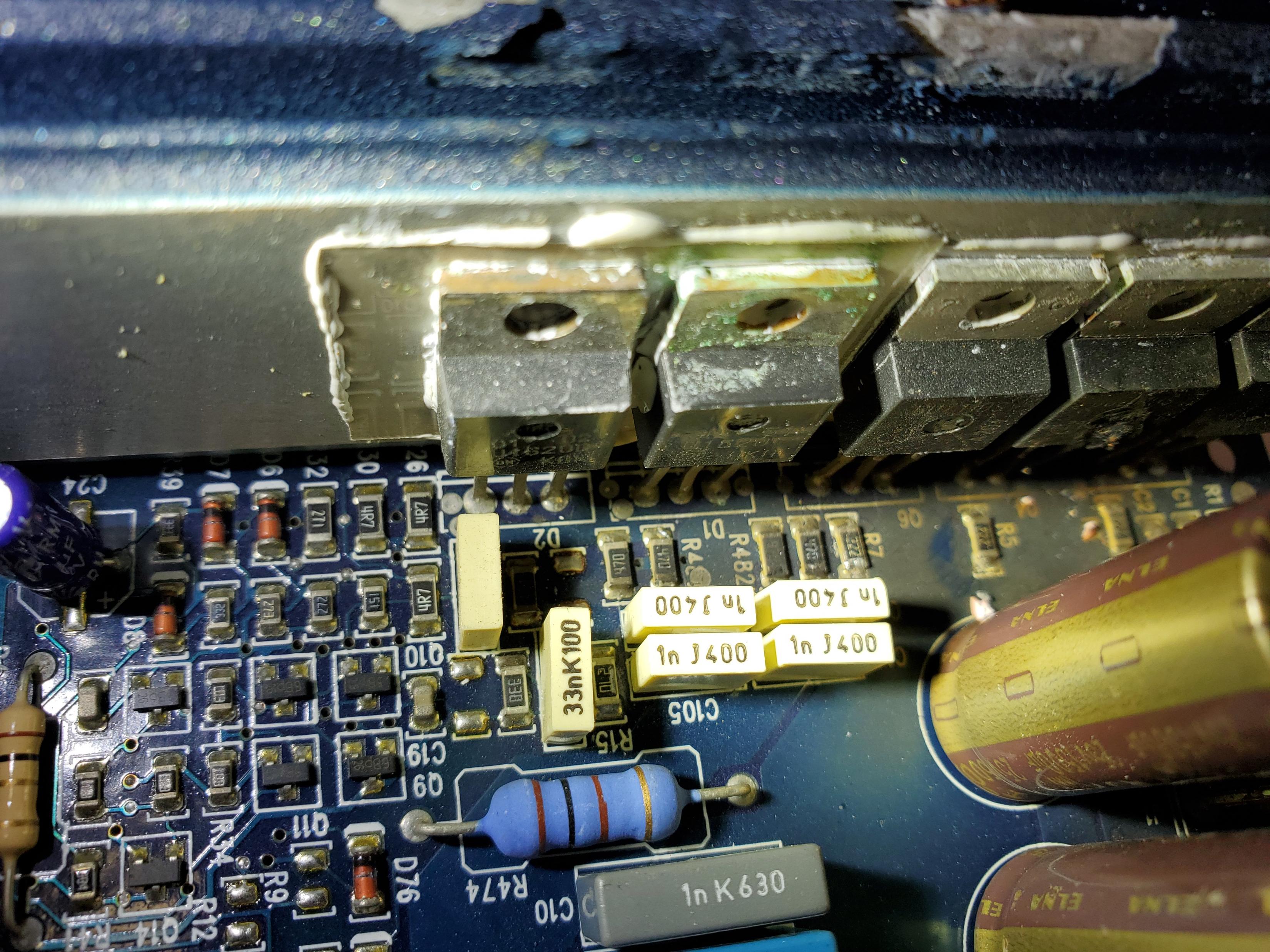

Here are some more pictures. I will take some better ones when I pull the board from the case.
The two left-most TO-220 packages are rectifiers. I think the "222" resistors are for the gates of the 3 FETs to the right of the rectifiers.
It makes no sense for there to be 47 ohm resistors there if they are not used for the gates. 2.2k resistors are too high of a value for gate resistors unless there is a LOT of deadtime or parallel diodes for pulldown.
Should there be 6 gate resistors? 3 on each side? I want to look for them on the opposite side. I cant get the caliper on the 47ohm but the 2.2k are .060in. what would the wattage be?
