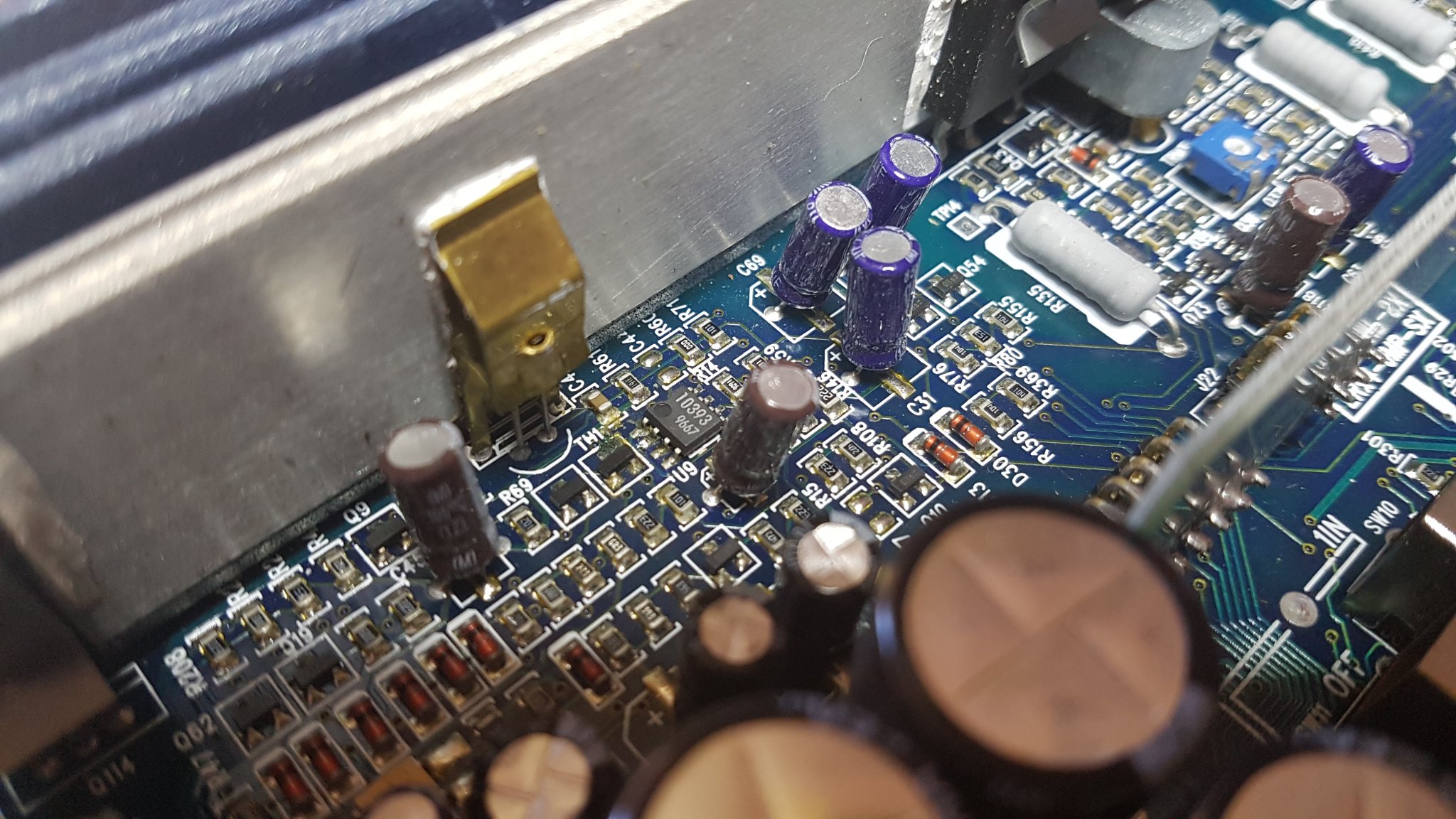

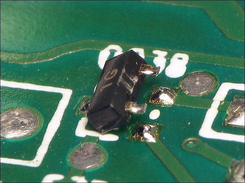

There was moisture on the collector of transistor Q23, also on pins 1 and 2 of the comparator, I removed the moisture, the pad under the collector fell off the PCB, but I soldered it higher (enlarge photo), I checked the transitions between the elements and I did not see anything suspicious. That's why my post on the forum, because I don't know what to do next - I'm out of ideas. 🙁

The 10393 is likely defective. The voltage divider should have pins 3 and 6 at 1/2 of the 3525 pin 16 voltage.
Confirm that the voltage on the anode of D25 is lower than the voltage on its cathode to confirm that nothing is driving voltage through the diode to the voltage divider.

I will replace the BA10393 and let me know if anything has changed.
I did this before picking up Q23 and removing D25. Current consumption increased 10X - 0.430A. SG2525AP heats up to 40 degrees Celsius (I think it works), but I forgot to check if the PWM signal is generated. The power supply mosfets are slowly warming up, but the "safe" mode is still active and I didn't drill down further. With Q23 and D25 removed, it is as it was before their removal, if I remember correctly.
