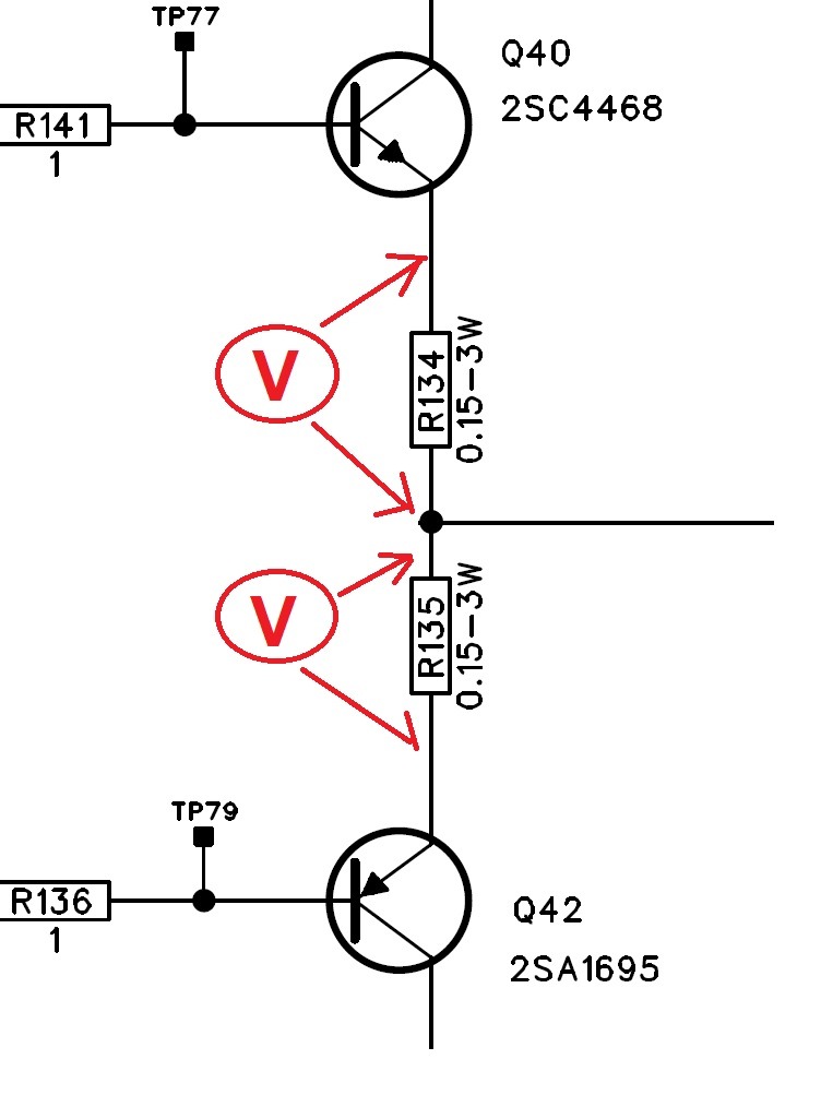

This is one channel ...
Check voltage across output resistor, because power transistor current must be 0A and ''If you bypass the bias transistor.......there should be no heating'' at all.
The voltage at the output of the emitter resistors is 0V between the AGND.
Do you have a complete LRX 4.300 schematic?
I'm searching....
....'across output resistor': i mean not to AGND, check how many mV you have at the ends of power resistor connected to power transistor that heats up
When the power supply starts the amplifier, the voltage starts to increase rapidly and is 55mV when cut at 3.5A.
3mV in a "good" channel.
